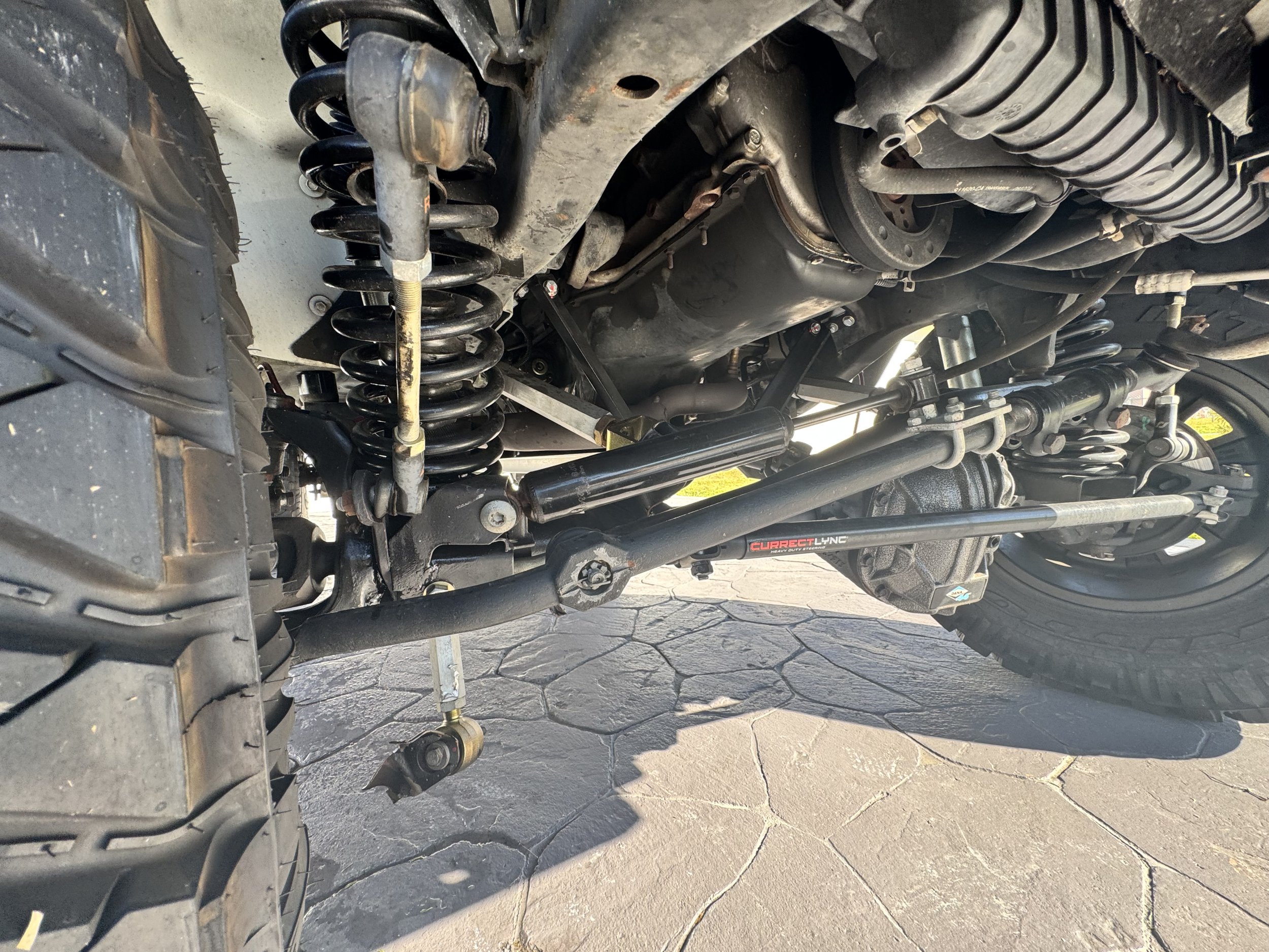

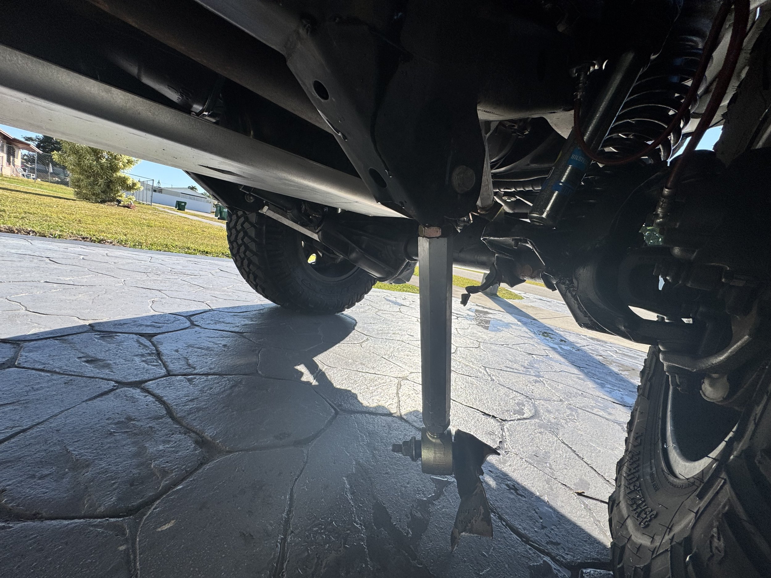

finally got my dream jeep exactly how i wanted it and it now looks like its going to be totaled due to the front axle and frame being bent.
it was a 2004 LJ with 55k original miles and a clean title with no previous accidents. I've never had to go through this with an older car so i would really appreciate any tips from you knowledgeable folks on here before i call the insurance and get offered 2k for an LJ that go for over 15k.
thank you all in advance.
View attachment 664645View attachment 664646View attachment 664648View attachment 664649

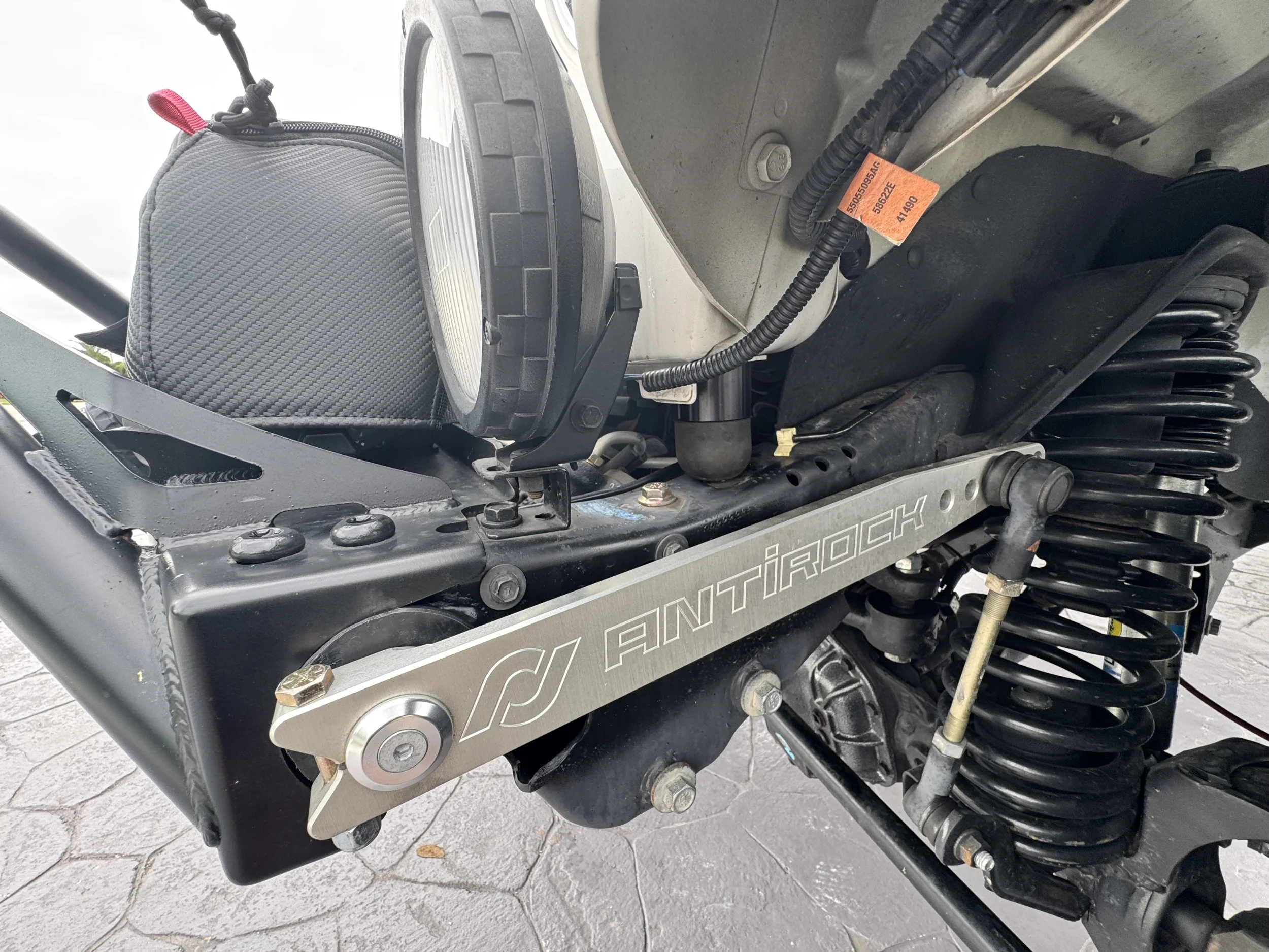

What makes you think the frame is bent though? The brackets shearing off are no problem. Make sure the axle isn't bent and weld new ones on. Nice looking LJ!
just want to say if i have read every single response and i really appreciate all the advice that was given. the control arm brackets and front axle are definitely damaged and body mounts are slighly tweaked forward.

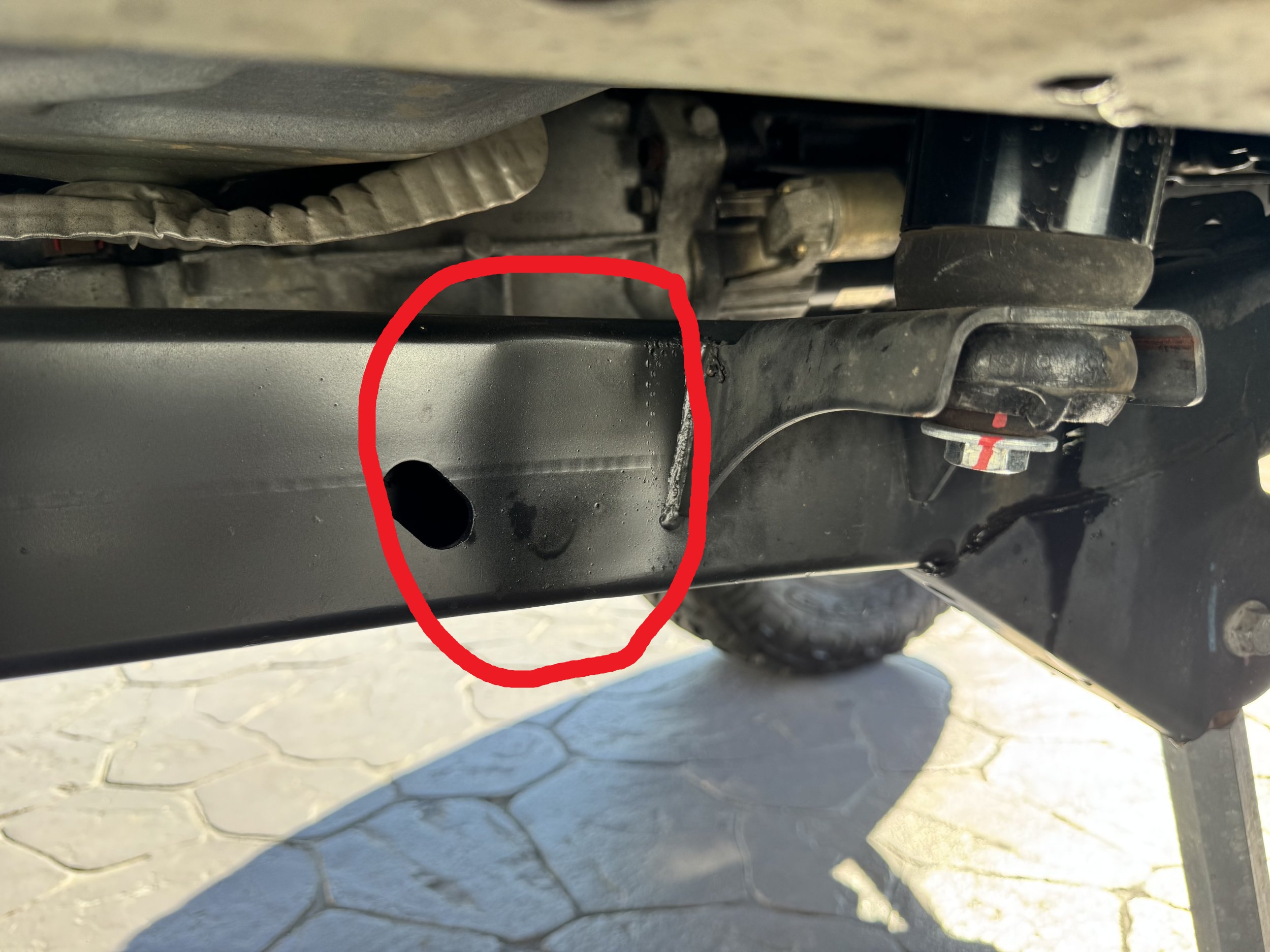

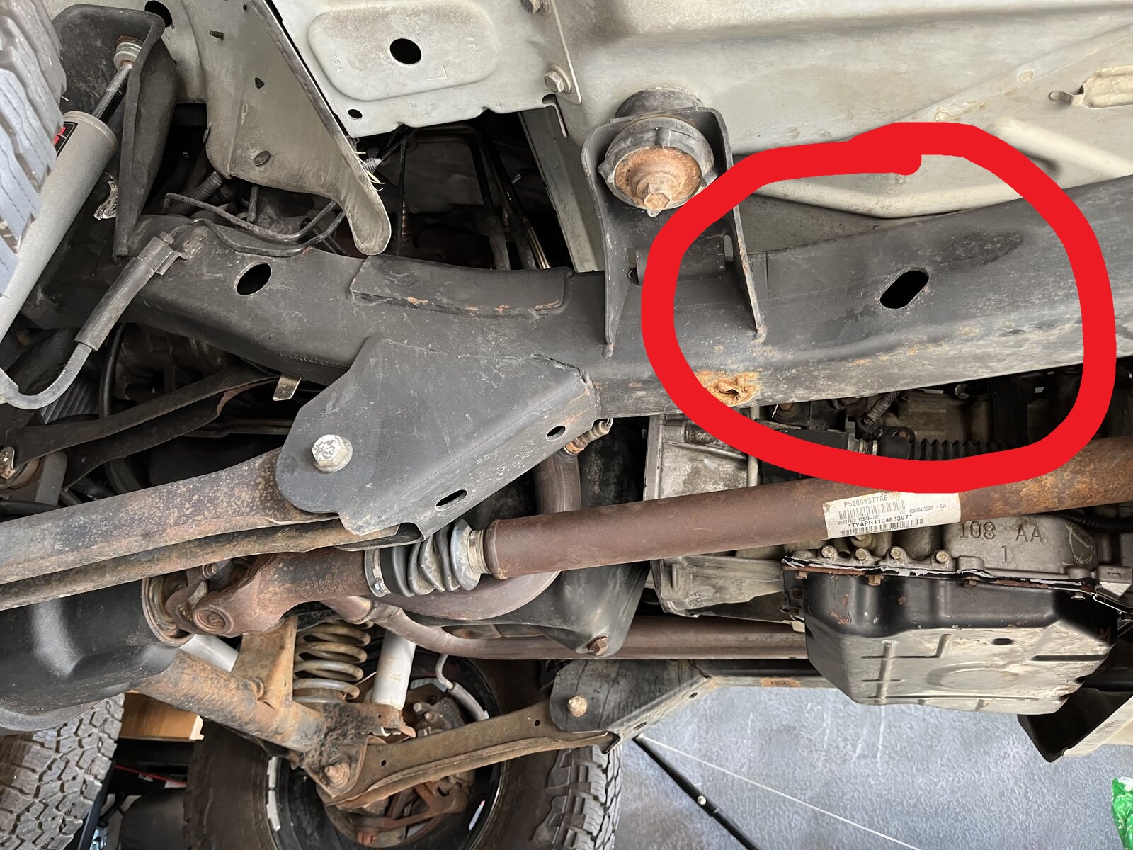

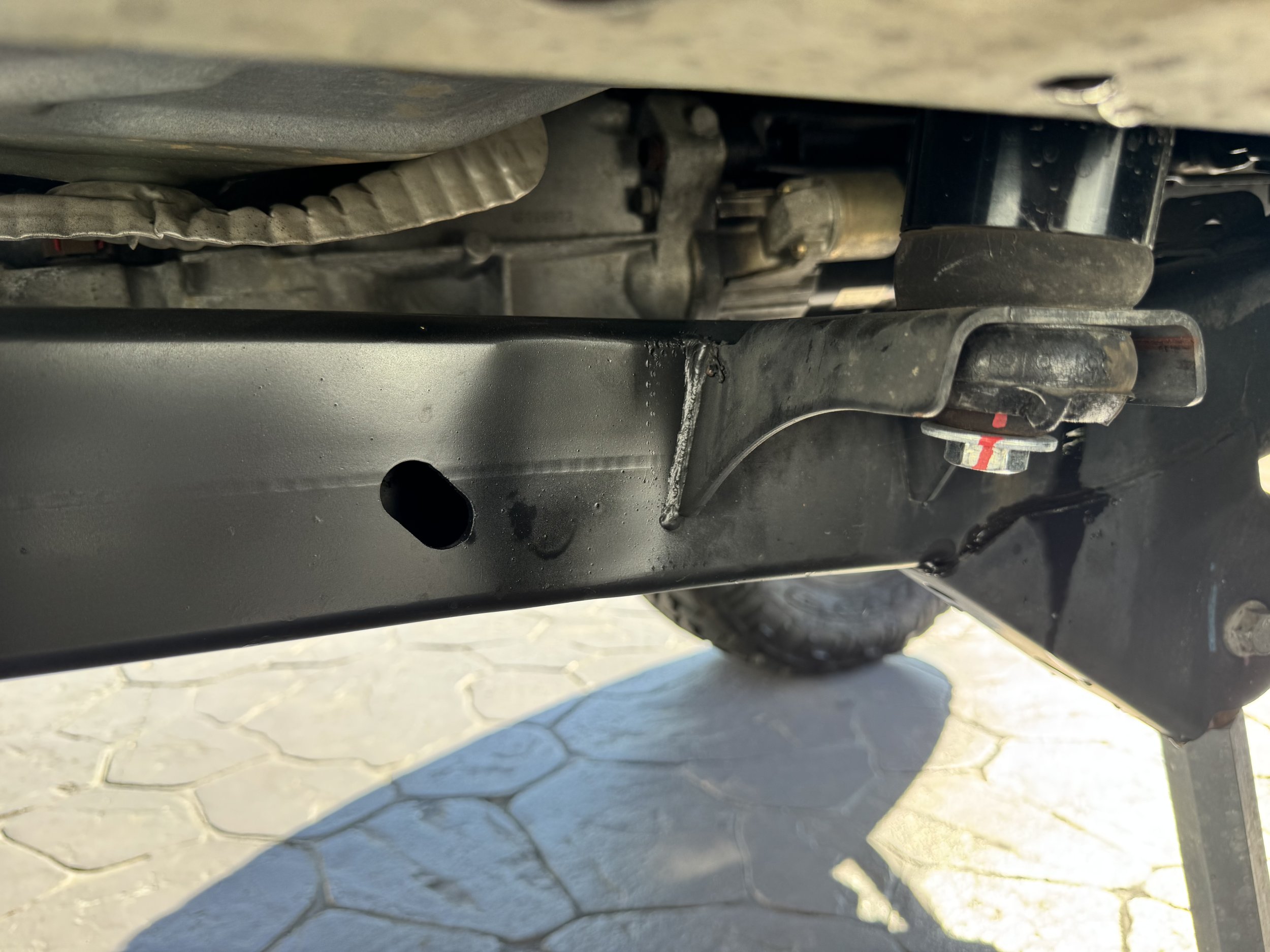

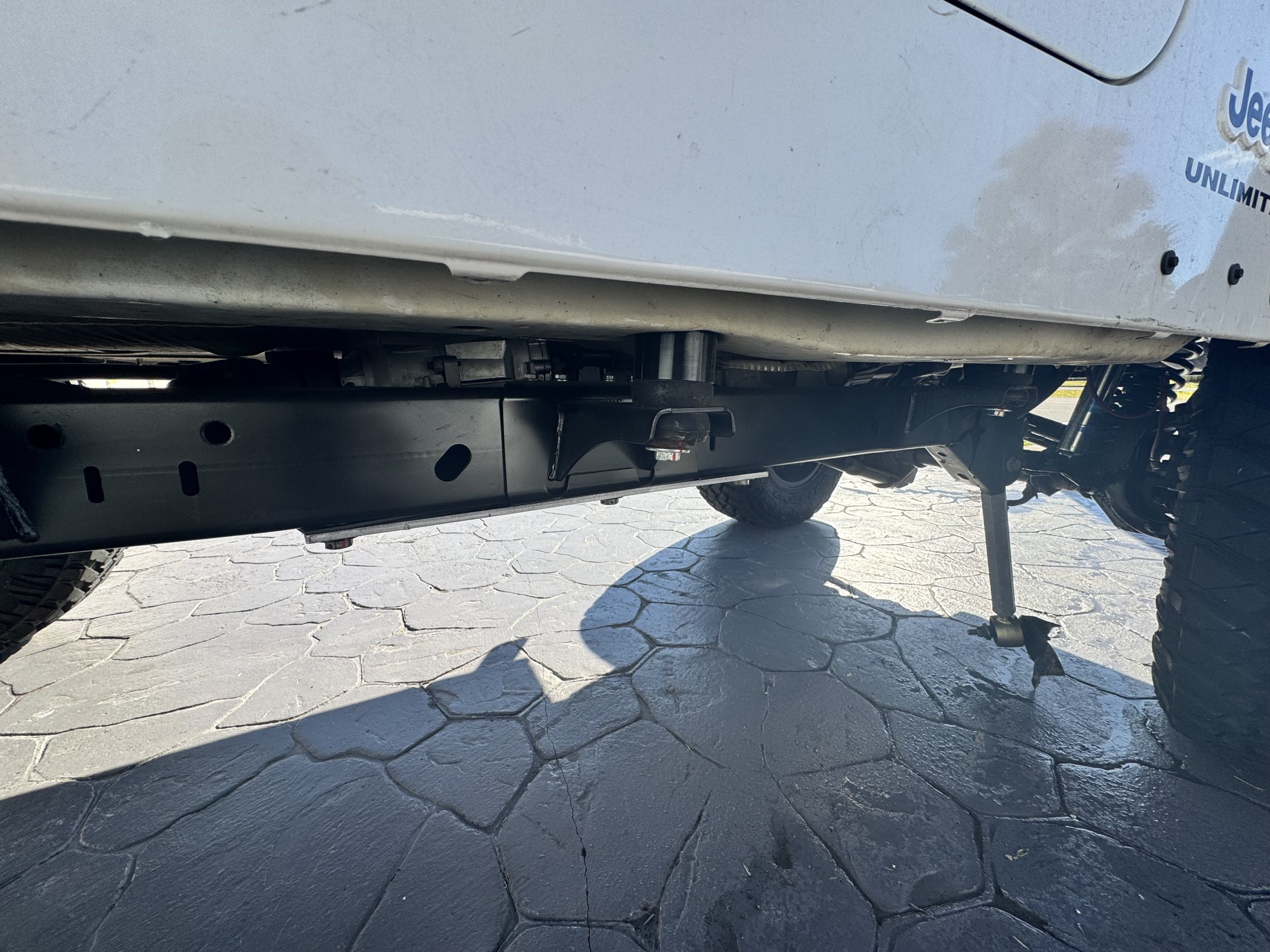

i initially thought the frame was bent from this dent i have on both sides in the exact same spot.
my jeep:
but i found this picture of an LJJ frame online and it appears to have the same indentation
i was very upset yesterday and wasn't thinking very clearly, can anyone confirm if they have this indentation on their frame?
my jeep:

I don't have an LJ to verify against exactly, but that is where the frame rails begin to kick out and widen as it moves toward the rear. Its an artifact of the factory bending process. It will also be a weaker spot in the frame where it would be more likely to be bent in an accident. It needs to be measured to verify.

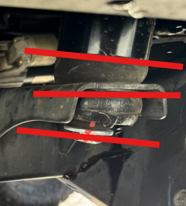

What IS concerning to me is that body mount bolt is not straight anymore....

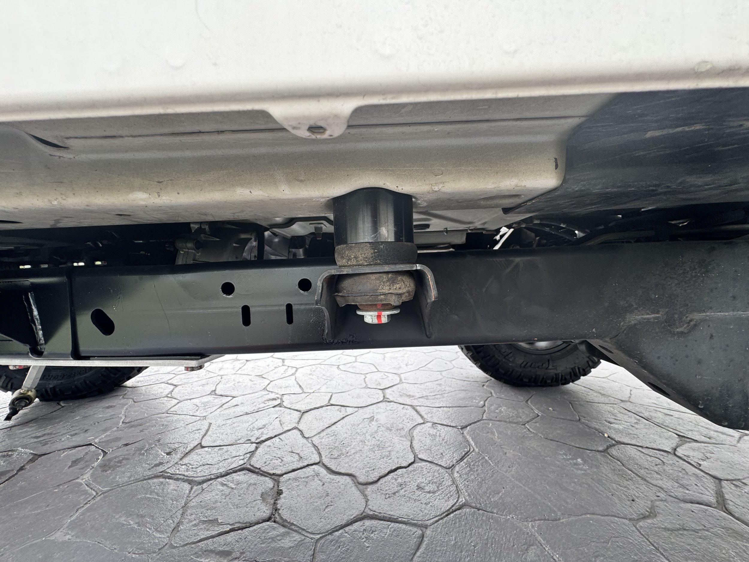

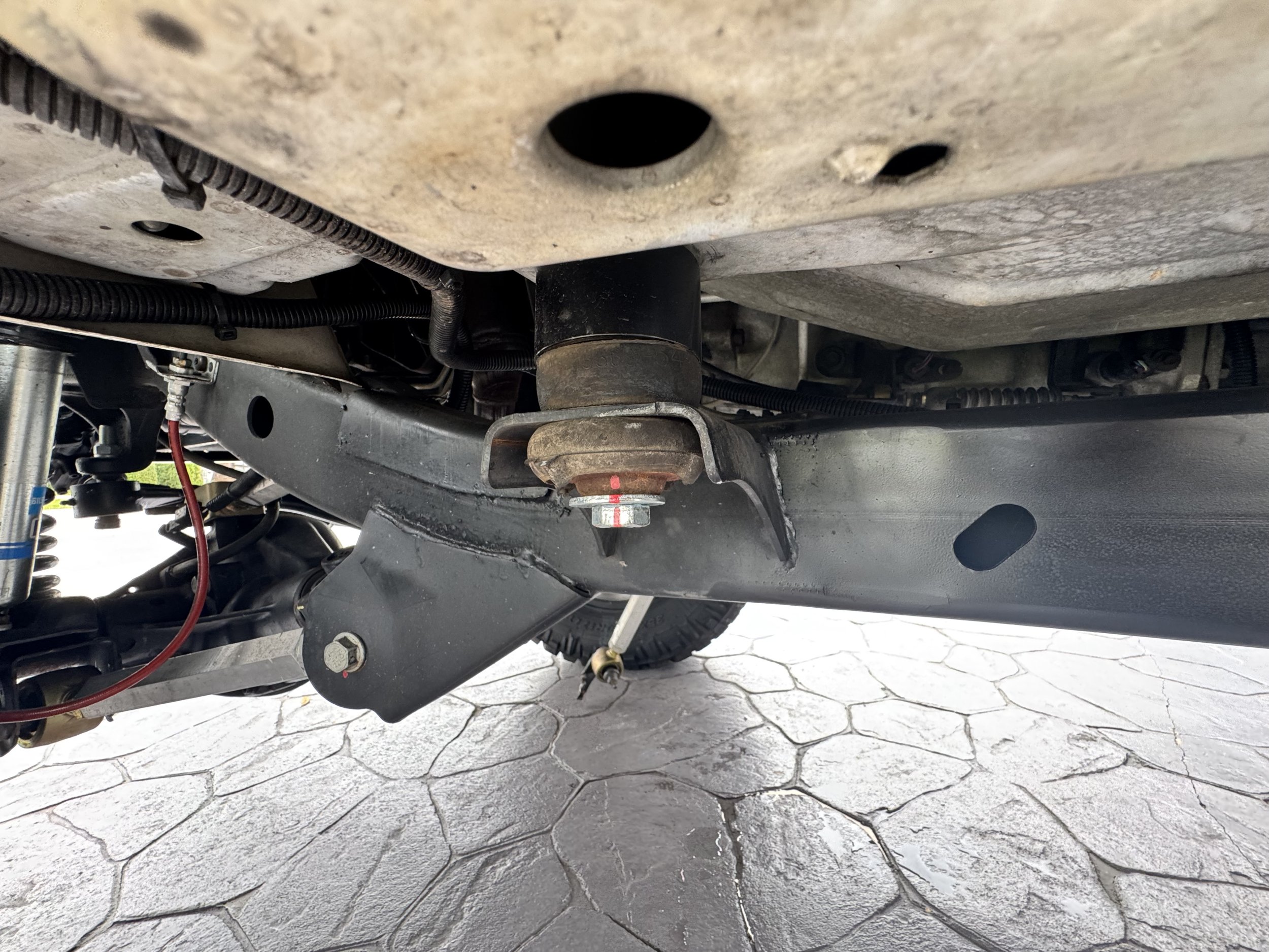

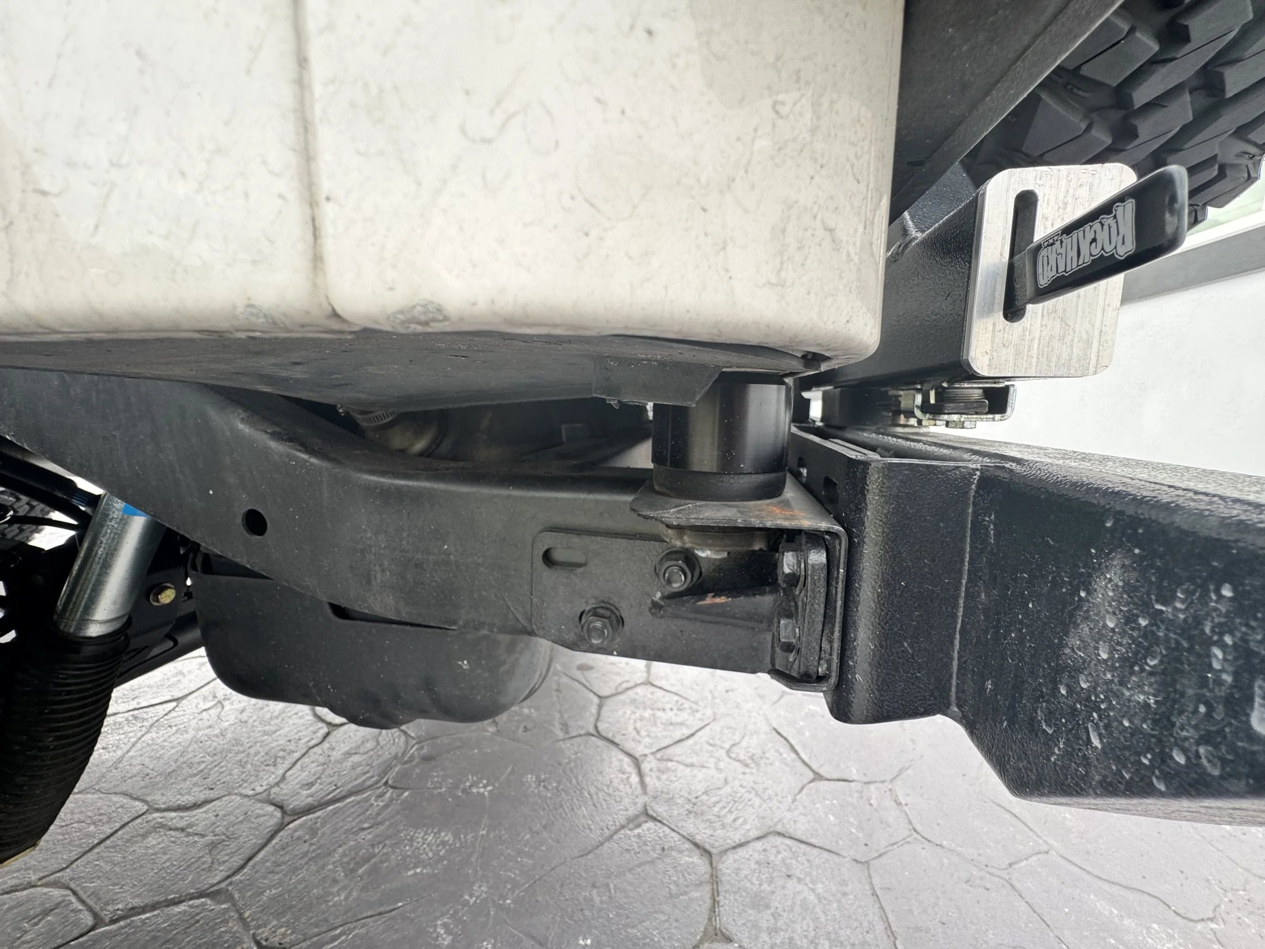

just a quick update for everyone that brings some good news. Frame is NOT bent (thank god) and neither are any of the frame side control arm brackets. the insurance cut me a check for 6k so it'll cover the cost of getting that replaced. i did have the owner of a 4x4 shop come by and take a look at the body mount situation i got going on and he didn't seem too worried about it. hopefully it isn't a huge can of worms when they go to fix it.
if anybody has any insight on what could have gone wrong on the body mounts and the best way to go about fixing it please let me know!

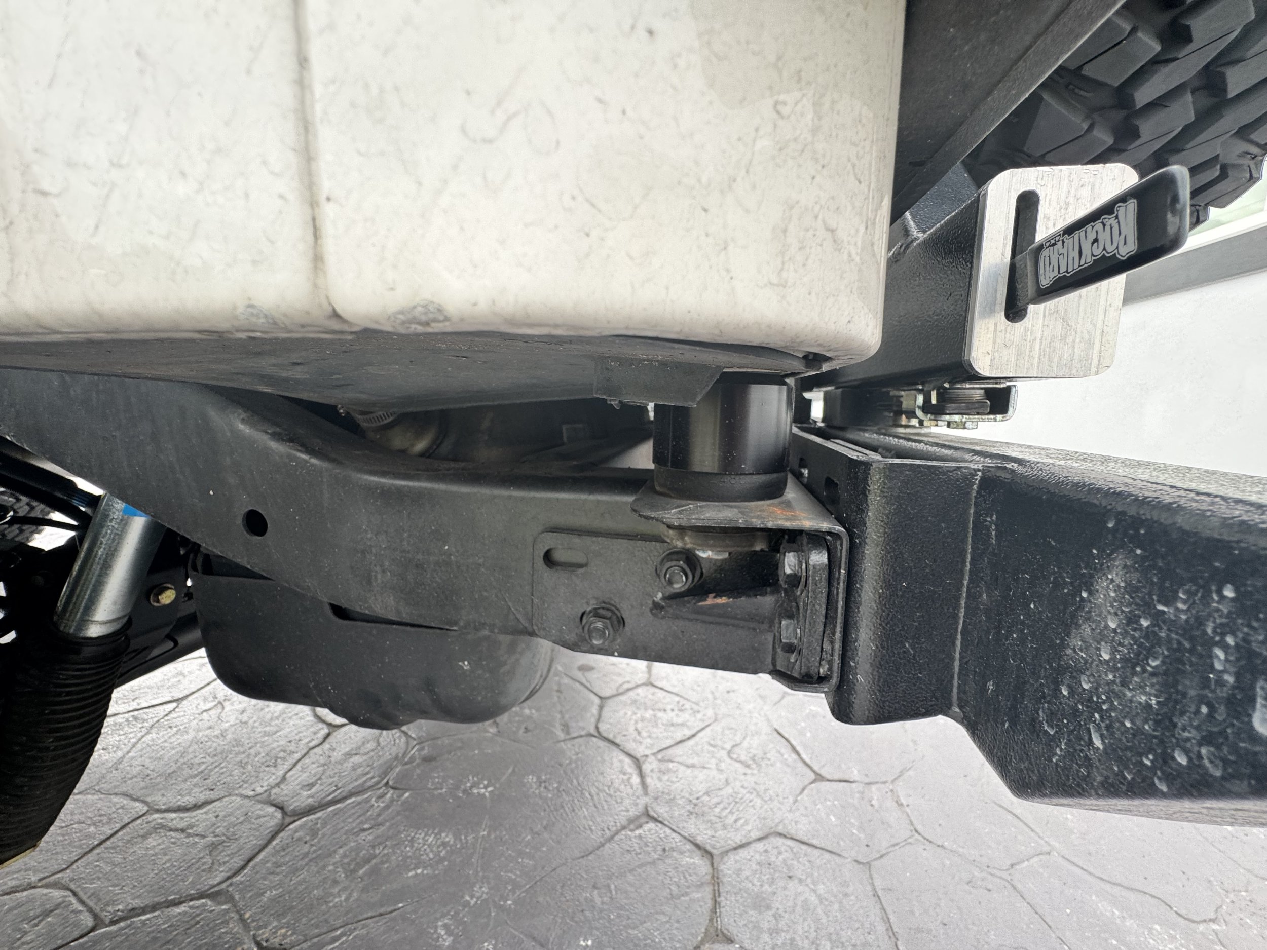

How about more body mount photos. I see the one close up that looks off but the other one in a photo looks straight.

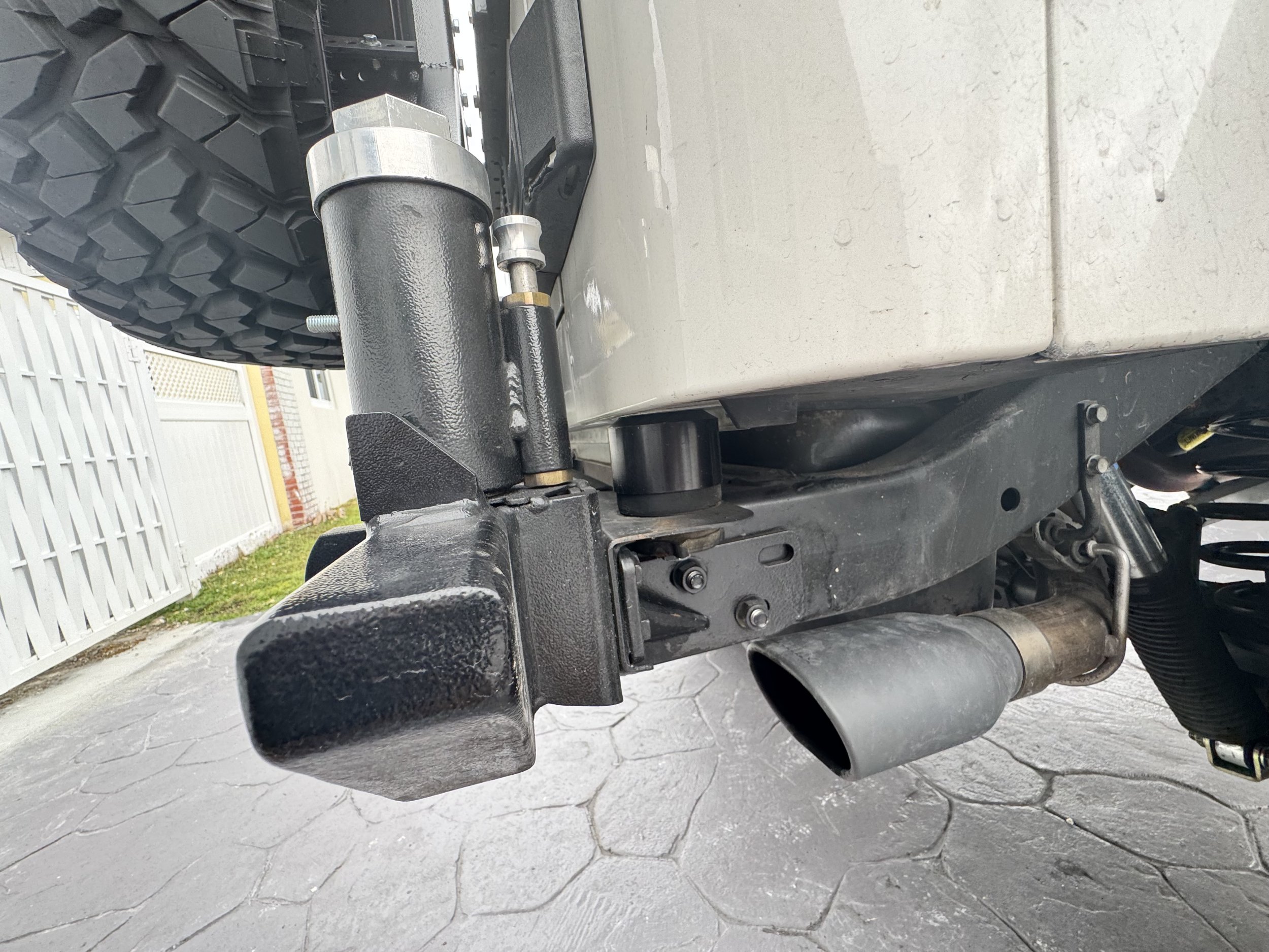

If the bracket and frame are not bent, then I’d loosen most or all of the body mount bolts on the rig, jack up the rear slightly from the rear bumper, and shift the body over to line up the holes. Replace that bolt if damaged.

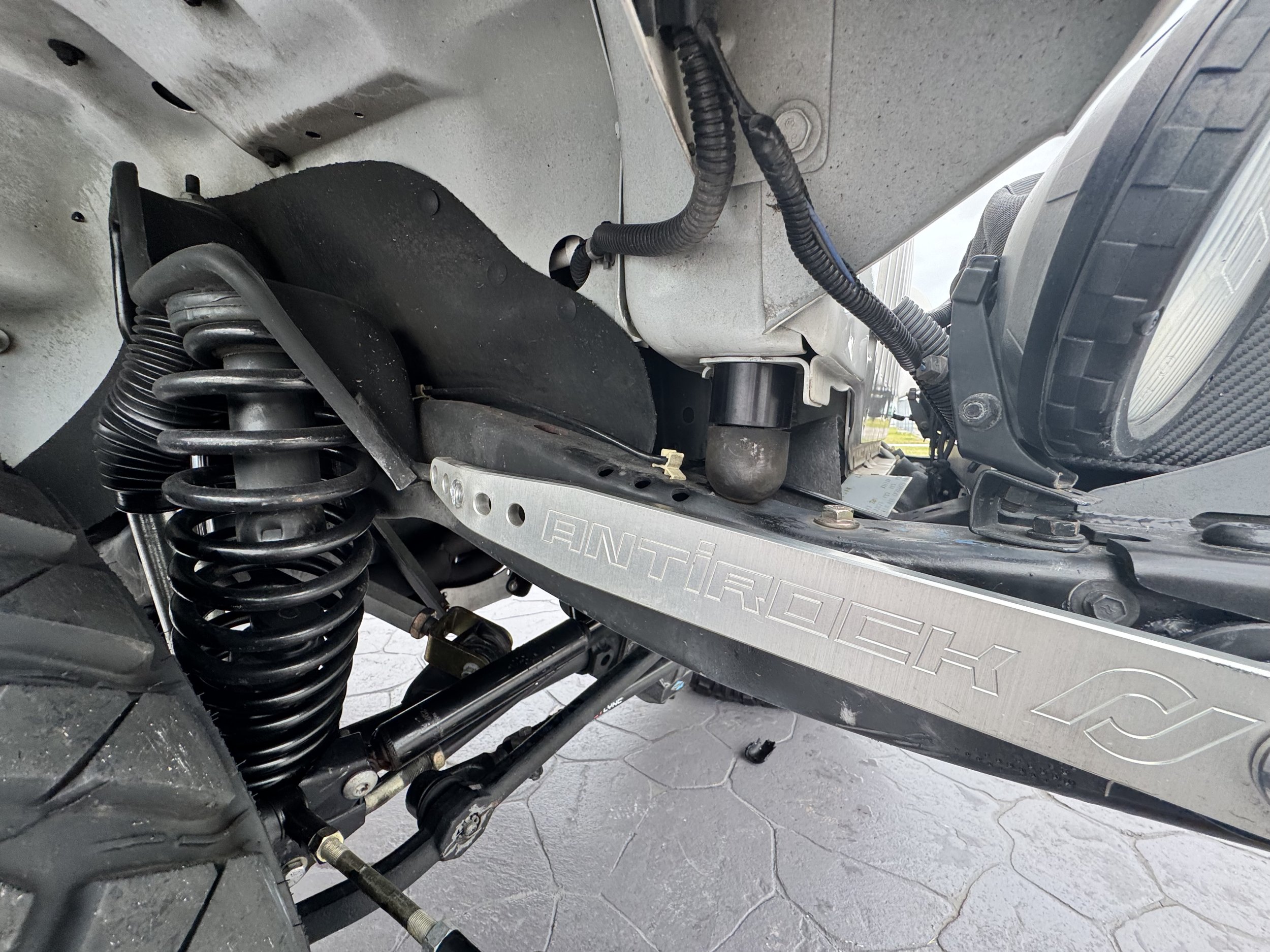

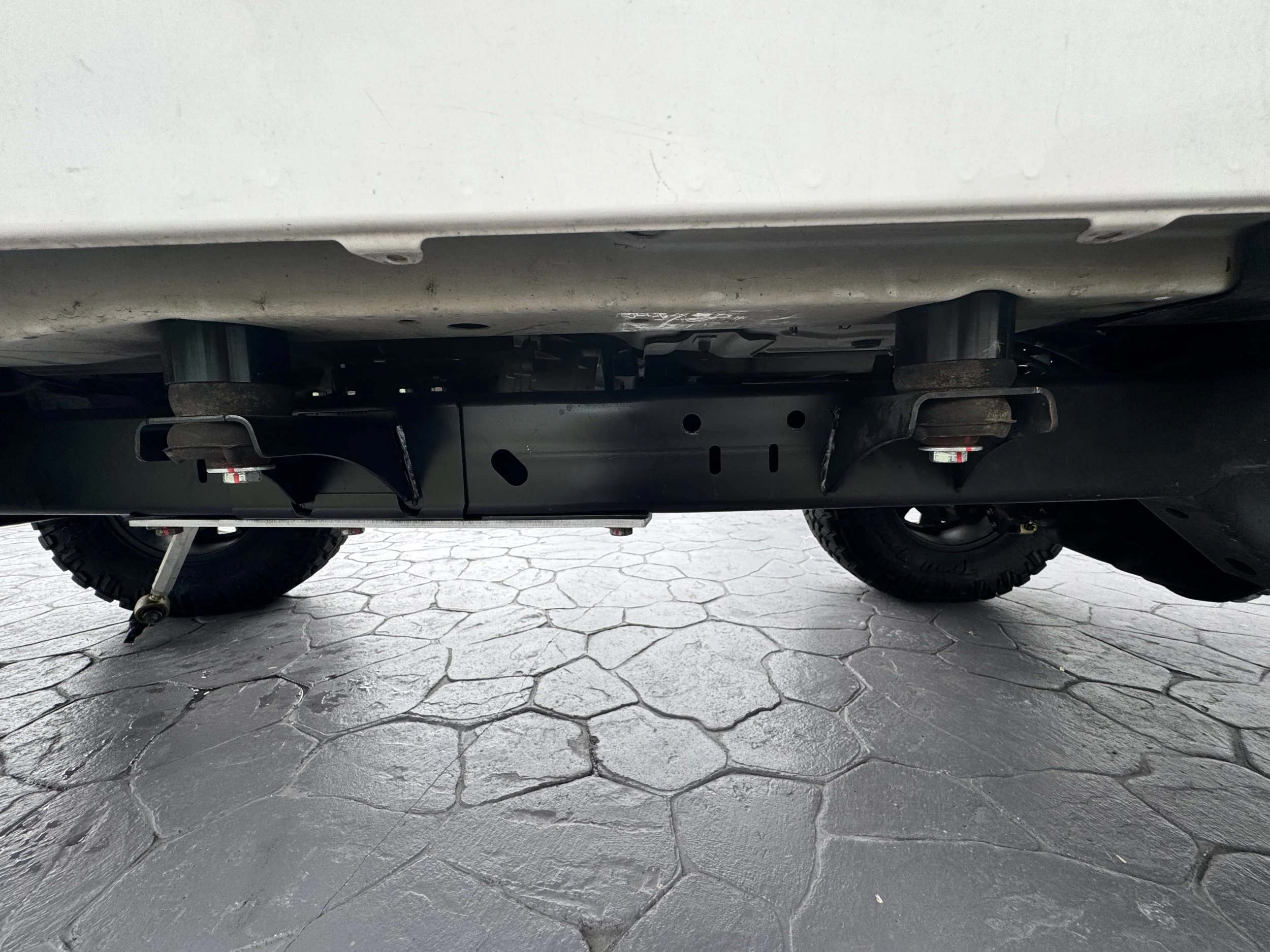

looks to be only the passenger side that are a little misaligned, the rest look okay to me.
Driver Side:
