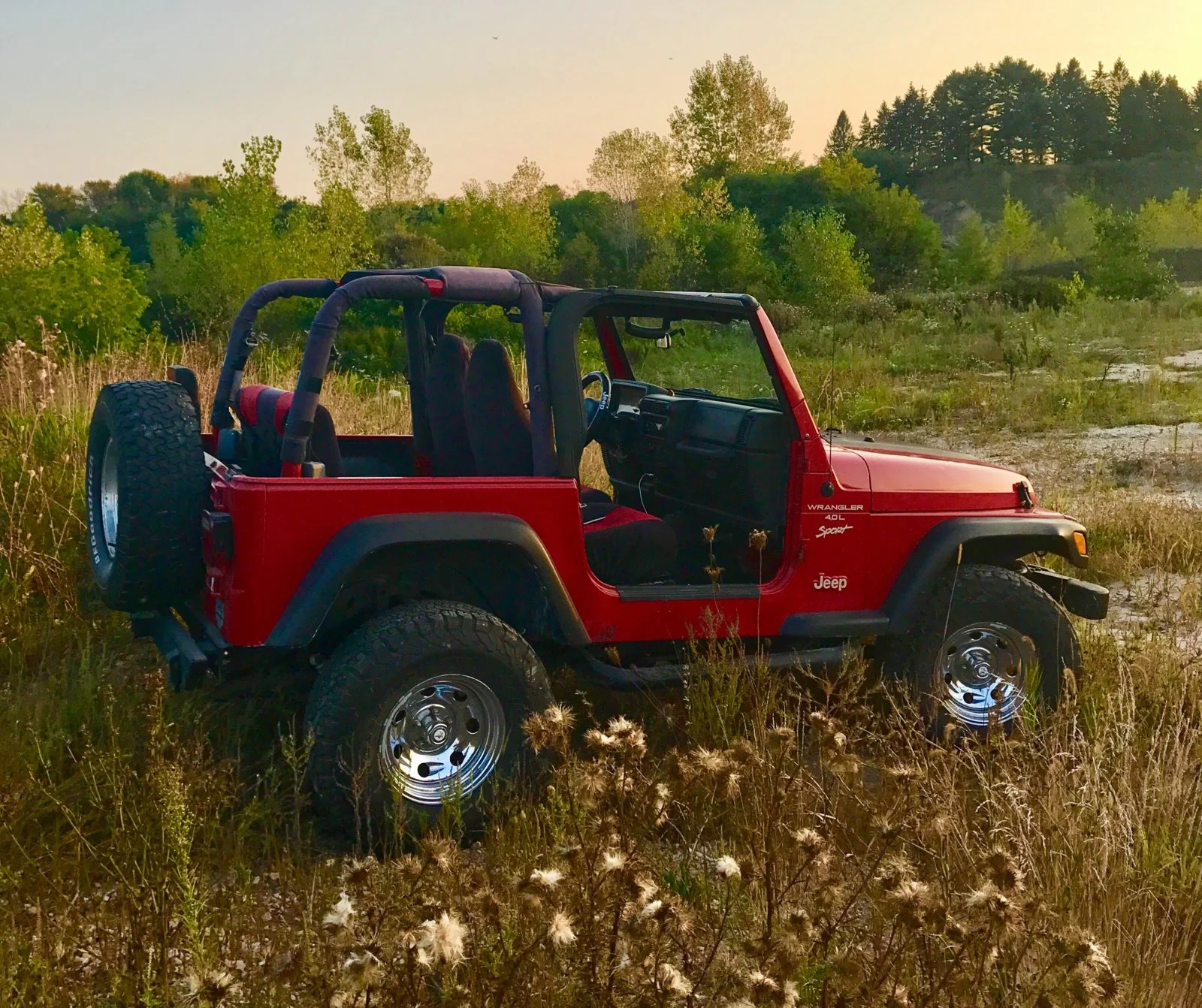

I have the 32 inch ko2s and purchased the jeep with a three inch bb on it. It has been advised not to use a 3 inch bb but I’ve not converted it yet and am not doing any off roading until I change my suspension . with the 32s and the 3.07 gears in my automatic it is doggy a bit but tolerable in my book for now. Here’s what mine looks like

Your Jeep looks great Kathy, I'm running a 4.0 manual, I'm not to worried about the speed of my Jeep as I only really drive on A & B roads in it, altough I don't want my MPG to drop drastically, basically what I'm after is the smallest but biggest looking tyre out there, for mainly road use though
Reactions: Kathy
