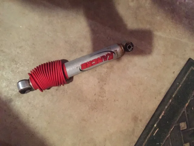

So I just removed steering stabilizer to start and this is what I found. No resistance at all. No more than 8,000 miles on them in the three years they've been on. Exchanging it under warranty. Not sure if this will solve the problem, but it needs to be changed anyway.
