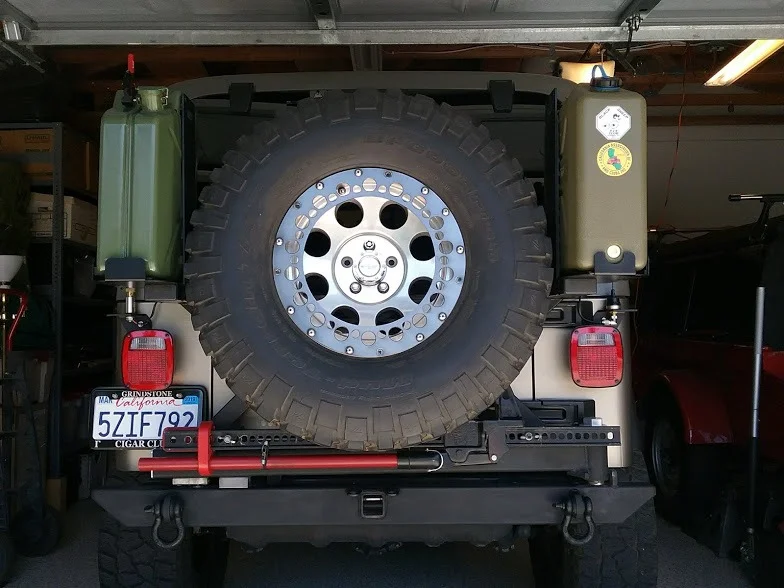

Rock hard 4x4 says the hitch receiver is rated to do whatever the stock receiver is rated to do. Seeing as the LJ can tow 3500 and carry a tounge weight of 350 lbs, this receiver can do at least that. (They won't tell you it can do any more for legal reasons.)
I wouldn't hesitate to put a 3.5k trailer (if I had an LJ of course) or even a 350+ lbs cooler on it.
This receiver mounts higher than the stock one, so you gain clearance on your racks and also departure angle (if you're into the more extreme off roading). I removed my stock receiver when I installed this one. The way it mounts you could keep both if you wanted, but you'd have to get creative with the frame brace.
The only thing about this receiver is that it is close to flush with the bumper, so the amount of length you can insert into it is limited, and the pin holes are closer to the end than a standard 2" receiver. But this hasn't caused a problem with any of my hitch accessories.
On any bumper carrier, regardless of brand, be sure to get the applicable frame brace kit. This is especially important if you want to run a whole lot of equipment on it at once. The bumper itself is not usually what fails, but instead the rear crossmember of the OEM frame simply tears off the frame. By installing a frame brace, it takes most of the load and transfers it to the 3/16" thick main frame rails, which are very difficult to tear.
I had asked RH4X4 what the load limits on the recovery points were. There is no limit on the points or the receivers, but the receivers are limited to straight pulls only. The eyelets are safe for side pulls. They also said nobody has ever torn their bumper off when used with the correct frame brace kit (emphasis mine)
