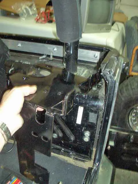

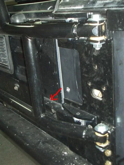

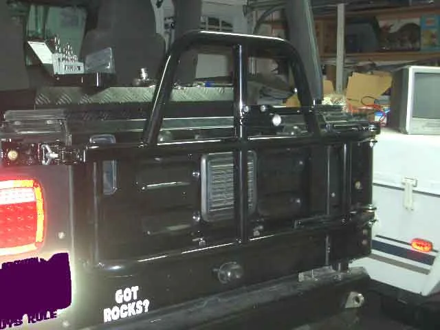

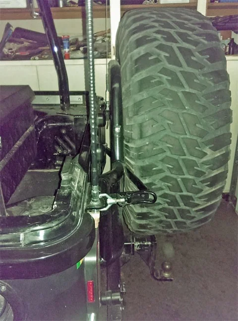

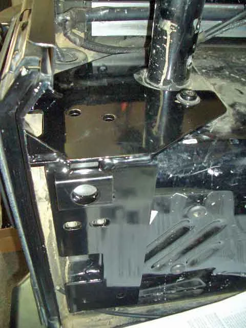

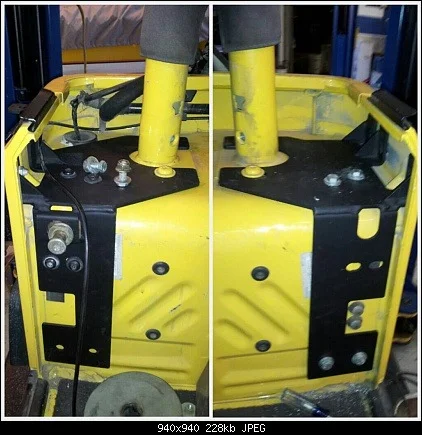

It ties into both sides, it has brackets that are mostly hidden that bolt to the bases of both rear rollbars. It's truly a great design that I've had on both of my TJs. :)
I showed the pictures to Faye and she LIKES it. The swing away with the double shear is more than a royal PITA.
Here are a couple rather poor photos of my ORF carrier... the yellow Jeep isn't mine, its photos of the support brackets are just good.
