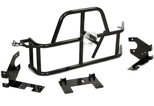

In the ORF's case, the wheel support goes through the large center hub opening... the tire rests on top of a support bar so it doesn't use the lug nut holes. It doesn't care what the bolt pattern is.Okay I'll bite. Why?
And there in is the answer mske my own adapter. Had to do that with present set up. How does ORFsecure the tire?In the ORF's case, the wheel support goes through the large center hub opening... the tire rests on top of a support bar so it doesn't use the lug nut holes. It doesn't care what the bolt pattern is.
For the OE/Exogate, you only need to drill a piece of flat steel to match the 5.5" bolt width and install 1/2x20 studs or bolts into it. Then bolt that adapter onto the carrier.
With a big coarse-threaded screw-in T-handle with a backing plate. The wheel doesn't sit on the handle itself, it sits on a steel support positioned just above the screw-in handle. The support is visible in the below photo.How does ORF secure the tire?
