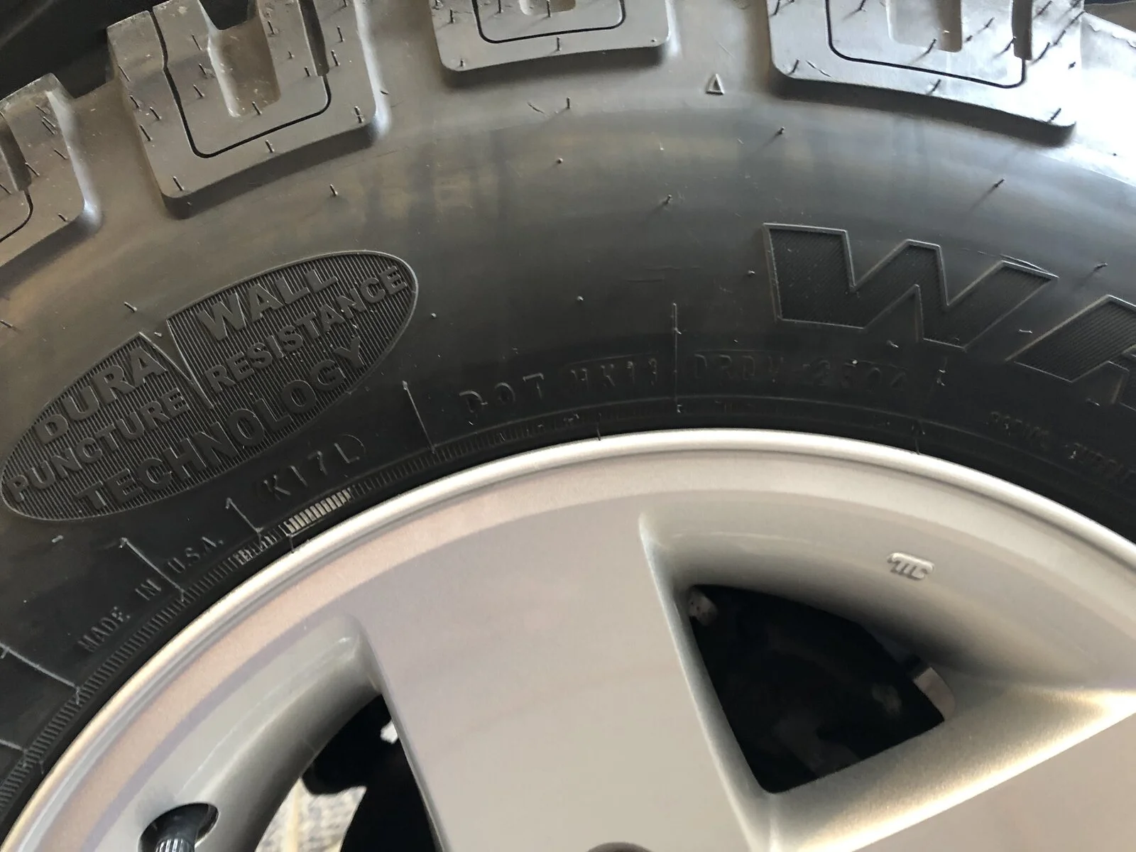

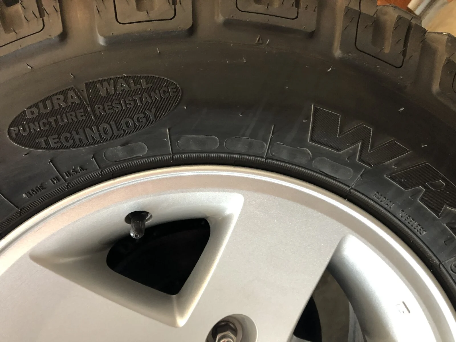

Found this - a little weird. NO DOT/ Date code markings on 2 out of 5 of the OE tires on the Rubi..
Never seen that before, usually rely on the date code for age of tires.
This is strange. I worked in a Goodyear store and warehouse for 2 years. I’ve not seen this unless it was a race application. Only thing I can think is Goodyear ran a bunch of tires for Jeep as they were prototyping the TJ??? Seems unlikely given the other tire was manufactured in the middle of ‘04.

100% SURE - JEEP only has 10k on it and wheels had never even been off of the rig until I got it. Bought it from business partner of original owner. This jeep is an '04, so prototype doesn't make sense as they used these on '03 Rubicons.
It’s not normal. Like a vin #, each character represents something important to the manufacturer. They use these to track a variety of things, quality control, molds, on and on. Think firestone debacle. How would Firestone know which tires were prone to blow on the explorer? They manufactured different tires to meet Ford’s needs for that vehicle. Could have been any number of things like a compound to improve fuel economy or softer compound to improve braking. It’s done all the time.

The last 4 number are week and year of manufacture. Those tires are from 23rd week 2004.
DOT is only required to be fully printed on one side of each tire, check the other side. Unless they made a mistake and forgot to insert the numbers into the model they should be there to read.
Yeah, I gotta take a look at the inside sidewall - didn't notice the code there. Jeep was built on 7/1/04 so early June on the tires is correct 23rd week.
I retract all my earlier comments. I assumed you looked for the DOT stamp on both sides of the tires...
It's not uncommon to see partial or blank DOT on one side. Lazy in my opinion, but meets the requirements. Your tires are almost old enough to vote. I would replace them.
