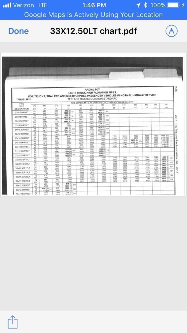

The way the OEM’s come up with the PSI rating on the doors is by using a formula. Max weight of tire listed x 4= x. X / curb weight = x. Max PSI listed on tire / x= suggested PSI
So sidewall max weight = 2250 x 4 = 9000
9000 / 4000 ( weight of Jeep) = 2.5
Max psi listed 55psi / 2.5= 22 psi recommend for Jeep.
Is you call most if not all tire companies and ask them how much psi to run they will ask weight of vehicle and use this formula. If I can find it I will actually post a file Cooper sent me on SST pros.
