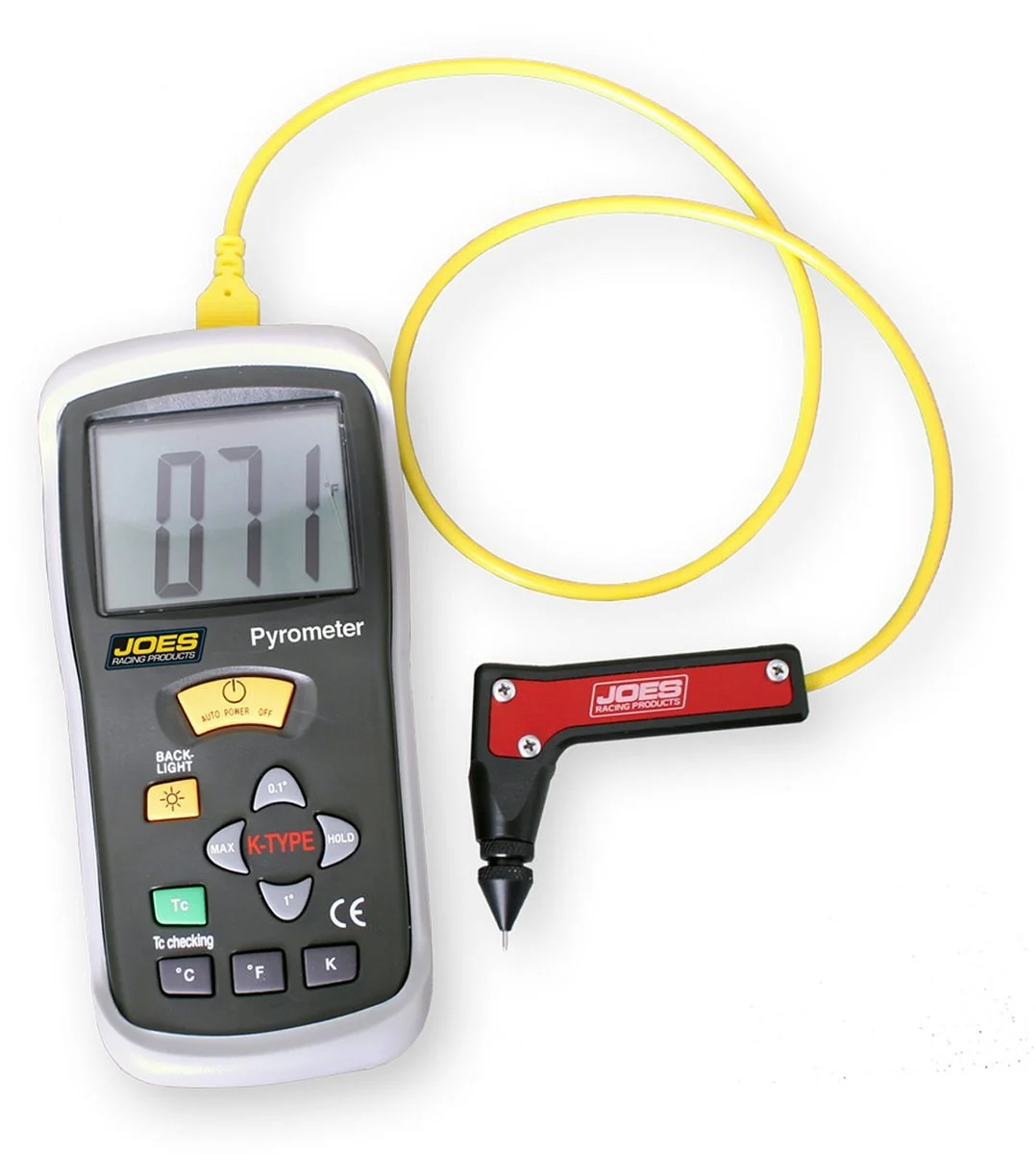

Something one of the members here said sparked a thought about setting tire pressure with a tire pyrometer. I did a little digging and came up with this on Amazon:
Reading on the racing forums got me to thinking about using one of these to set tire pressure on the TJ for different load conditions and tire sizes. Pretty sure that it would be only marginally useful, but it would be kind of cool to be able to set tire pressure for general street use, say get a tire pressure for loaded and unloaded weight, and check to see if the toe-in is set correctly or camber is way off. This one runs about $100 on Amazon. Wouldn't be needed for off road, because we air down anyway. But for street driving it may be useful and give us a little feedback and possibly a little long term payback on some seriously expensive off road tires.

It measures the temperature of the tire tread and indicates the amount of ground pressure on the tire. For best traction and wear, the temp should be pretty uniform across the entire tread i.e. If the center is hot, too much pressure. If the shoulders are hot, not enough tire pressure. Hot inside or outside shoulders on both front tires, bad camber or toe-in. On the TJ, we can't do anything about camber, but it's easy to fix toe-in.

Less than $100. I suspect that a really good digital meat thermometer would do the same thing for about $30. It appears that the temperature ranges we are talking about for street tires is in the 150°F range plus or minus probably 20 - 30°.
Here's the link: https://www.amazon.com/dp/B005JVFTTM/?tag=wranglerorg-20
