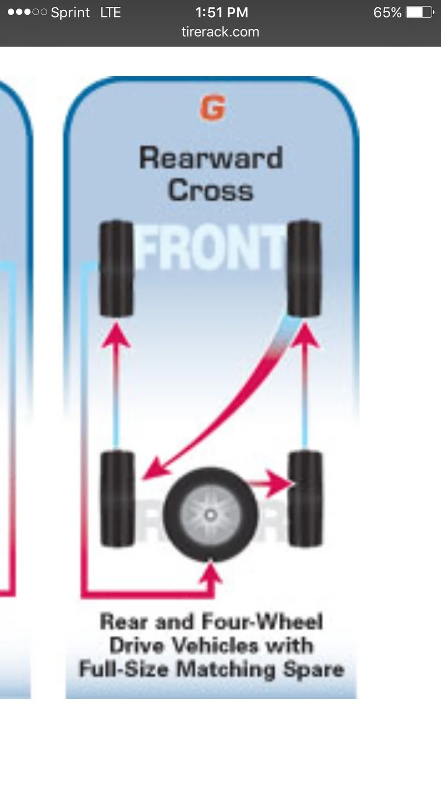

My spare is unusable for rotation since it is pretty worn and has a couple of visible plugs. Obviously from an older set but at least it is the same size as the ones on the ground. Is it better to do a criss-cross rotation or back to front on the same side when just rotating four tires?
Sent from my iPad using Tapatalk
I always thought it was kind of a hybrid of the two. Front wheels go straight back and the rear wheels cross forward.
Reactions: derekmac
I rotate my KO2s every other oil change (6000 miles). This is the correct way to rotate with your spare. Even for me so far
