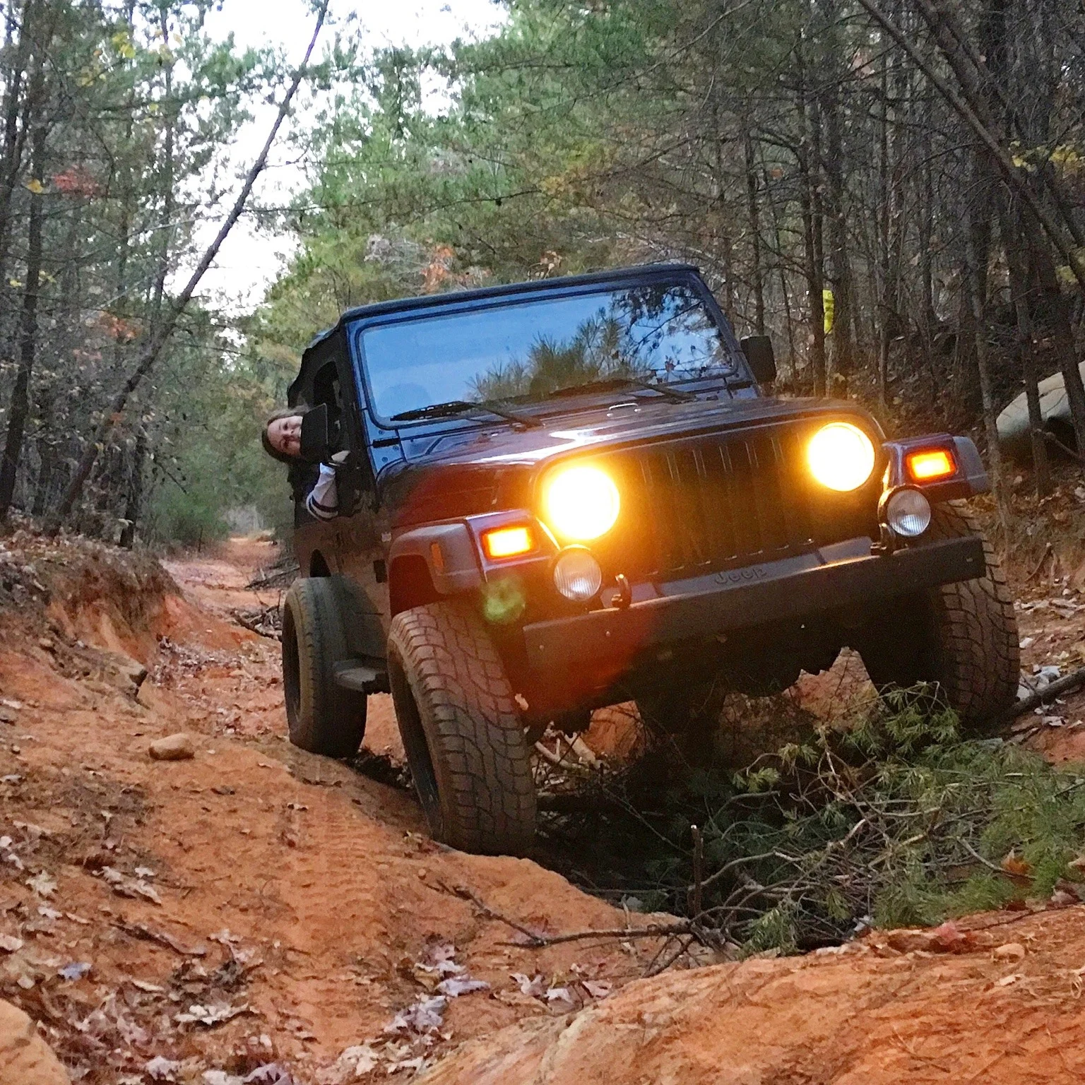

I bought my 2.5l 97 tj with 170k miles on it. I have a 3" rancho lift with steering stabilizer. I have 31" all terrains on it now and It seems to handle them just fine in the torture I've put it thru so far. But I need new tires... Would it handle 33" tires without much more strain?

No on that 33" tire question, that's a significant bump up in size while it may not seem so. You neither have the tire clearance they would require on trails like you're in in that photo, nor the extra power needed to turn them. You'd really want at least a 3" suspension lift plus regearing the axles to 4.88 assuming your 2.5 has the 5-speed transmission behind it. 4.56 if it has the automatic. :)
