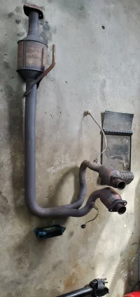

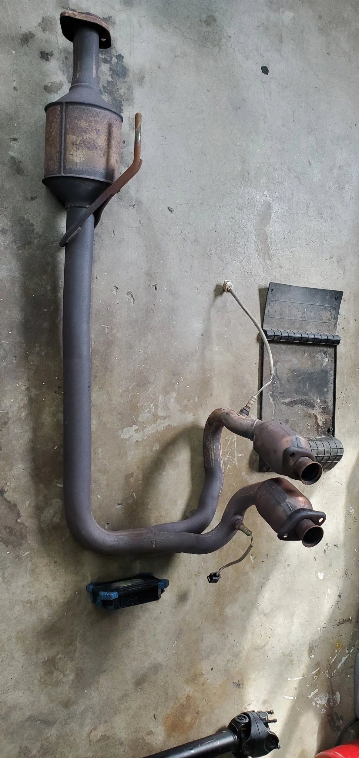

After removing the front nearside wing for the fourth time to check and tighten the four fasteners that hold the headers to the cat, and now needing to do it again, I'm hoping someone knows a solution.
I have used 4 new fasteners, added butterfly washers and tried a small dab of threadlock, and still it has opened again. TIC TIC TIC TIC........
I noticed that the '96 - '00 uses a 6 into 1 exhaust manifold onto a single system pipe utilising a donut gasket. Mine didn't have any fitted, I can't see any evidence that they are required on the later TJs but this is the way I am heading - measure the header exit and the cat joints to see if a suitable donut would fit.
Anyone else had similar issues? What were your fixes?
