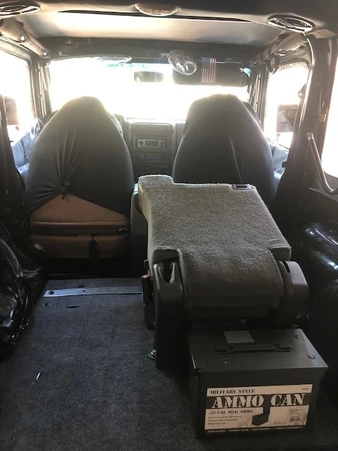

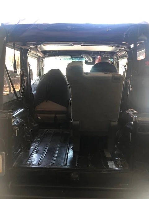

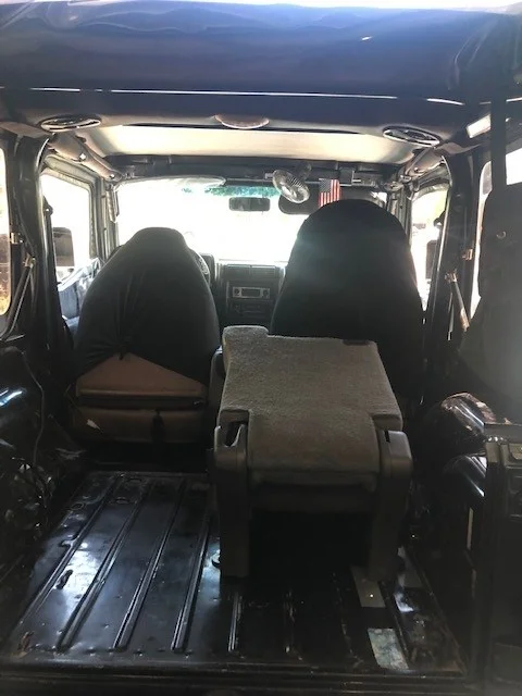

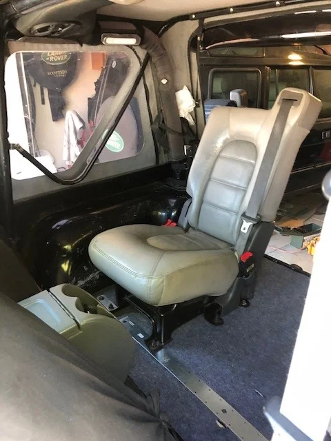

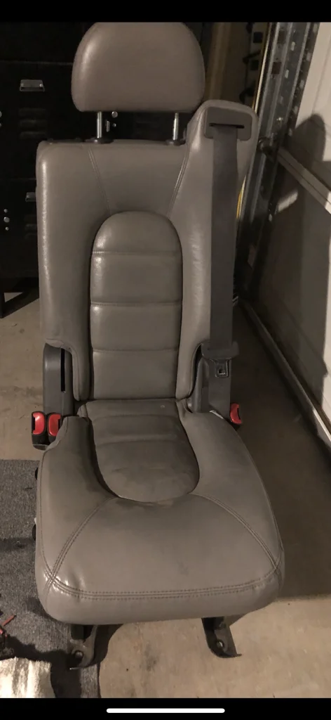

Hello Wheelers - This has probably been posted so many times it's boring to some. But I had a need to fill for a back seat for a small adult or young'n. The seat is self contained(belts) which was key for my need. This rumble is from a 2nd row middle jump seat off an expedition. Most likely a 2012 or so. It lines up well and a couple floor holes are good to go(back fender well and center floor hold). Check your head rest clearance and secure it down as needed in the front. This is a dirt trails and forest road jeep and not a highway rider or rock crawler. The oem bench seat was to space consuming and this allows for gear and chests. Anyway hope this gives you an idea on what can work. Oh the costs for these seats are various. This was a fathers day special at the local bone-yard offering 50% off all parts so it came to $24 bucks. Thanks for watching...
