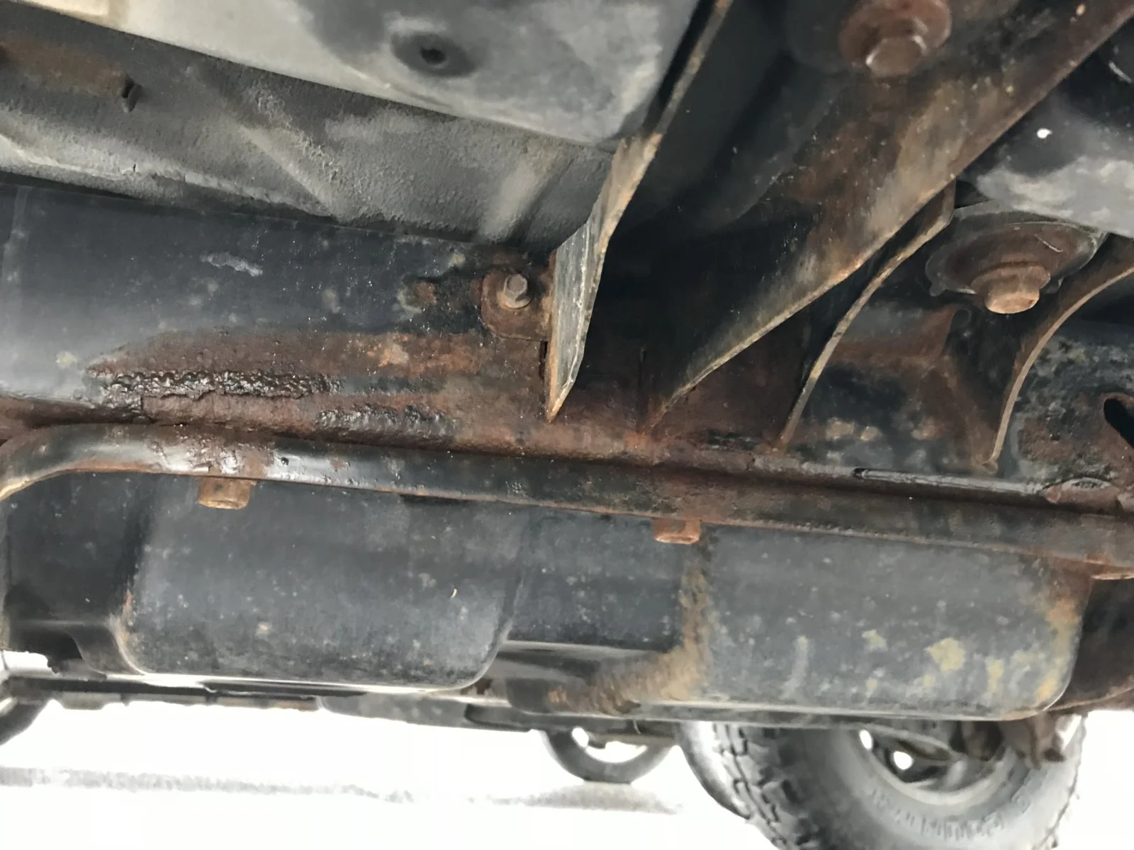

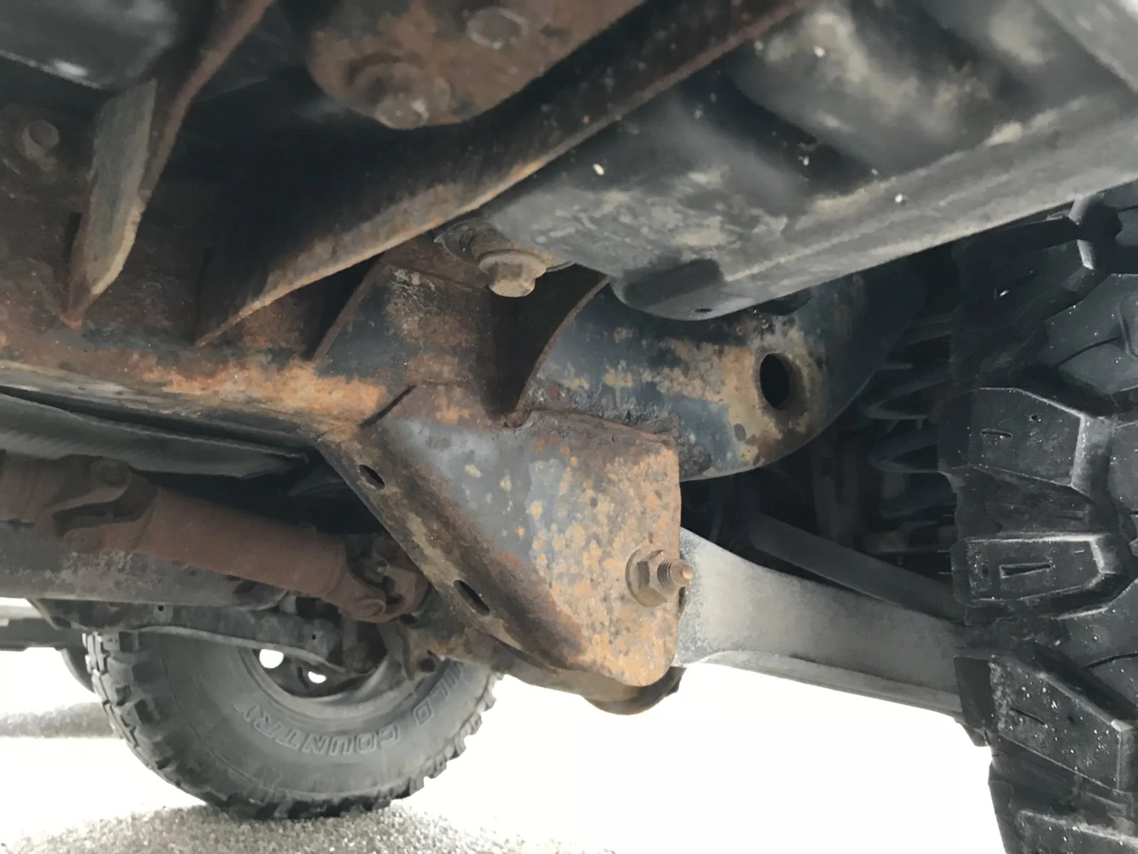

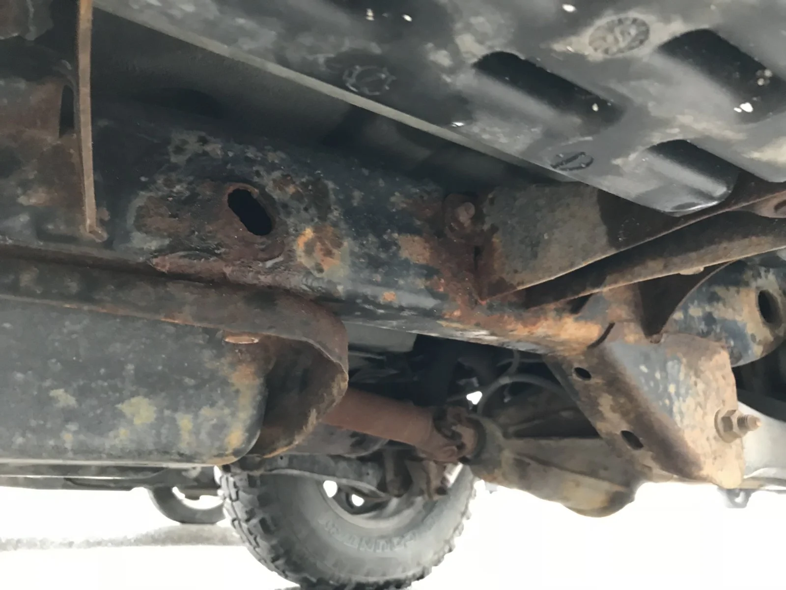

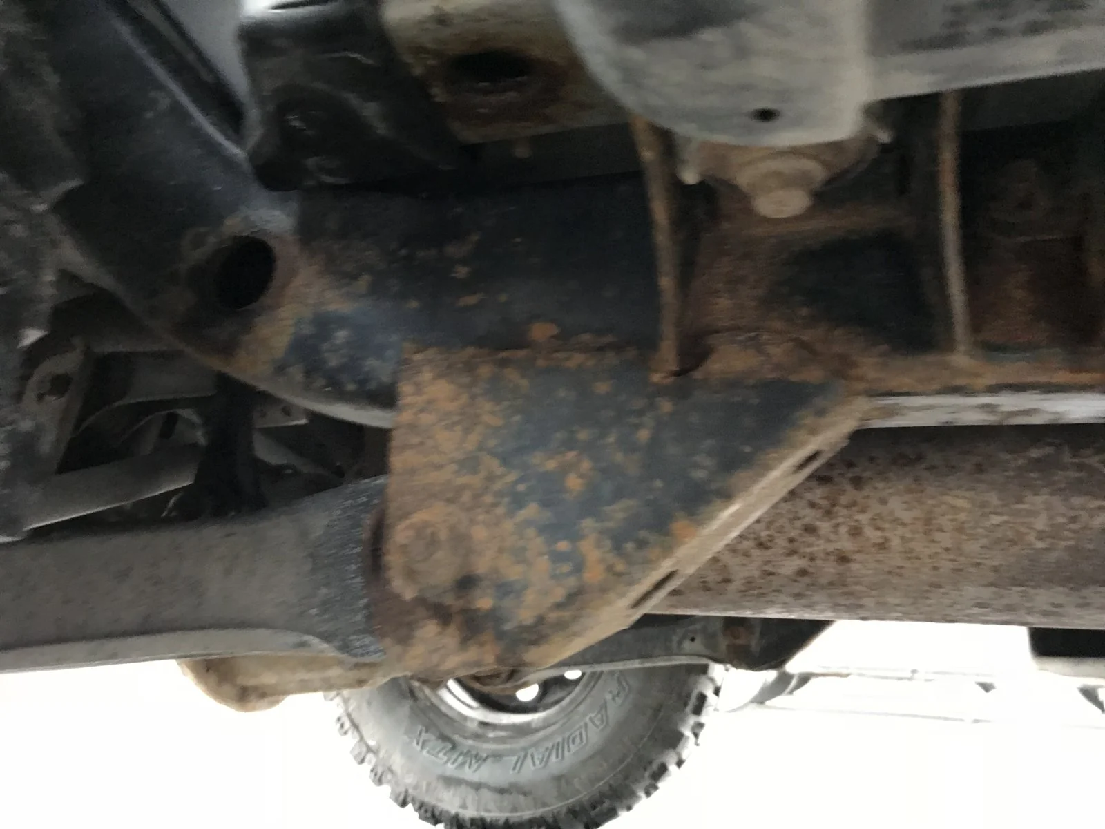

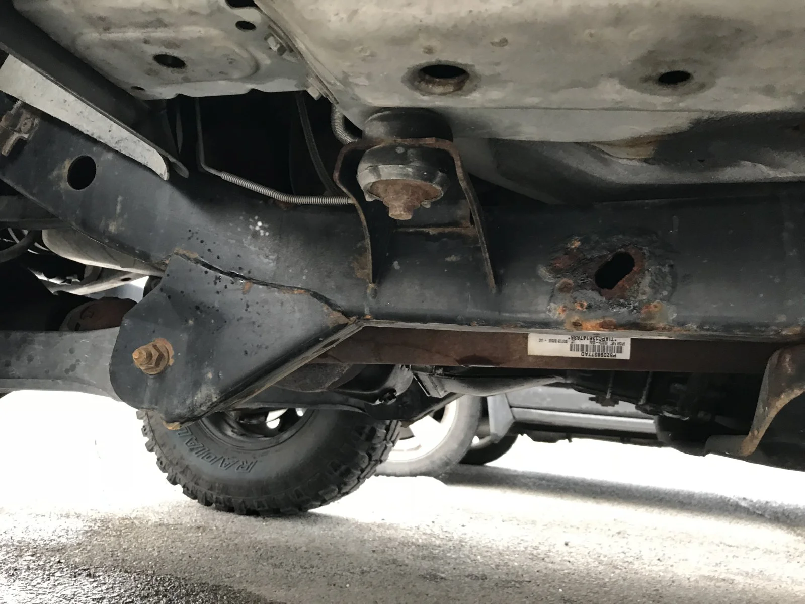

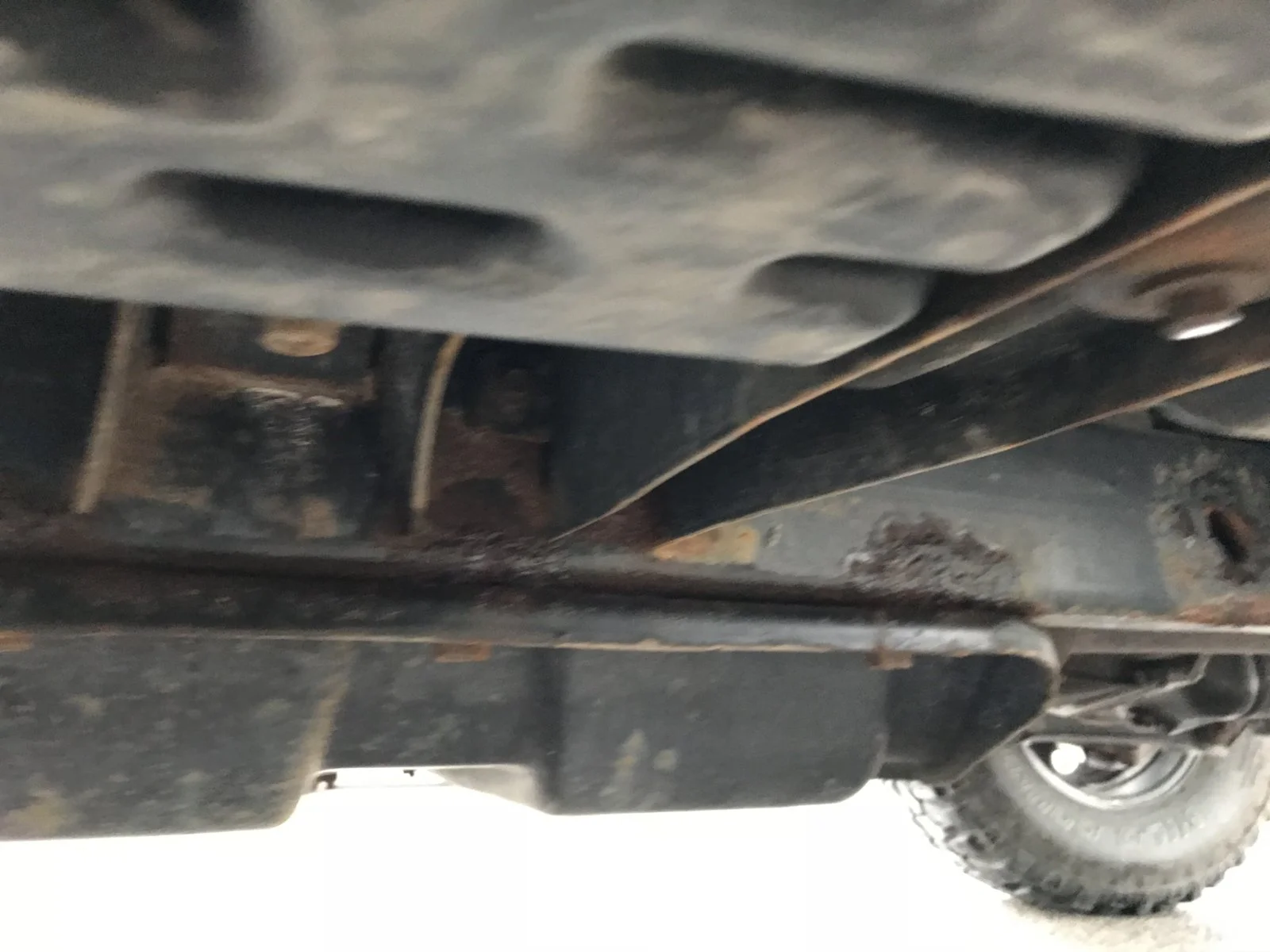

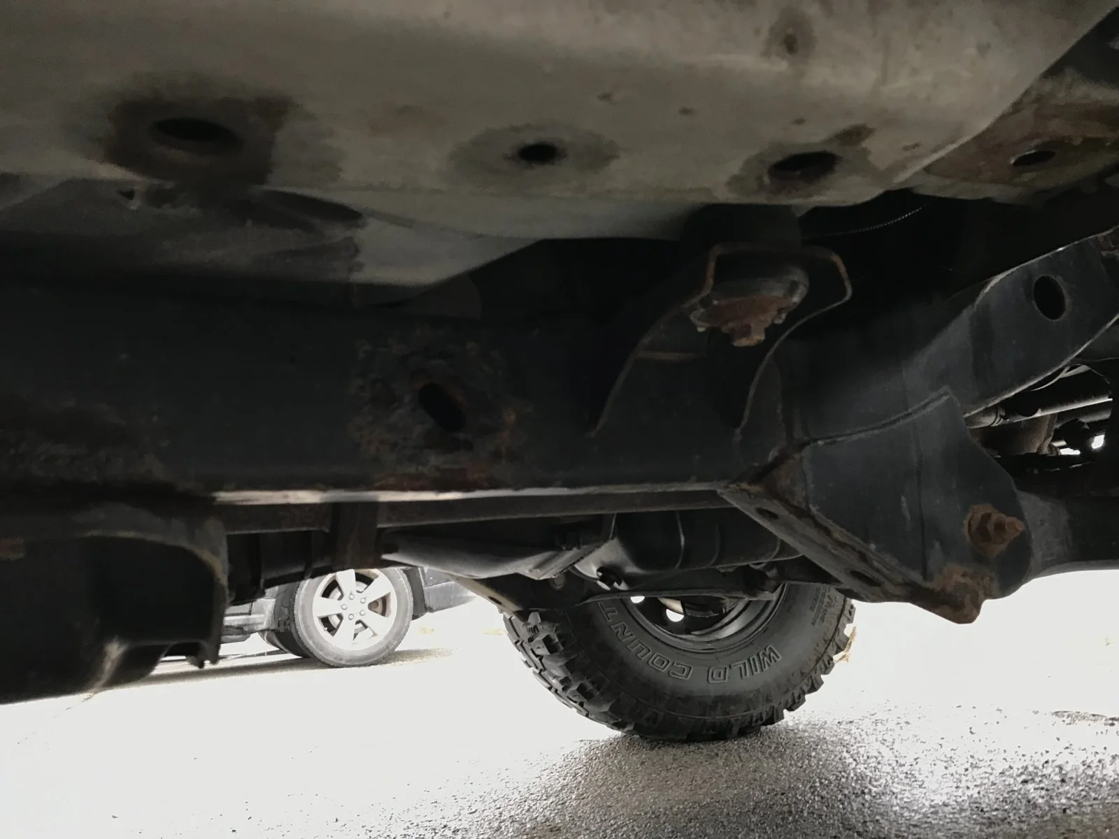

Since I'm in Nebraska, I'm paying extra attention to frame rust since we use tons of salt & brine on our roads. I've driven a few TJ's already, and I'd like your expert opinion on this latest one. Here are some pics of the frame. I have my opinions, but I'd like to hear yours. I am in no hurry at all, just want to make the best purchase I can.

Is this one of the better ones in your area? Looks like a LOT of rust. Lots of surface rust but some on the frame looks bad. If you can and you might need to ask if you can thump on it with a small hammer. You will know quickly how deep the rust goes.
That frame isn't going to break in half anytime soon, but I wouldn't spend any money on a TJ that has already seen a significant amount of salt. I would feel comfortable driving it around but I certainly wouldn't buy it.

I'll be more than happy to take your money and send pics of my Jeep to show your friends. only joking. Go to car-max get one from NM or TX shipped 4 about 400.00

You guys are fast...No, I wouldn't say that's one of the better ones in the area. It's the worst of the ones I've looked at so far, so I was just trying to gauge how bad you thought it was. Seemed like a lot of surface rust to me, but my sample size is pretty low.

Be careful when looking at TJ frames. The outside of the frame is only useful as an indicator towards what the inside of the frame might look like. If the outside of the frame has heavy surface rust, that is an instant red flag. Even if the outside of the frame has 0 rust, you have to check to make sure the inside of the frame isn't rusting away. The unfortunate reality is that 95% of TJ's that have been driven in winter salt will have some sort of internal frame issues.
I would recommend searching areas that don't use salt. For example, if you find an Arizona Jeep that has been in Arizona since it was new, I wouldn't be afraid of buying it sight unseen as long as the miles are fairly reasonable.

I'd say for the most part that Jeep doesn't look too bad. I'm even surprised that there is no build up of rust between the frame and the skid plate. Of course I wouldn't trust that frame without sticking my finger in every hole to see what's inside and lightly tapping around with a light hammer to listen for lower pitched quieter sounds. The lower the pitch and the quieter the sound anywhere on the frame pretty much means more rust in that area.

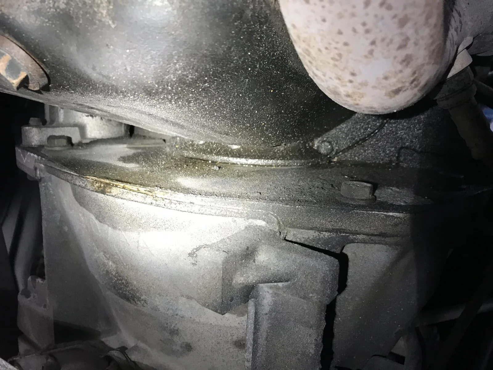

2. Rear Main Seal?
See the photo below - rear main seal leak? He just replaced the valve cover gasket, so I suppose it's possible that this is residual from that, but it looks fairly fresh to me.

Rear main seals leak pretty often on 4.0's.
clean from the valve covers down to the bottom of the block and see if the leak continues. Not a reason to walk away...most have them and this one if it is a rms leak is very small and would not worry about it.

Yeah sounds a bit more like an exhaust leak, but it's really hard to tell. Could also be a lifter tick. Does the noise go away or change when you rev it? And that's a typical rear main leak.
