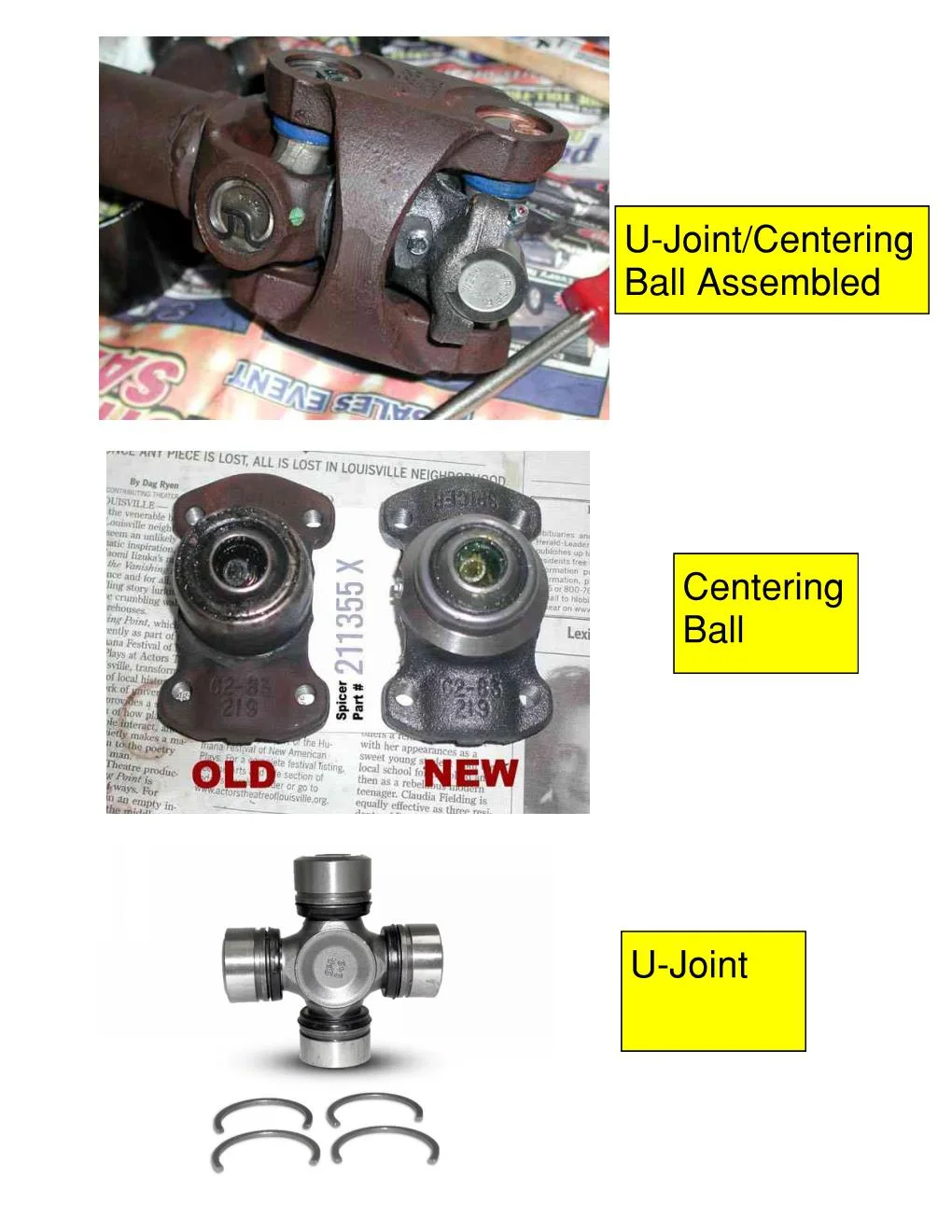

If you notice it on acceleration, the front drive shaft u-joints would be another good check like @nathanotis recommended
If it sounds like a bunch of little birds, aka angry sparrows, it is most likely your front driveshaft centering ball. Pull the shaft out and if the sound goes away that's your culprit. Even though the centering ball is the problem, replace all the u-joints and centering ball while you have it out.

I know this may sound like a dumb question, but are the u joints part of those 7 boots on a tj that get greased?

And wondering if after we check out the belt and 2 pullys, if the drive shaft centering ball fix is one of those things to take to a mechanic because it's a bear to do? I ask him to help with things but if it is too much of a headache I don't do that to him
the centering ball is a part that will be apart of the disassembly/assembly process so it would be a good idea to replace while you're at it. I don't consider u-joints to be a hard job but that's subjective. you do need to have the ability to press the joints in/out so I would ask your buddy that.
It's easy to pull the front driveshaft to eliminate that as a sound source. It is difficult, however, to get to the bolts at the transfer case end without the skid being removed. I tried doing it without the skid removed once and it definitely did not save any time
Here's a visual that should help
Perfect, thank you. Yes, I see that when I grease the boots, now I know what it's called

There are 3 ujoints on the front driveshaft and a centering ball. If you remove the shaft (it’s 8 bolts, all 5/16” or 8mm) and the squeak goes away, that’s your problem
