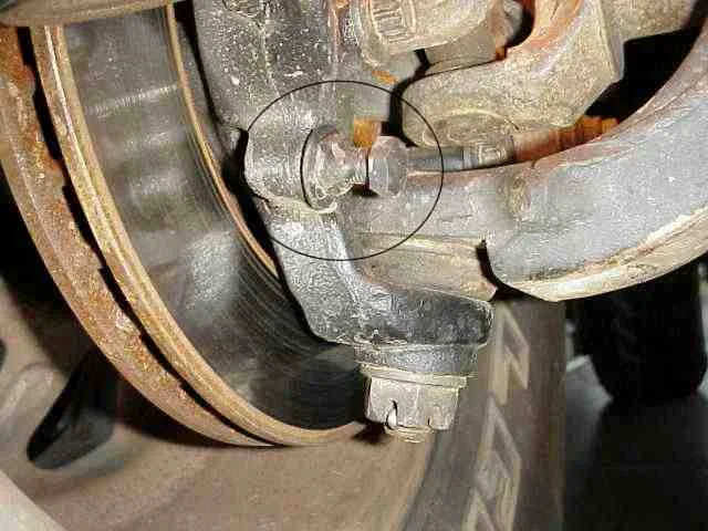

The picture below shows the steering stop adjuster (circled bolt) on the passenger side steering knuckle.
To adjust the steering stop, all you have to do is loosen the bolt and install one more more washers onto the bolt, then put the bolt back in. You may need to play around with how many washers it takes, as it varies from vehicle to vehicle. The more washers you install, the less you will be able to turn the steering.
