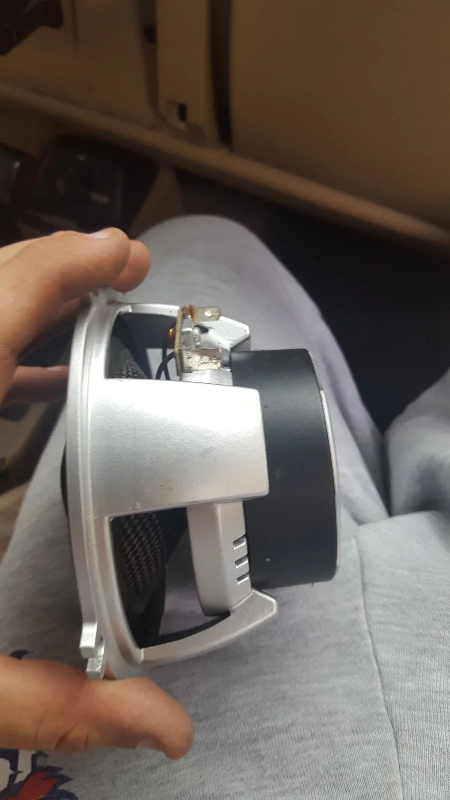

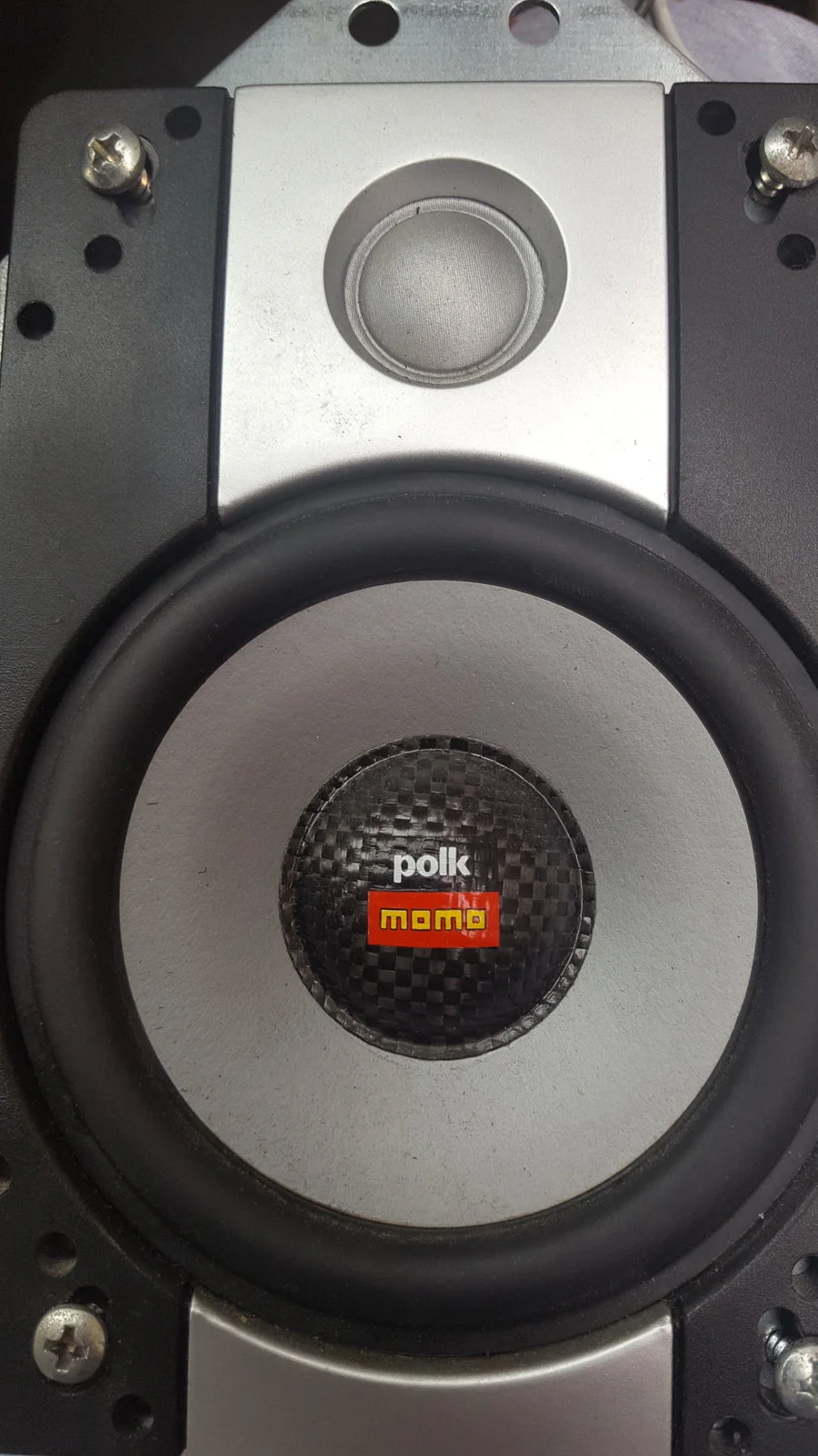

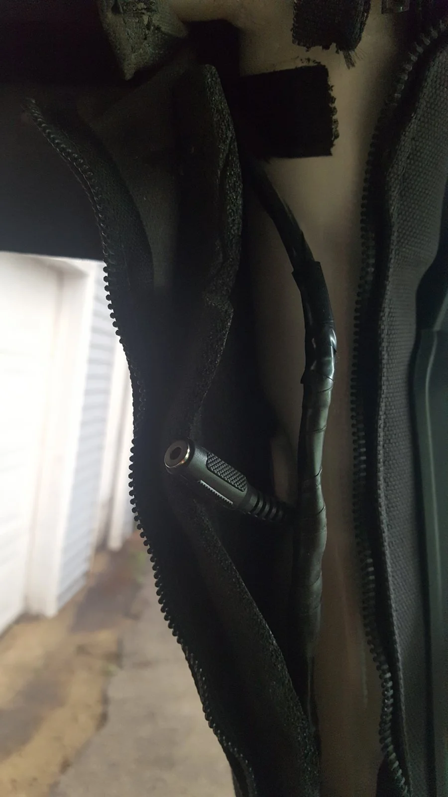

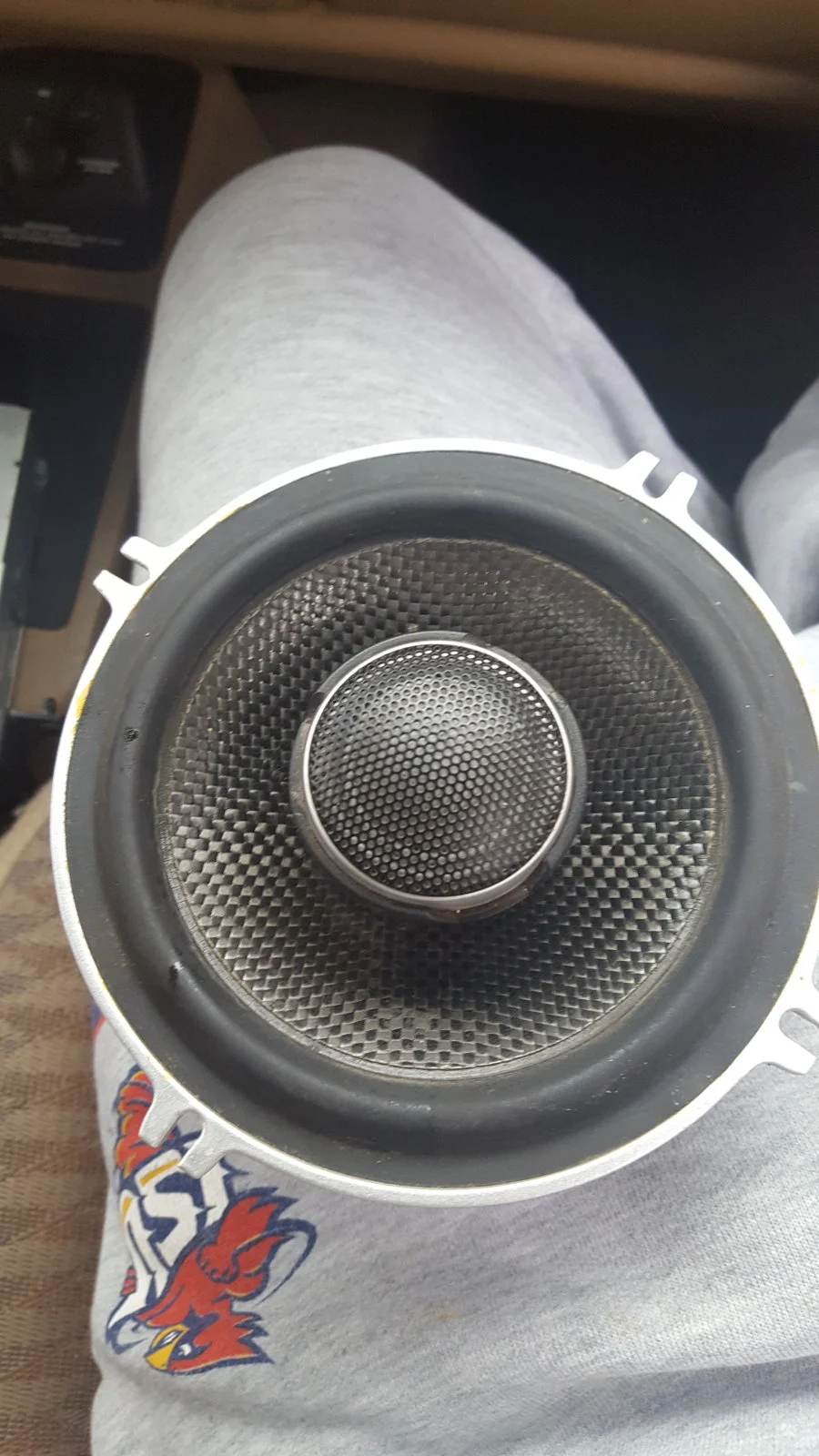

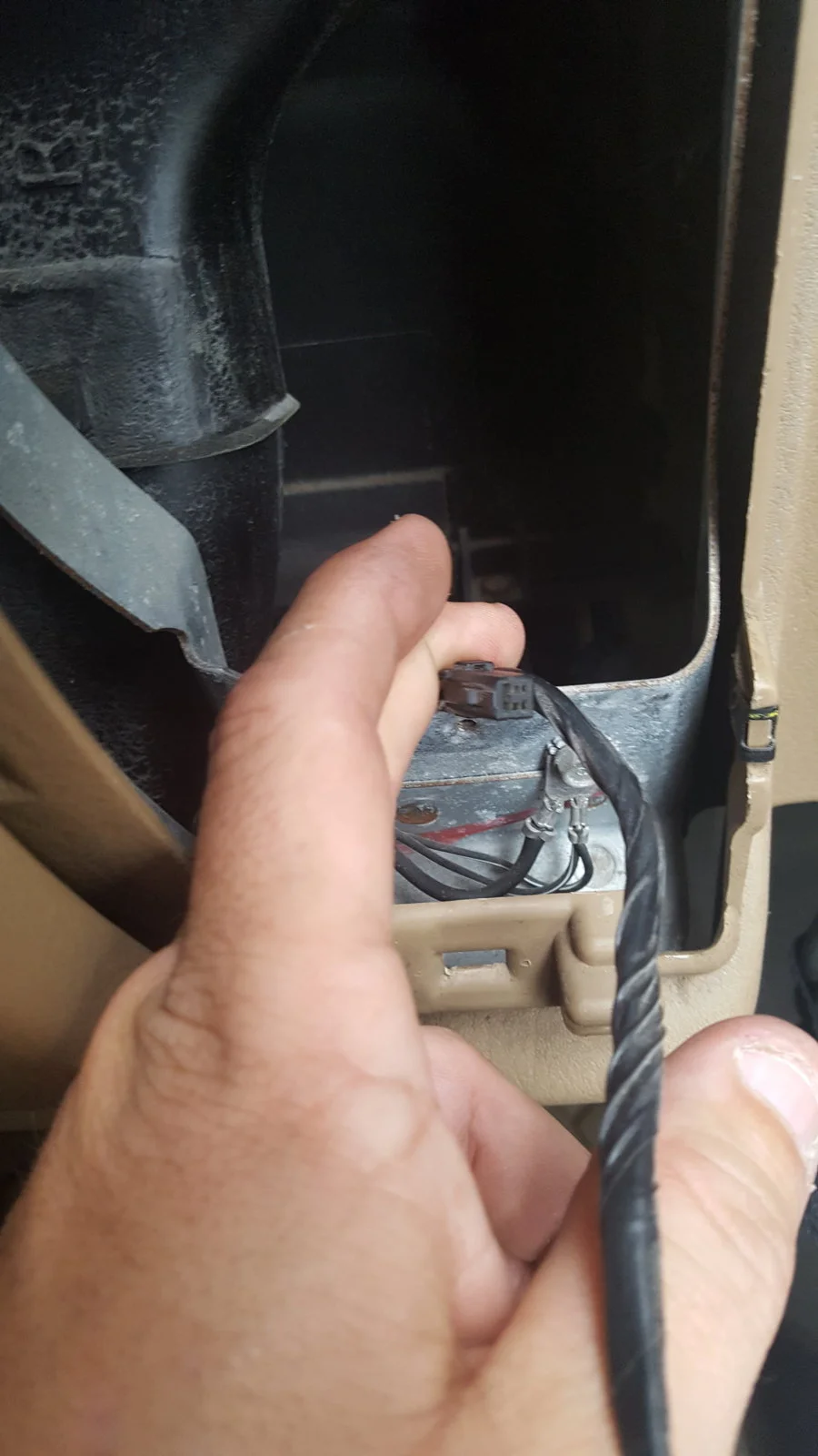

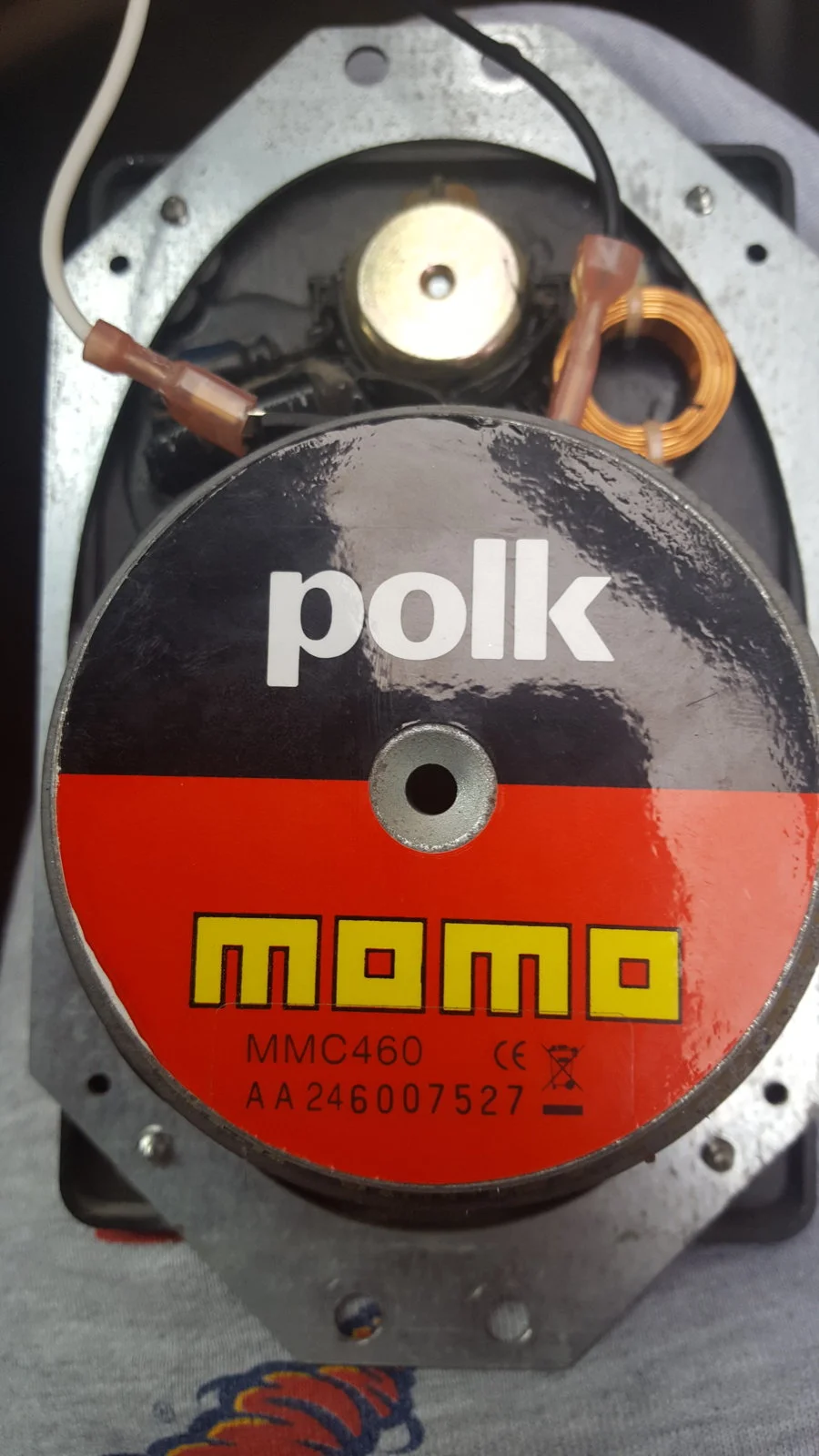

Ok guys having some issues with my stereo. I put a new Kenwood head unit in because the last unit the speakers would have static come through as I turned up the tunes. Thought it was the deck and ground replaced one fixed the other. Now it still does it. I think my sound bar is connected to the left front speaker would this cause it as it would not be getting the 35 watts by 4 but 35 to front R and 35÷3 to left front and rear speakers? Also while checking my speakers I found some what the heck are these wires for. I posted pics to see if anyone recognizes it. Also some of the speakers so you could tell me if an amp is needed cause the magnets are pretty big and I don't know the wattage of the Polk momos that are installed. Thanks ahead of time for all the help.
The little plug is for the factory speaker. The 3.5 mm cable looks like it was an extension for something, not sure what. You don't need an amp. And at this point it would just add another piece to the puzzle. I would go through all the wiring again. Even better, replace the speaker wire so you know there isn't something amiss with any of it. What are you listening to when you are hearing the static? CD, Ipod, streaming?

So, you could google that MMC460 number. That is probably the part number of the speaker. Then you'll at least know what power they are rated for. You also want to make sure you wire them up properly. ANY aftermarket radio made in the last 20 years or so should have 4 channels, so you'll want to wire the speakers up independently. Make sure you pay attention to polarity as well, or else you'll get sound cancellation.

Tadaaaa I fixed it I did end up rewiring the soundbar speakers with higher quality wire but the problem was the 3.5mm cable was tapped into the old speaker wires why I don't know but I fixed it and now I can rock out. Thanks for all the help fellow TJ'ers.
