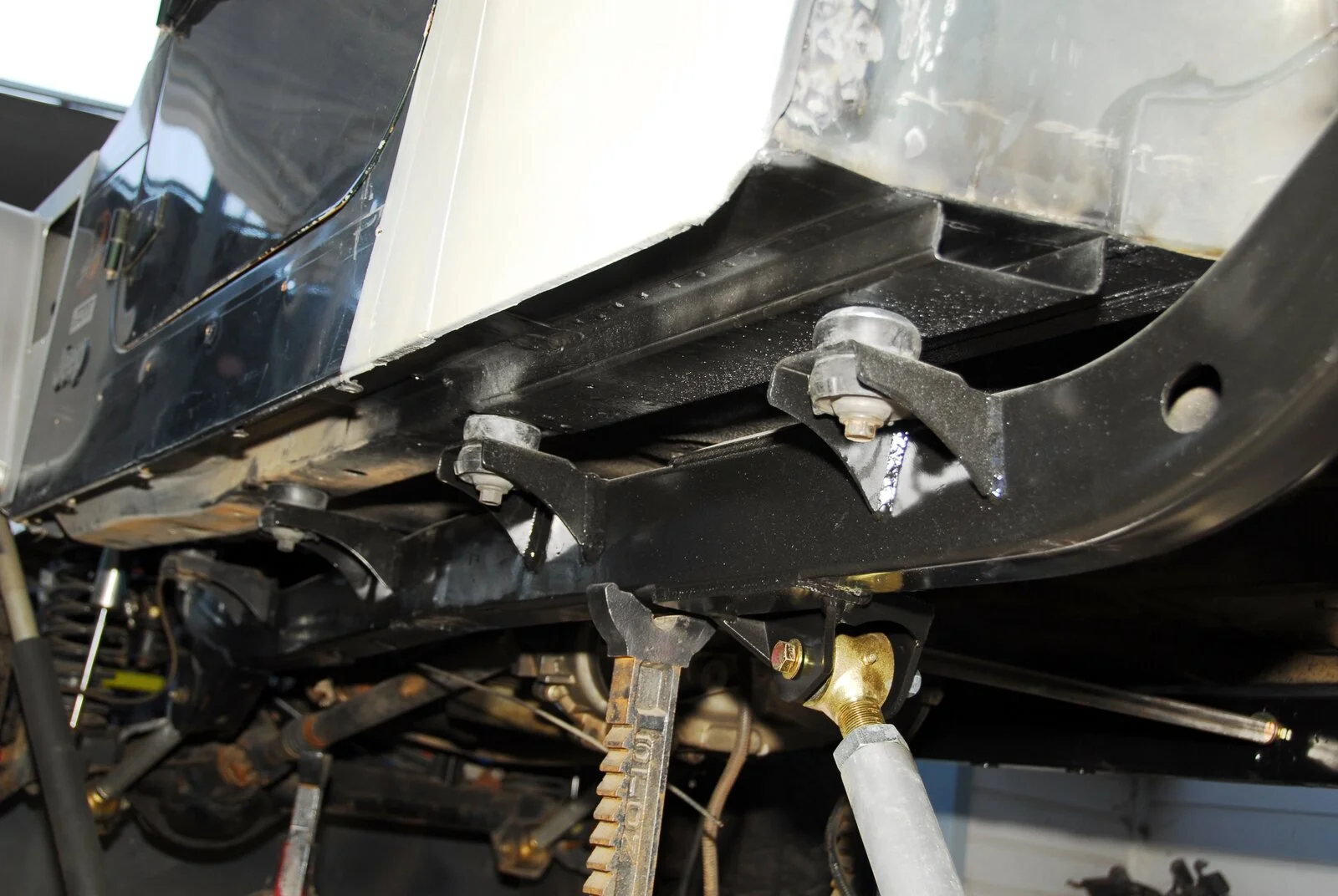

Given what is involved in building a TJ-6, I was very surprised at the responses. I expected much better.
I asked if those who had used the standard accepted method for building a TJ-6 had built and installed a 4th body mount behind the original 3 since the span is now 15" longer. Why did you or why didn't you do so?Perhaps it's just some people copying what you've developed and understand while they are just following a trodden trail. You then offer a furtherance of the knowledge and get questioned because change is scary and bad.
Yes, we've been doing that since at least 2000 long before there were kits. In fact, the ones I did on Jon's rig for Viking Offroad and Winchline.com were the ones that Genright used to build theirs.Nice find. Please forgive my inexperience, but in looking at both pics, it appears you raised the body mounts negating the need for body lift? If so, makes sense to me.
No idea I just figured if the factory used a certain spacing and I exceeded that, I should fix it.I imagine, due to inherent frame flex, that adding a body mount not only strengthens the whole assembly, it lessens frames sag or distortion also preventing tub damage.
If you like nice clean work and want something that has to be stared at a bit to figure out what has been done, it is a buttload of work. If you have low standards, it can be done much quicker.I've only begun to look into a TJ-6 but I like what I'm seeing as far as effort to benefit ratio. The 108" would suggest a 40" tire at 19 belly height? Just wondering at this point.
Thanks for the detailed reply. I am beginning to see just how much planning and effort go into making it look like nothing was done. I'd love to see Blaine built TJ-6 in action next to a Blaine built 35 tire TJ/LJ even if just to see the different abilities of each. Thanks again.Yes, we've been doing that since at least 2000 long before there were kits. In fact, the ones I did on Jon's rig for Viking Offroad and Winchline.com were the ones that Genright used to build theirs.

I have had lots of folks look at mine. The vast majority of them don't even notice it is 15" longer, has a TJ overhang at the rear tires, or that there is a lot of room between the rear of the door opening and the front of the rear flare. Nothing really stands out as something to give them a place to start noticing. I hope the same is true after paint.
