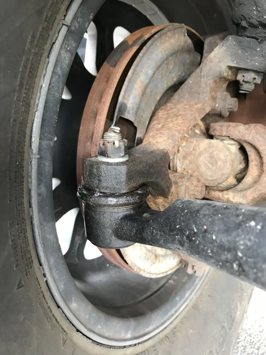

I recently installed a Currie Currectlync system on my TJ and almost 3 months later I’ve already got a torn tie-rod boot.
What I noticed when installing the Currectlync was that the tie-rod ends sunk pretty far into the knuckle almost flattening the boots completely. I added a washer or under the nut to keep from drawing the nut so far down that the cotter pin would fall out. The passenger side isn’t so bad and hasn’t had any issues yet, only the drivers side so far. Any idea what’s allowing the TRE to sink so far into the knuckle? This is the first aftermarket setup it’s ever had and I’m the only one to ever touch the factory setup. I’m headed to the beach next month and don’t want to get sand/debris down in there while I’m almost 400 miles from home
Passenger side:
Drivers side:
Passenger side:
Drivers side:
