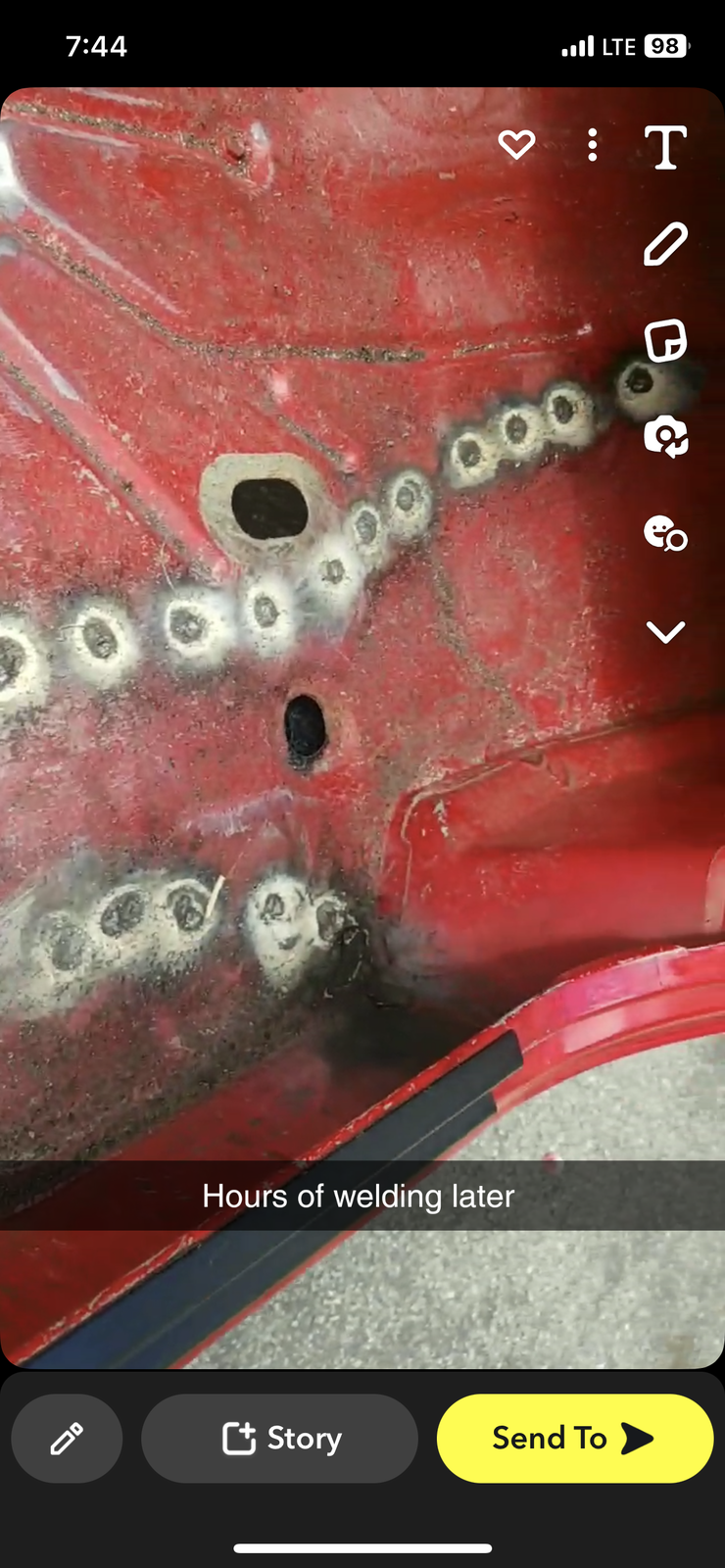

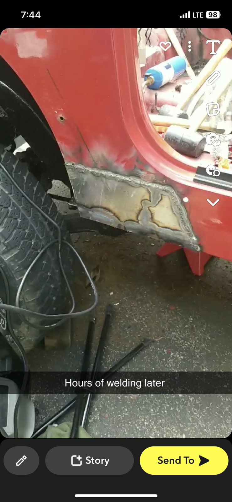

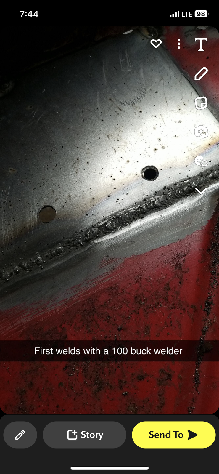

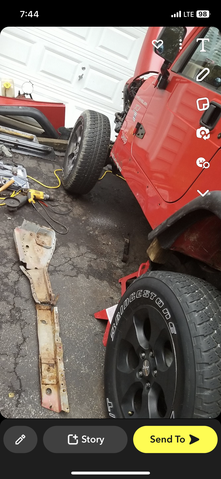

I had to cut out the base of the tub where the b piller of the roll bar mounts and the whole torque box so I have no experience with the safety cap. Was a multi day project in the summer a few years back. First time welding with a cheap hf flux welder too and yes I know the welds look like chicken poop I was 19 then. Was an absolute pain since I decided to drill out the tack welds but now my jeep is still holding up. Excuse the photos, apparently I can only find the pictures through my Snapchat memories since it was that long ago. I don’t let the tub fill with water since the previous owner had a leaking top. Thankfully since don’t have any rust showing at any of those points and am very anal about having a top on for the rain.

Not to bad 1st time welding. I'm using a HF chicago electric 220v flux core as well. Thanks for the pics. Hopefully I can use the caps and not cut the whole thing out.
