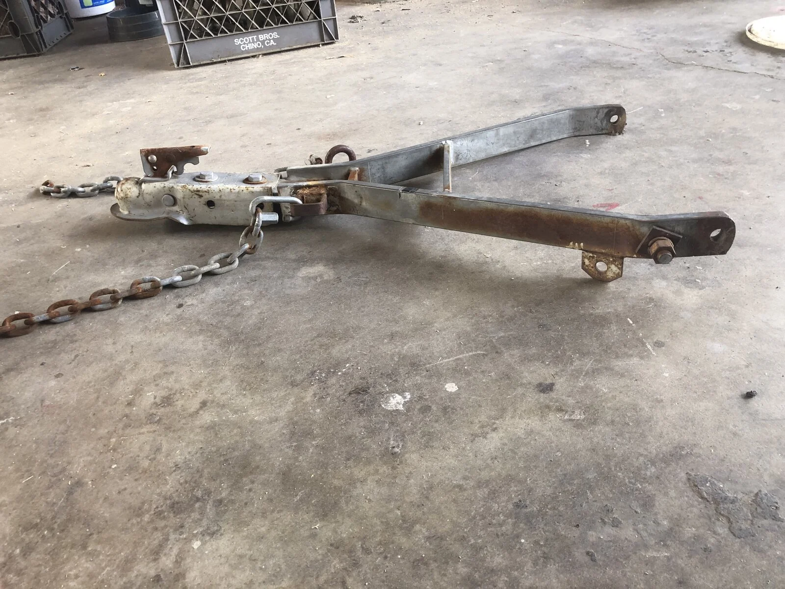

This the tow bar I picked up used for about $100. I like it in that the arm do telescope which helps with connecting it to the motorhome. I can also disconnect and stow it quickly if we want to head somewhere for lunch or explore a town. I have also needed it when I got into a few situations where I could not turn around and had to disconnect the Jeep to get it turned around. Another thing for me is Rv and Jeep are stored on my property and I can pull everything out and have it hooked up in about 15 minutes. Dislikes I have to bolt the attachment brackets to the bumper but I can do this a week in advance so not a big deal. I do remove them to run trails.
For the brake system I used a invisibrake. It stays mounted in the vehicle under the rear seat area. Raise the seat mount 1” with aluminum flat bar. This system charges the brake booster and used a air solenoid and cable to actuate the factory Jeep brakes. It works well but looks like it has gone up in price a couple hundred since I purchased it.
