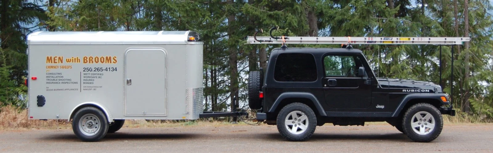

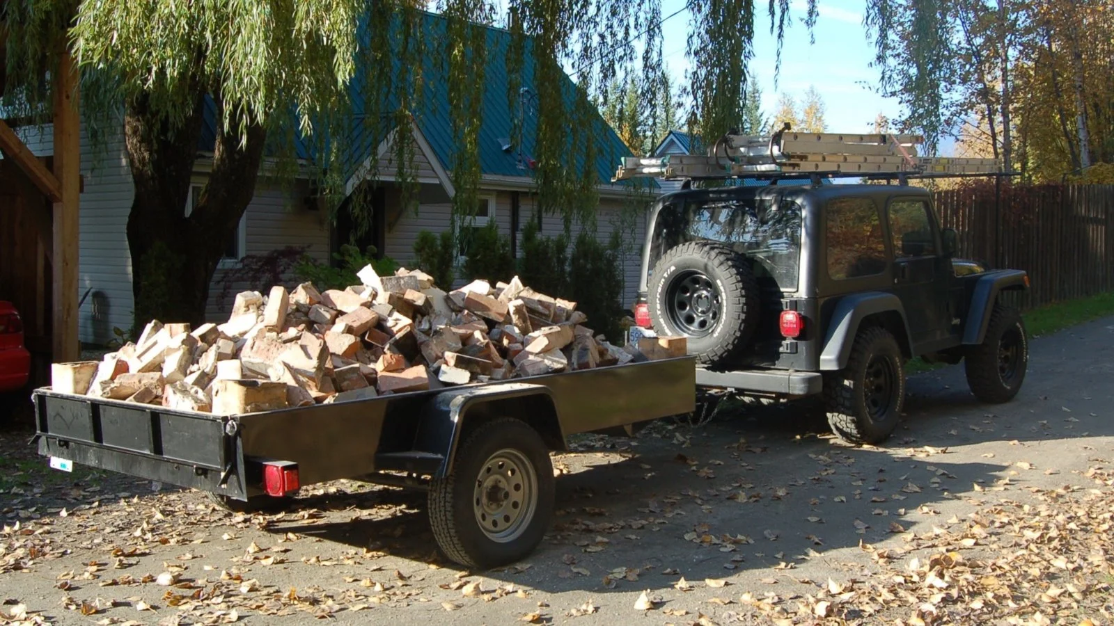

I tow over 10K miles every year in the mountains, 5x10 Cargo.. used to weigh 2K#... I've added a generator and saw tho. No issues.
And this, a few times a year... this load scaled 3500# at the dump. The hype about short wheelbase is all hype. I drove a single, single tractor trailer for years, 52K gross on the shortest Mack. Ever see the dashcam videos of diesel quadcabs doing the death wobble with a 30' travel trailer? You either know how to drive or you don't. With a trailer behind anything you need to be focused on driving.
PS, I'm not recommending you ever exceed the weight rating. But the logic is flawed. For a few years the JK & the JKU were both rated at 3500K towing.
For your use, a 5x8 Cargo with a motorbike.... not an issue.
