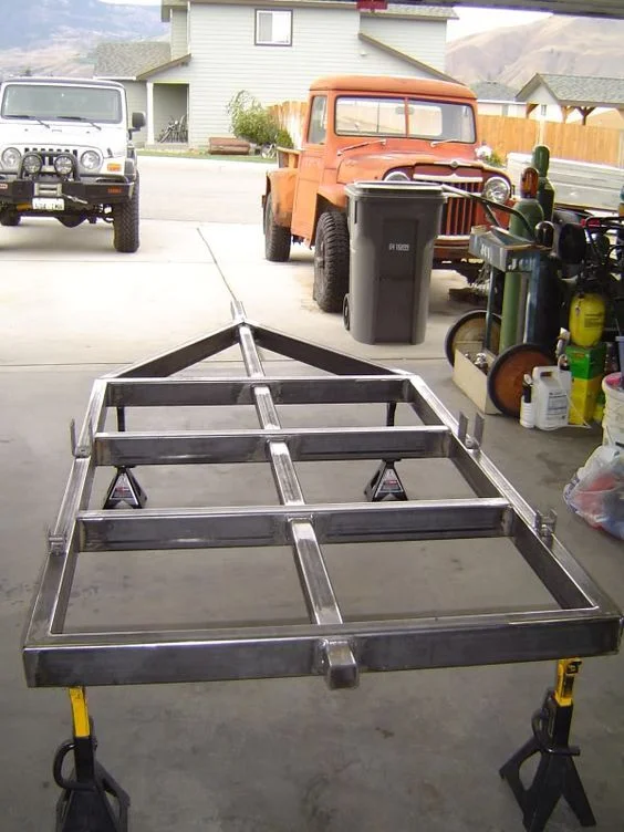

A lot of builds I've seen have a 2" (inside dimension) receiver tube run the whole length of the trailer from the A frame in the front all the way through the rear bumper. Then a long piece of very thick 2" stock slides through the front for the tongue with a couple 5/8 bolts holding it in. Then in the rear, you also have a very strong recovery point as well as an all purpose receiver for bike racks, cargo carriers, etc.
Attached is one example I've seen (photo from Google):
