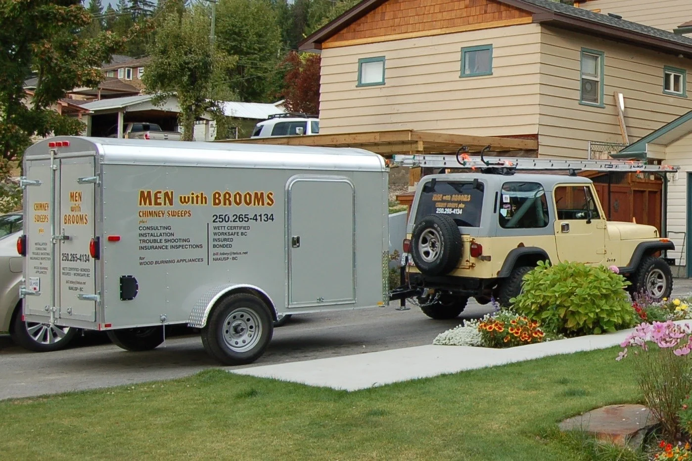

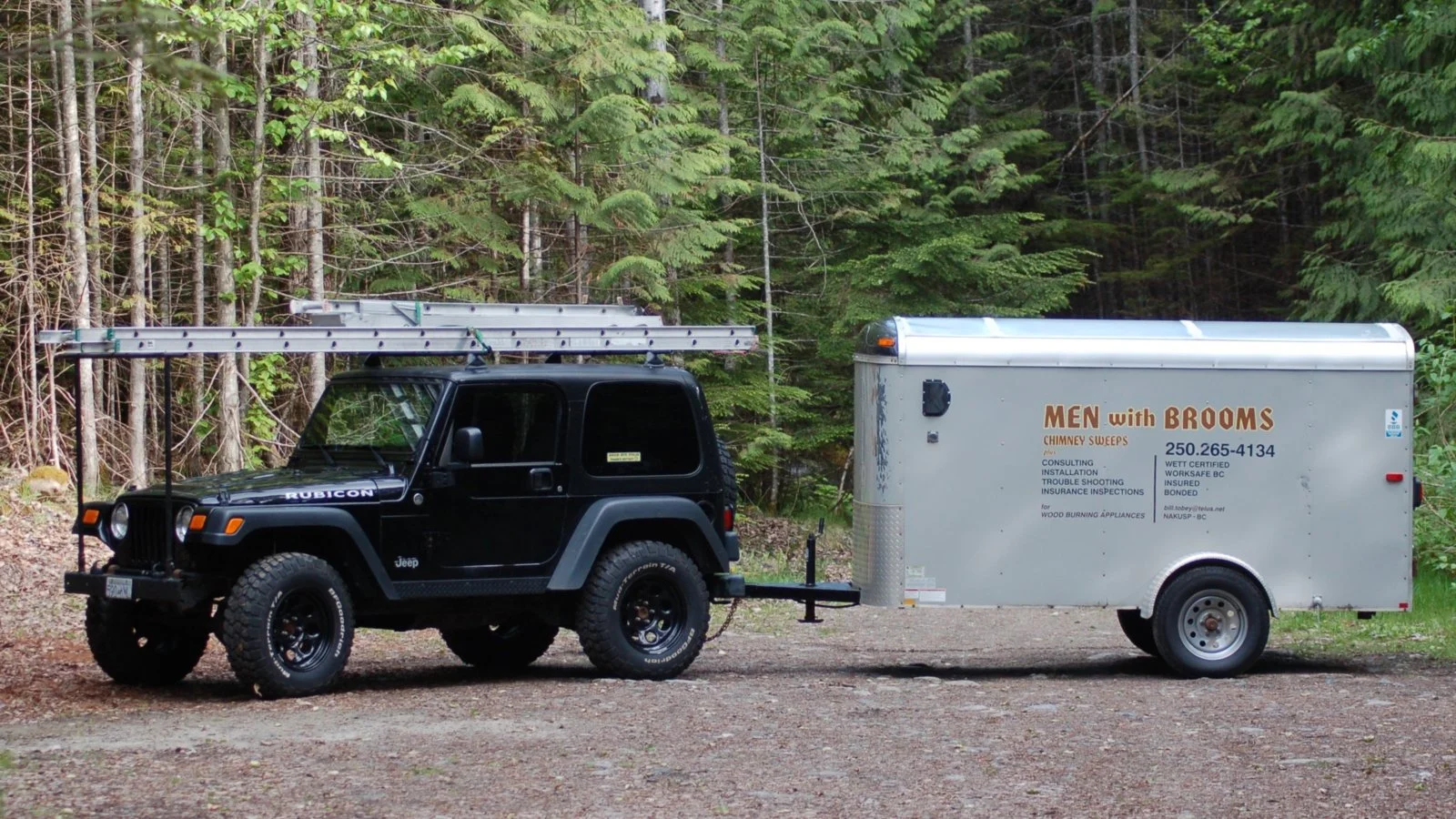

I tow a 5x10 Cargo trailer about 9000miles a year for work, barely know it is there. Right now, full of tools, it weighs 1900#. Been doing this for 7 years now. Best part about 5' wide is the stock mirrors see right past the trailer.
Altho this ^^^^^ is a Rubi with 4.10s and 33s... I also towed it with a YJ and 33s and 3.07s.... I NEVER felt short of power, I just dropped another gear. Anyone telling you 3.73 is a bad choice is speaking from an off road, extreme use only. 3.73 is one of the best, most versatile ratios around. The biggest factor, reason to go lower is not related to power at speed. It is starting from a stop and finding not enough lift. Like when a tire is tight to a rock, or curb, or log.
Anyone telling you 3.73 is a bad ratio is not much of a driver.
