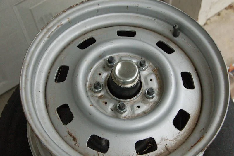

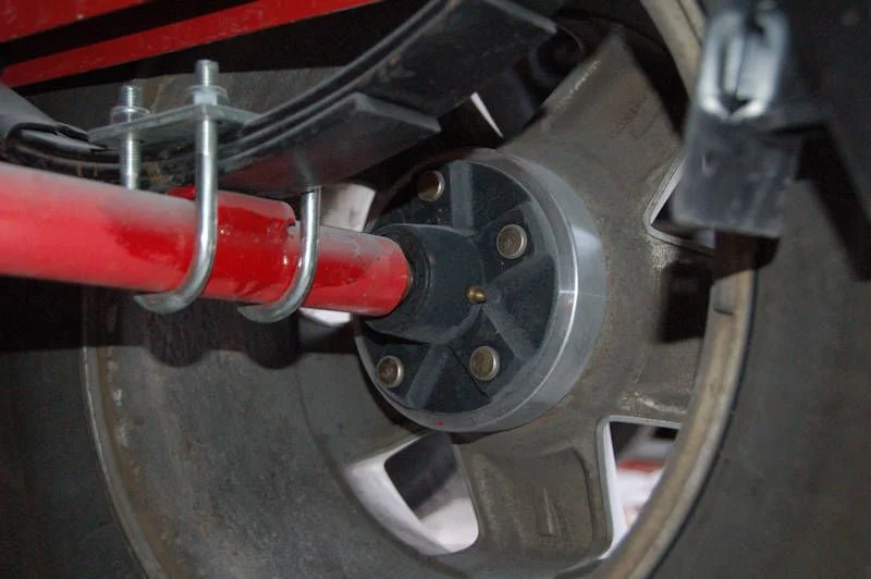

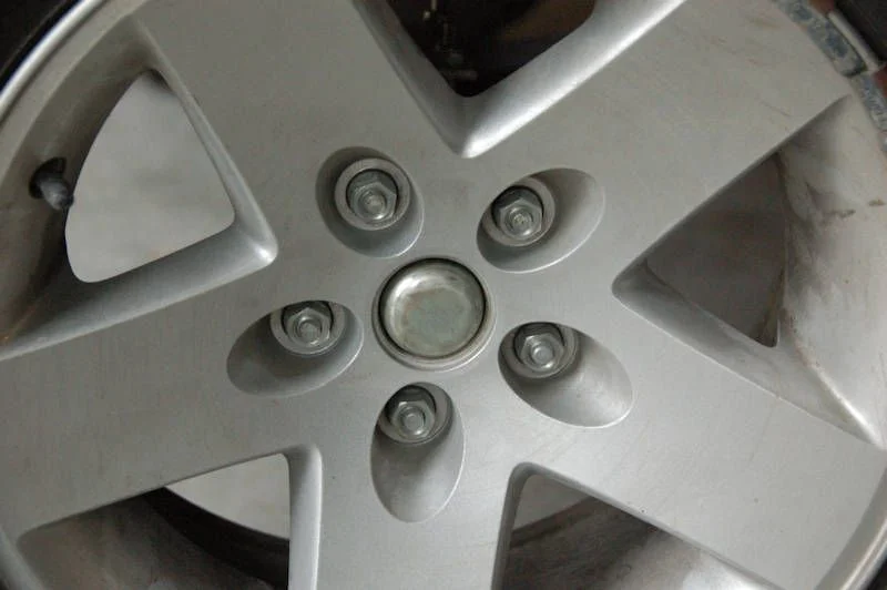

TJ factory alloy wheels have a roughly 1.8" center hole. TJ factory steel wheels have a center hole that's roughly 2.9" in diameter. Most trailer hubs are roughly 2.45" diameter, so allow wheels will require as spacer but factory Wrangler steel wheels will fit over a typical trailer hub.
Factory steel wheel on a trailer hub:
Alloy wheel with a spacer on a trailer hub:
Alloy wheel and a 1.25" thick spacer on a Harbor Freight frame/axle:

Can you still use the factory cap?
Not with a 1.25" thick spacer. You would probably need a 2" spacer to push the wheel out far enough so the cap would clear the trailer hub center cap, although I haven't measured so that's just a guess.
Reactions: Got4wd
I've used 2" spacers on 2 trailer builds and the factory caps will fit.
