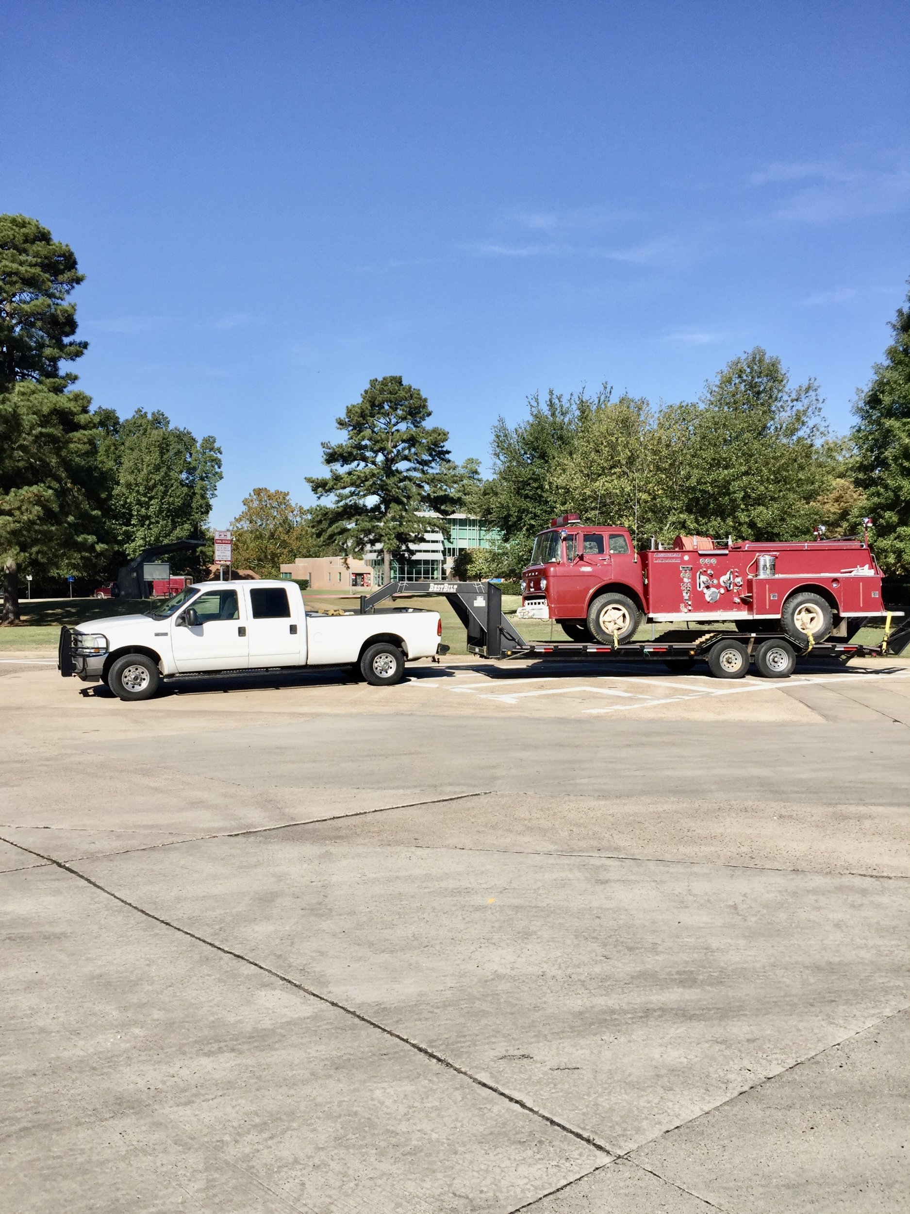

View attachment 663314 crossed the scales @ 27,200 prior to a 300+ mile run in the August heat in Texas
needless to say the drive over fenders were tested on this run

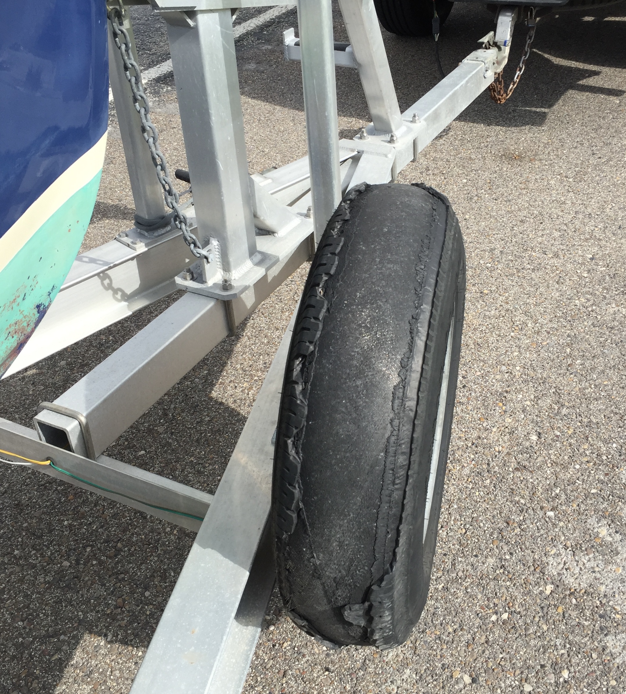

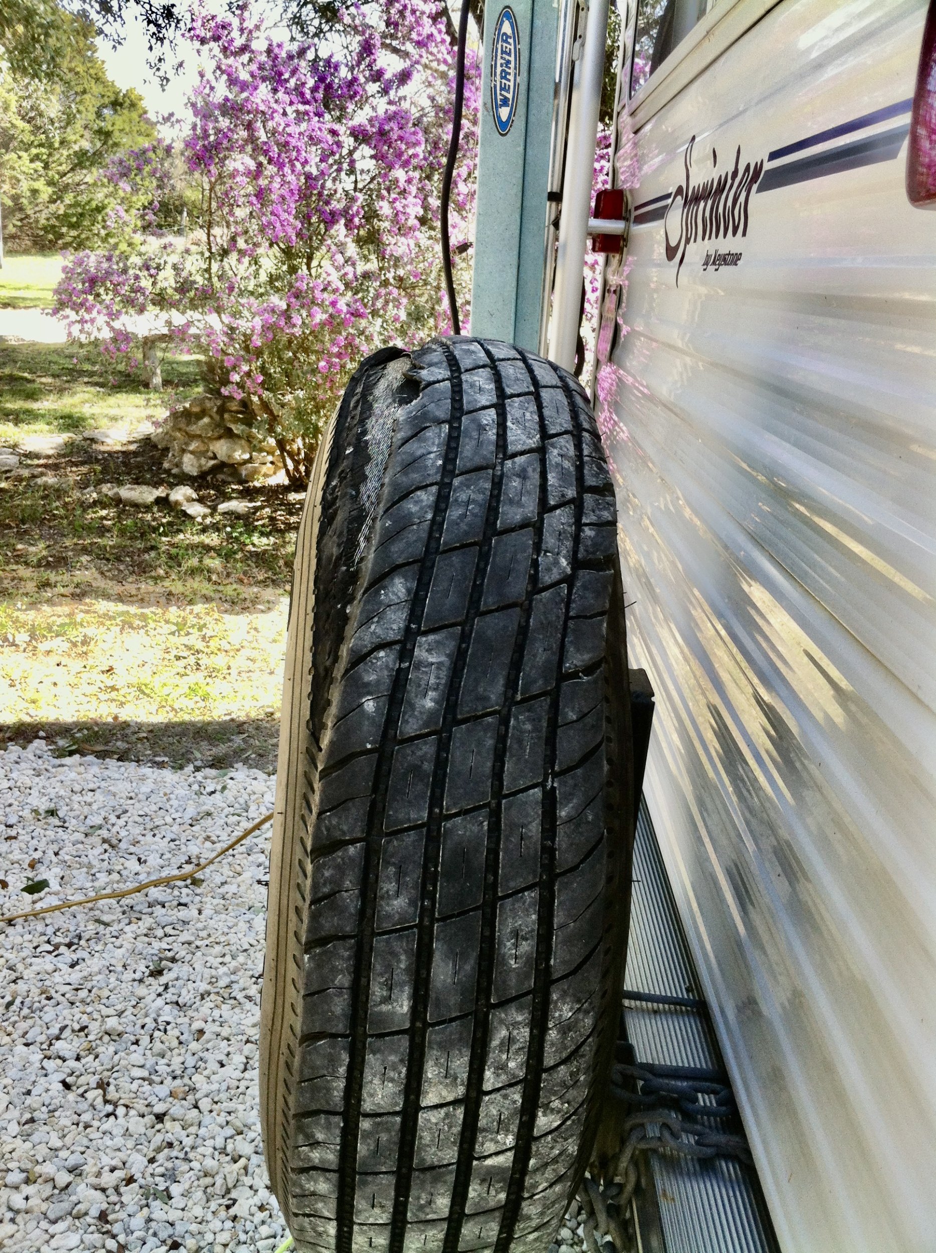

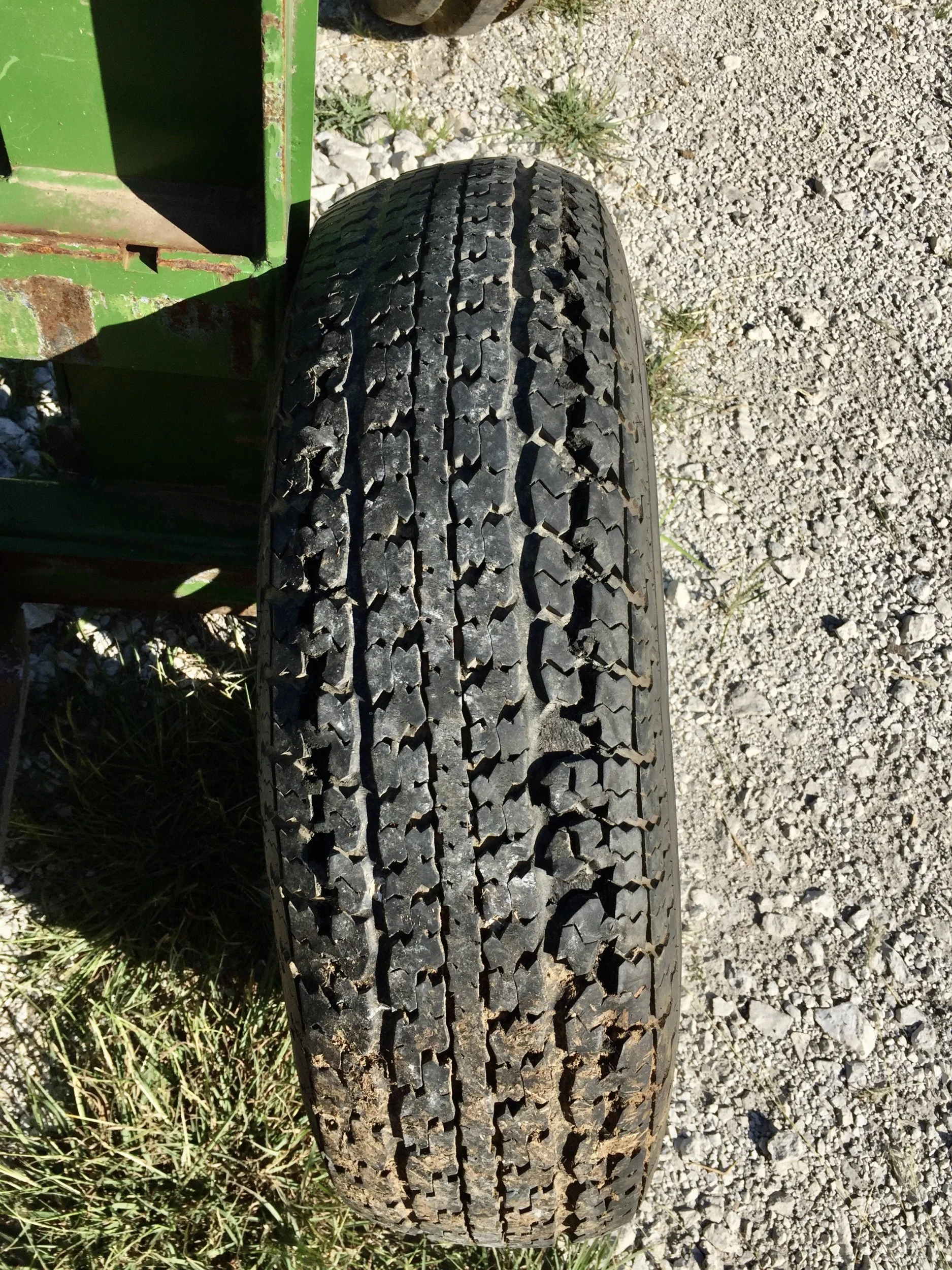

boat trailer n travel trailer n farm trailer tires
all 3 were date stamp'd @ 60 months ± 2 months
all 3 presented their true nature on trips
all 3 were checked prior to departure and aired according to sidewall instructions
all 3 were ST branded and installed by the manufacturer as THE RIGHT TIRE for the trailer
none of them were made on this continent though there is a rumor that there is one manufacturer here that does make ST tires i haven't seen any in person

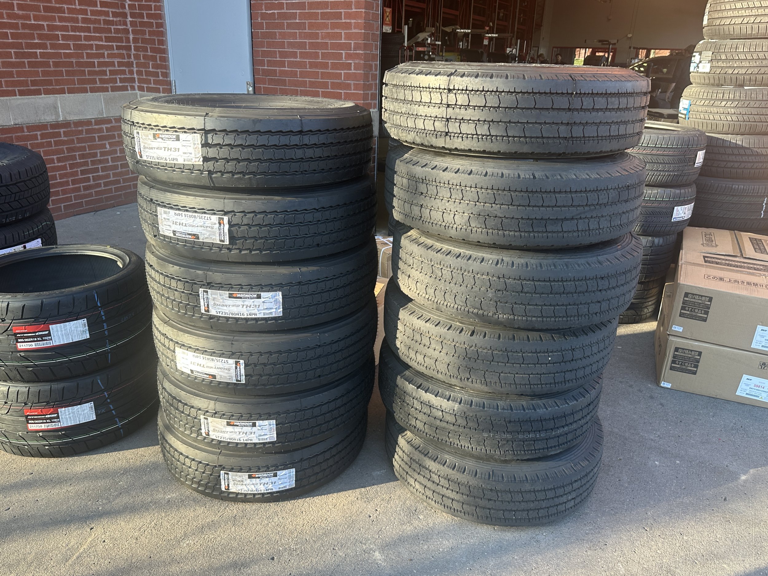

I received a lot of positive feedback on the Hankooks - largely confirming my original thoughts - so I pulled the trigger. Here they are at Discount Tire, stacked next to my China Bombs, and waiting to be mounted:
I wonder why the hankook stack isn't as tall. It's probably too late, but what's the weight difference of those tires, if any? I'm just wondering if one is significantly heavier. Maybe the china tires are extra stiff because they have extra material in the walls, which could be a compensation kind of thing. :unsure:
Reactions: Wildman
Not sure on the weight, Colt, but in the taller stack the Westlakes are mounted and inflated to 110, so there is that...
'Course, I'm being a bit of a wise ass. When I first saw them stacked together and took that pic, I thought the same thing. It wasn't until I got half way home that the light finally went on... 🙄
'Course, I'm being a bit of a wise ass. When I first saw them stacked together and took that pic, I thought the same thing. It wasn't until I got half way home when the light finally went off... 🙄
You would be correct sir. Mounted and inflated VS not is the difference.
