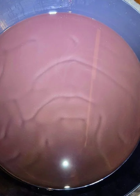

This is what I ended up draining out of that case.

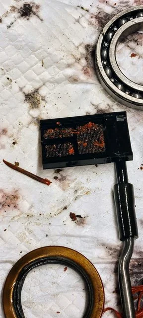

I rebuilt the case with a new planetary, new bearings, new chain, and new pump. Root cause was the last person who was in this case (not me!), when installing the SYE, had used way too much RTV - so the case was slowly starved of oil even though it was full.
I never thought to describe it as "swishy underwater" but going back and watching my own video versus yours, I think they sound about the same. In this video I had the case in neutral and the transmission in gear.
