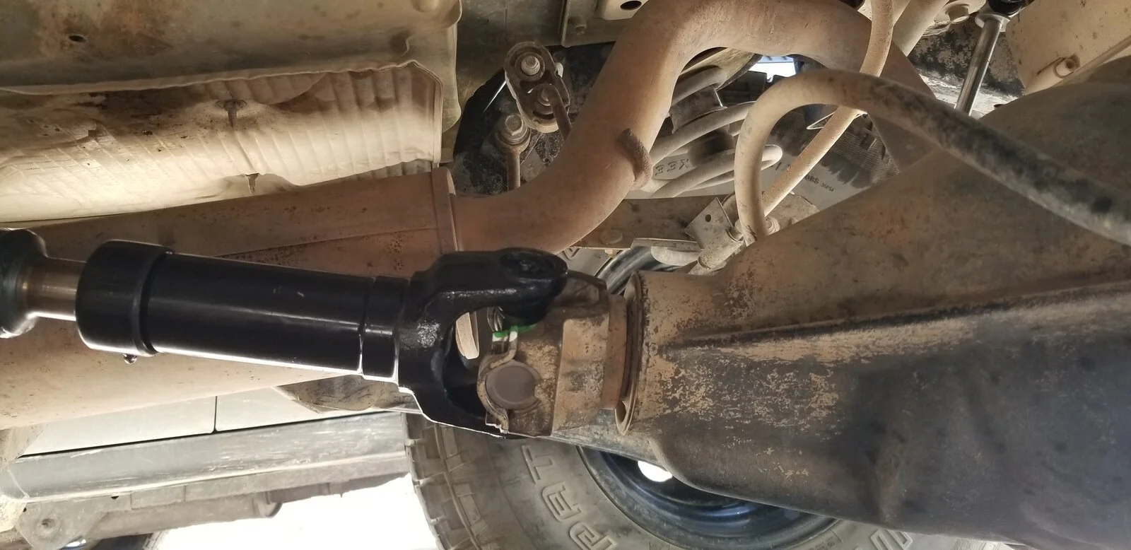

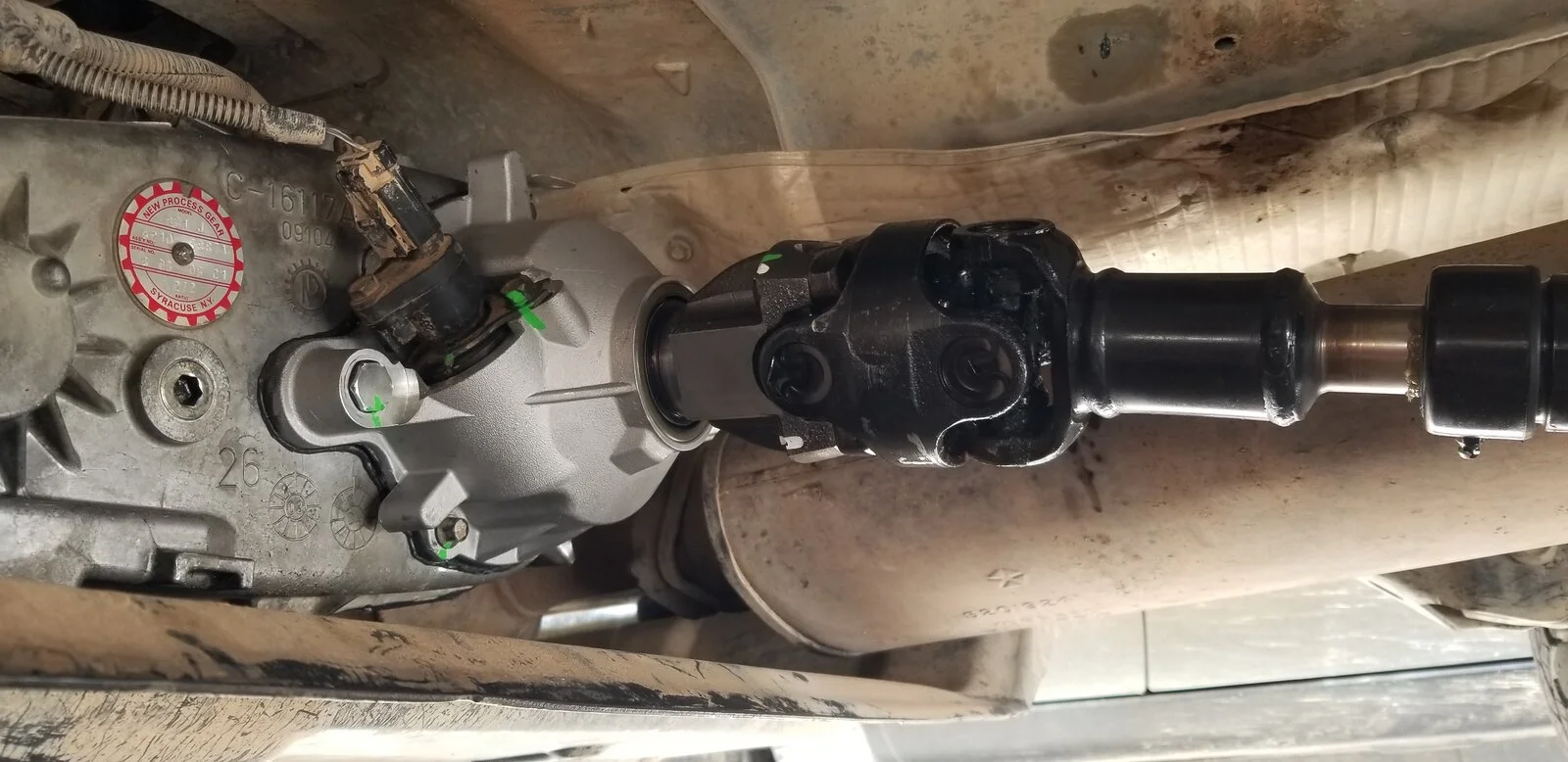

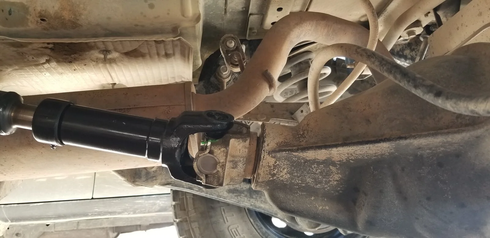

Transfer case pan raise after SYE?
Looks like it's already down slightly (pinion below drive shaft).
I am shopping around for adjustable upper control arms for the rear.
If I remove the 1" spacers from the skid plate that will raise the drive shaft and I would definitely need adjustable control arms then.

Any particular names I should look for when shopping for control arms?
Double adjustable arms (both ends move in and out) make dialing in pinion angles SO much easier because you don't need to remove the arm to adjust the length (just loosen the jam nuts and twist the arm). Also quality spherical joints at either end make you suspension articulate more freely (for example Currie Johnny Joints).
Reactions: RPDNLV and Rickyd
I saw the term "Johnny Joints" used on the Core 4X4 website. Didn't know what it was. Thank you for the information.
