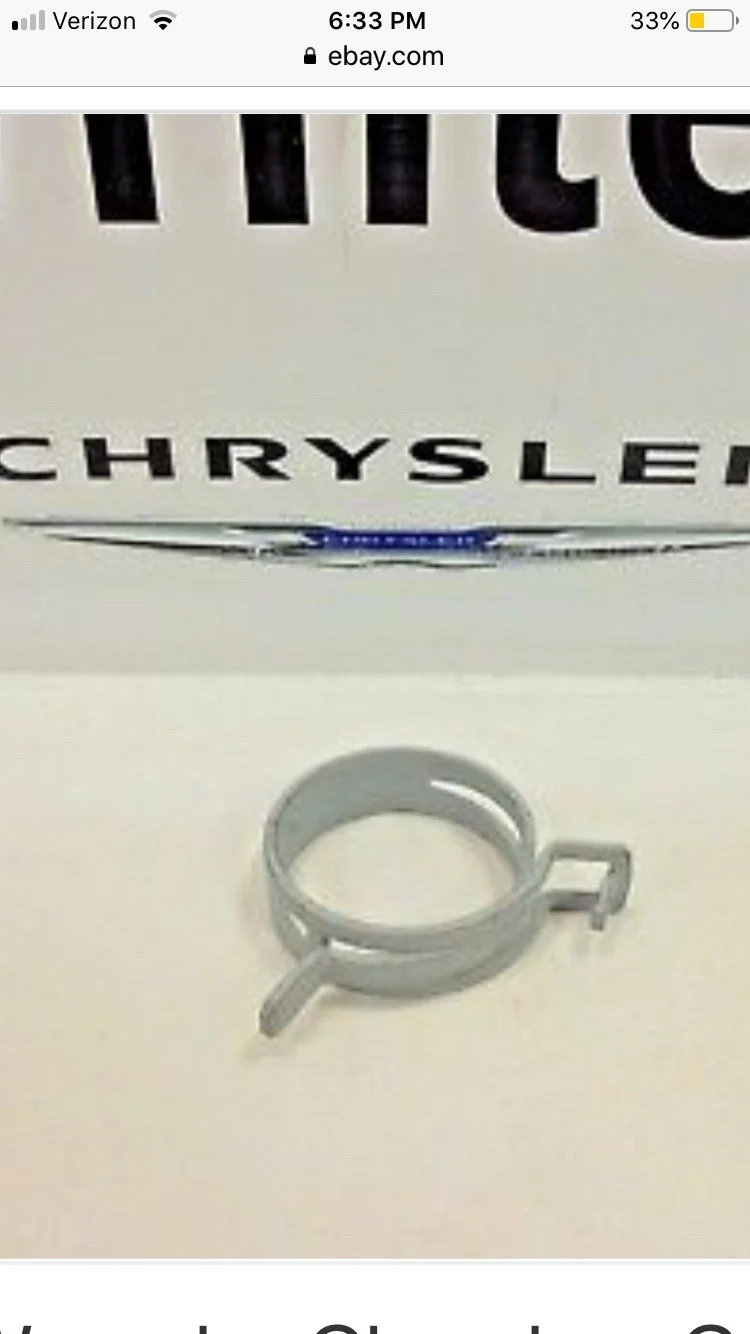

From what I could tell, it was held on by a pinch clamp, maybe that’s the problem? I’ll have to research more and make sure it’s the correct one.
Like this

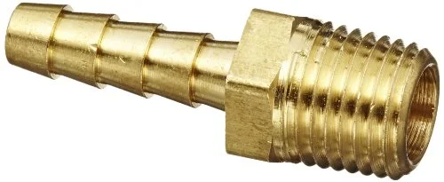

Our TJs used several connection ports through the years. If yours is threaded into the radiator, you can likely replace it with a barbed hose fitting you can get from Home Depot, hardware store, Lowe's etc. You wouldn't need a hose clamp with a barbed style though it wouldn't hurt. A constant tension hose clamp works better than the screw-drive hose clamps sold at auto parts stores but they're a little harder to find.
A barbed hose fitting like this one. That's what I used when I installed my aux trans cooler. It threads into some radiator cooler ports, not all.
I might do that. Mine looks like that but no barbs, just smoothe. It also has the hose clamp above which I believe is the constant tension one.
The factory port is not barbed, I was only suggesting you replace what's there with a barbed fitting, if possible, as an easier way to securely attach the replacement hose. It's possible to do this on some model years, not all. Not all radiator cooler ports are threaded so this can be done like my '97 was, hopefully it is on yours.

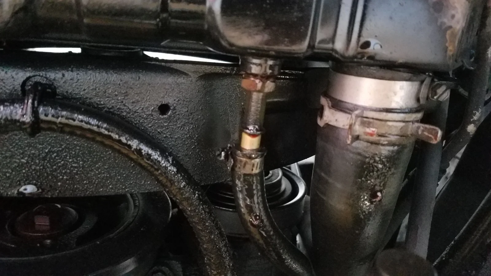

I had the same thing happen to me the other day while driving...little scary to look up and see nothing but smoke behind you! I don't believe the previous owner had one of the lines on very well as you can see he didn't have the line over the lip on the fitting since it's so dirty.
Coincidently I was planning on replacing the transmission fluid anyway so luckily it didn't lose it all and it saved me some time pumping it out.
I had it towed home and replaced both hoses and fittings.
