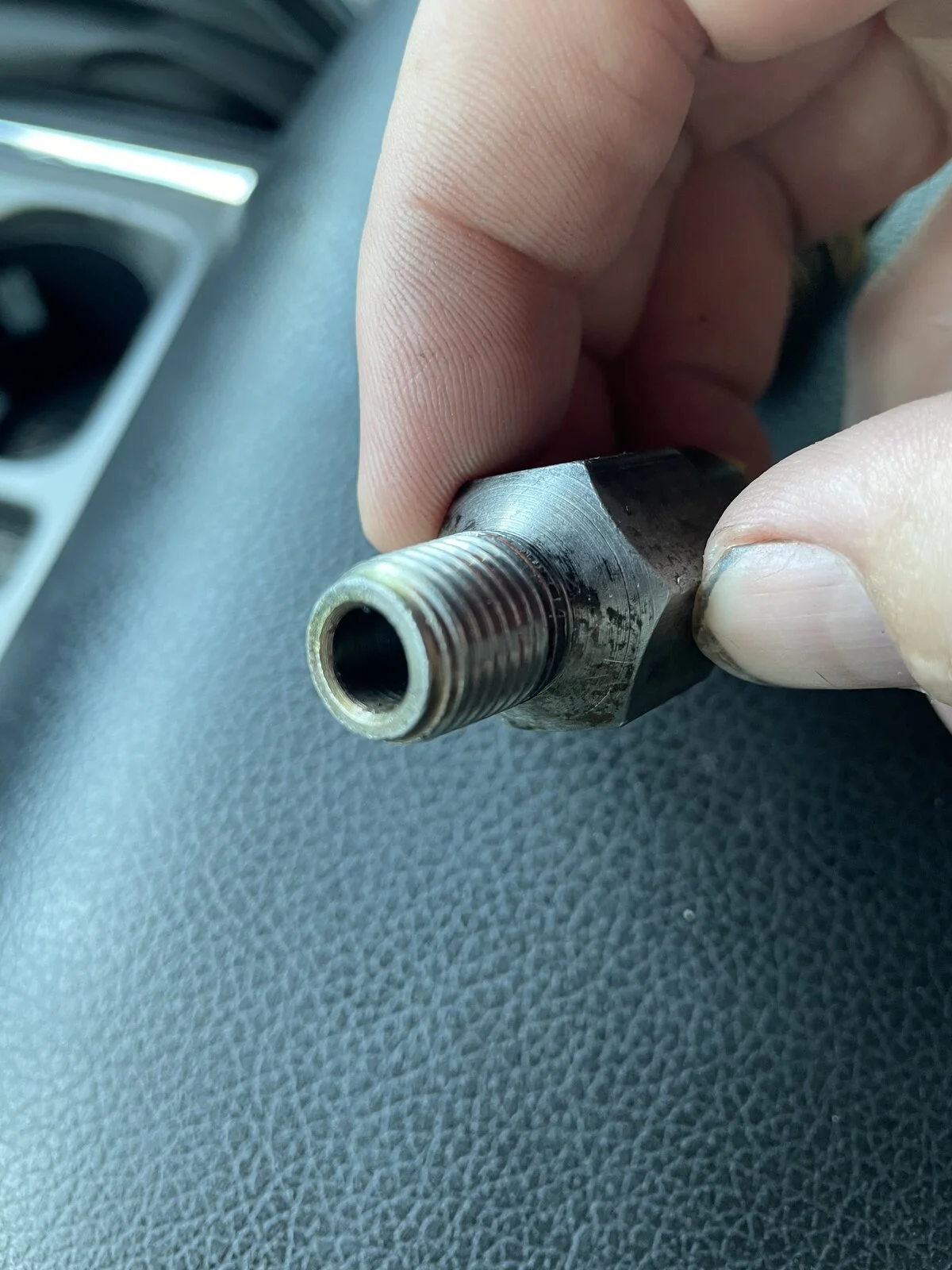

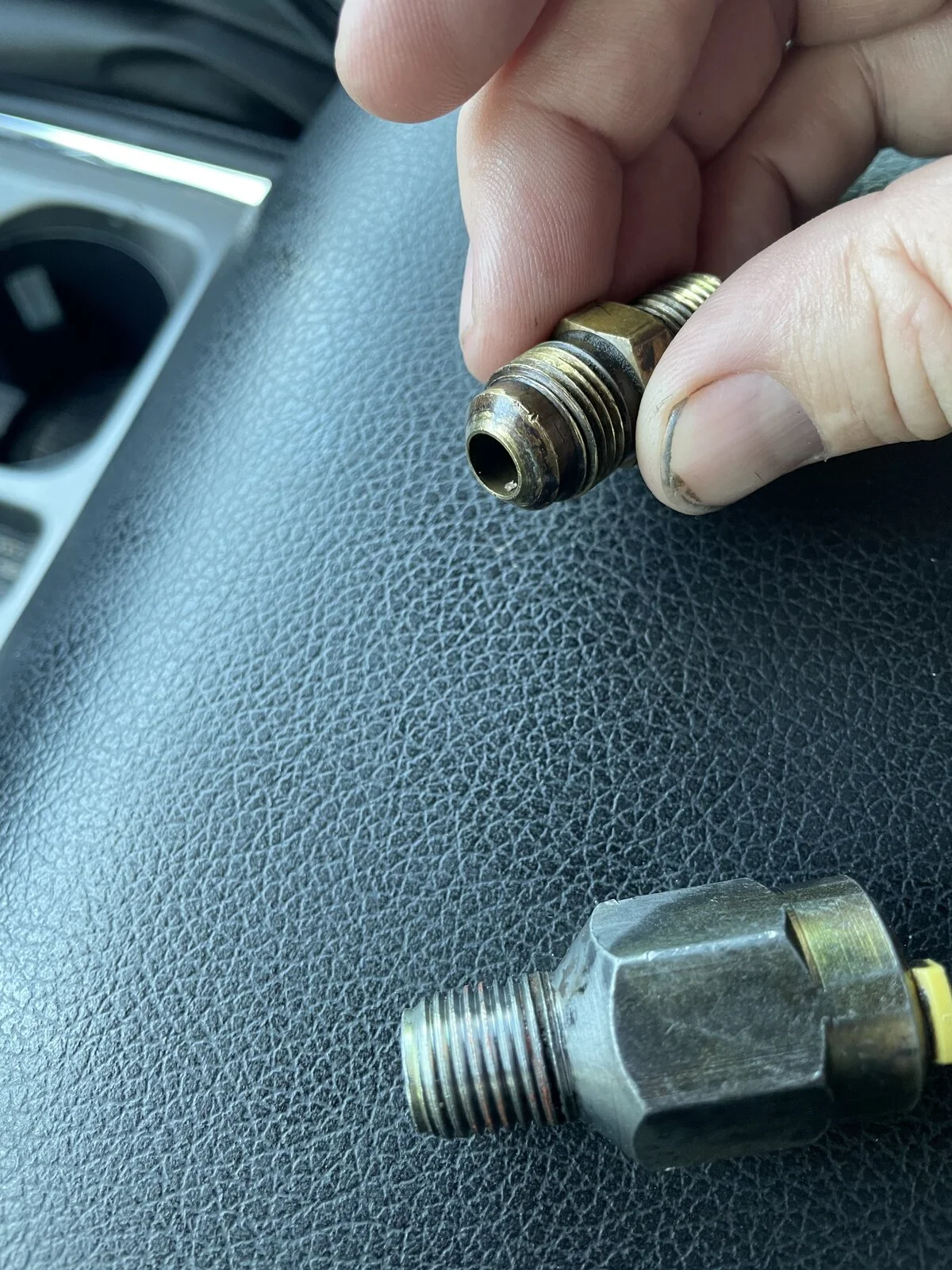

Can anyone help me understand these fittings, what type they are etc?
One fitting threads on both ends. The side that goes into the trans appears to be flared and threads into the 3/8” flare size on the wall at Home Depot.
The other side of that fitting threads into the 1/4” “brass pipe fitting” on the wall at Home Depot.
The other fitting has the quick connect on one side and the other side also fits into the 1/4” brass pipe fitting at Home Depot.
The flare is obviously a flare fitting (is that the same as AN?), but what are the other ones? Are they NPT? Or something else?
Educate me, please.

The top picture is a 3/8" flare x 1/4" MNPT. Compared to AN, the angles are both 37 degrees but the flare threads are slightly different. The AN fittings use a 3A thread class and the SAE flare uses the 2A thread class.
Unified threads come in three different classes:
1A (external) & 1B (internal): for applications where a liberal tolerance is required to permit easy assembly even with slightly nicked threads.
2A (external) & 2B (internal): most commonly used class for general applications.
3A (external) & 3B (internal): for applications where closeness of fit and/or accuracy of thread elements are important.
Here's an article that goes into the history and explains the AN and flare differences:
https://www.mfcp.com/our-blog/an-jic-37-flare-fittings
The pipe threads on the other fittings are NPT (National Pipe Tapered).
