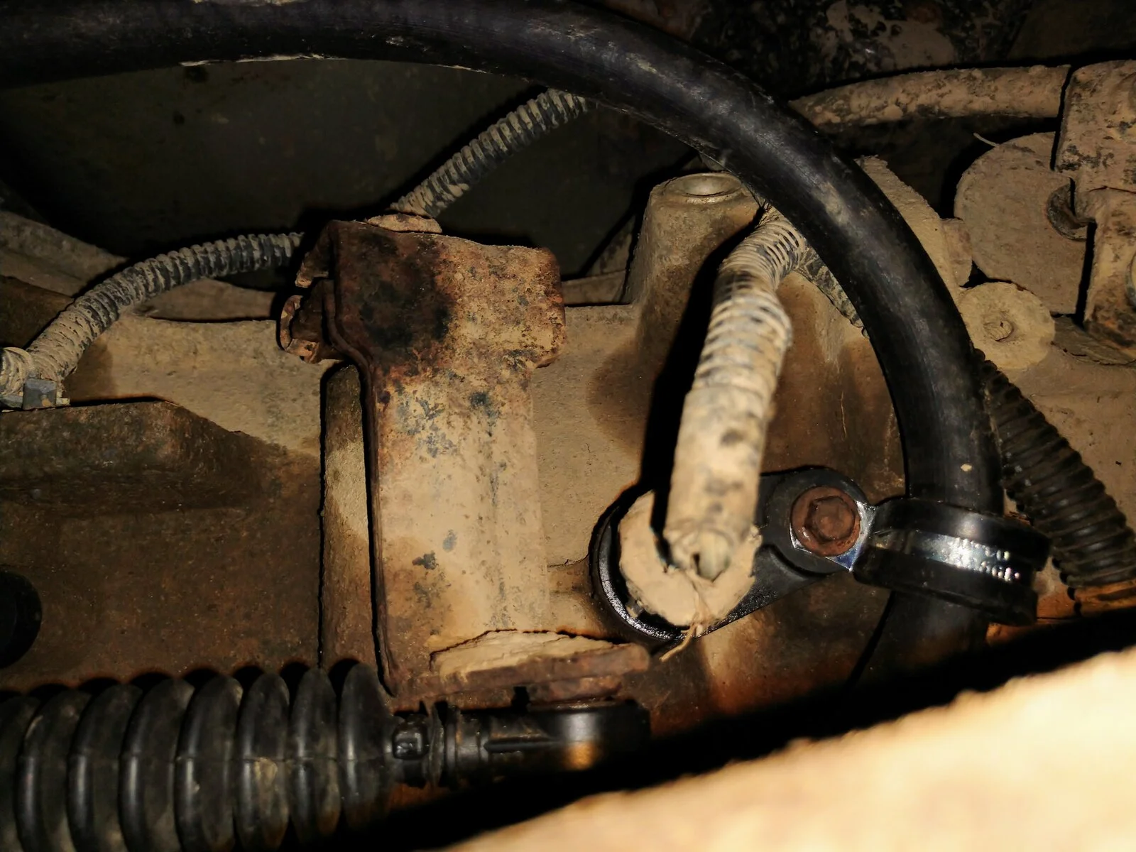

Well looking back at some pictures I forgot that the the kinked line ended up leaking from the transmission fitting after I tried to unkink it. That required a new type of fitting, I was very happy to find out it wasn't some kind of Chrysler special thread only, just regular pipe thread but can't recall if American or metric (if that is even available here)
Here's the kink

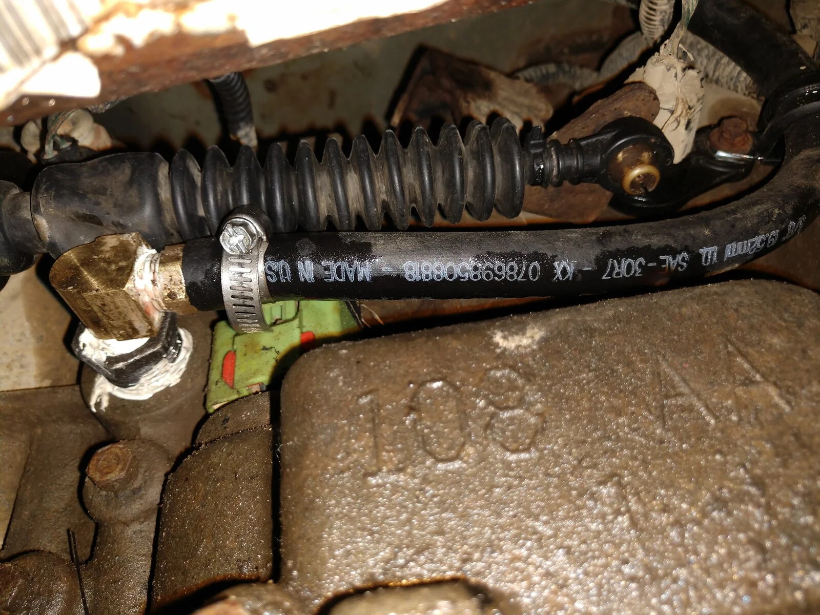

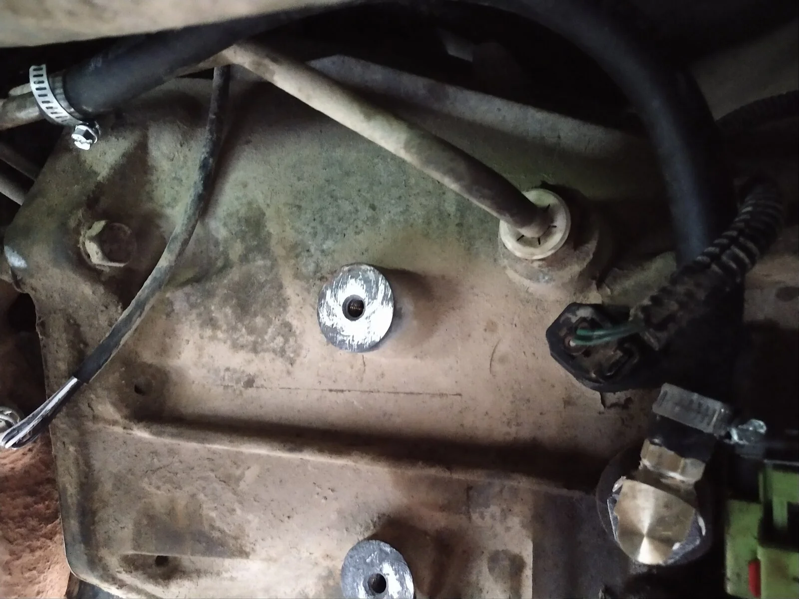

New pipe fittings beside the original:

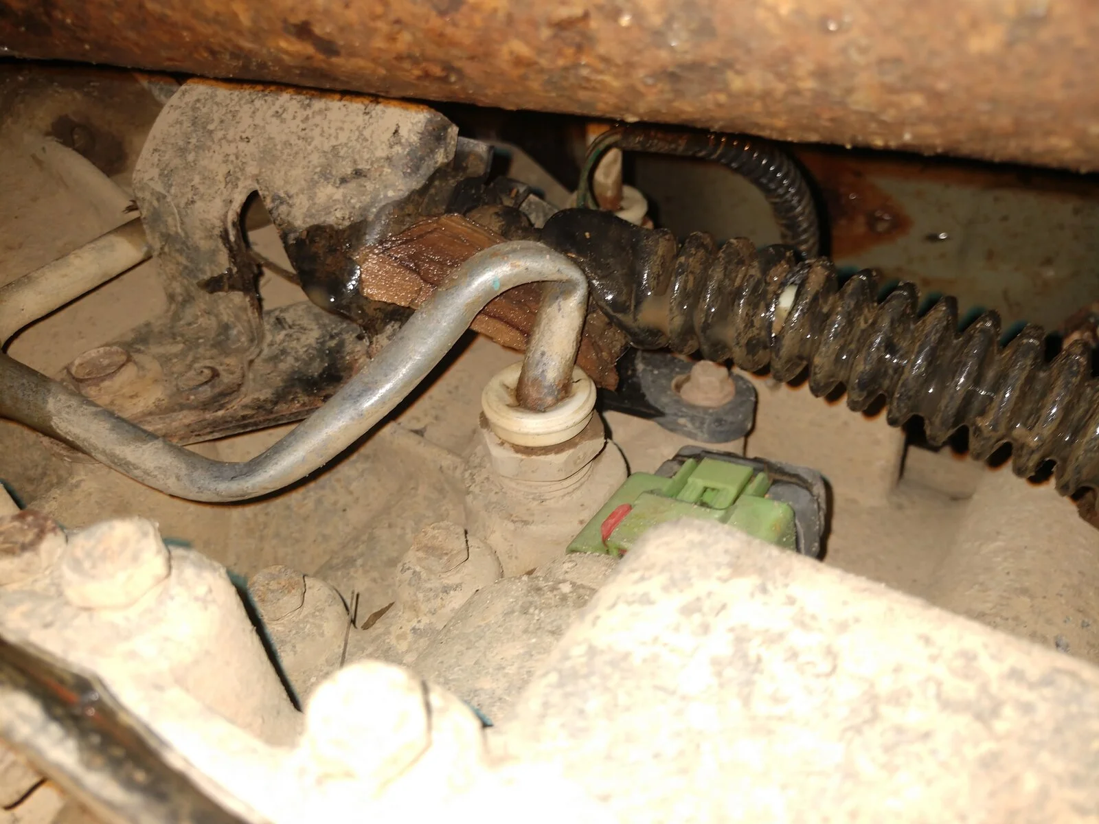

Here's the first line I tried before the shifter cable bracket was put back on.
This is my longer hose which starts out aimed toward the rear of the Jeep to get around that shifter cable without going under the bracket.
Here the hose goes through a hose routing clamp while looping back towards the front.
Those pictures all show the fuel line before I added the second clamps which didn't help until the hose was replaced with Gates 8005278
