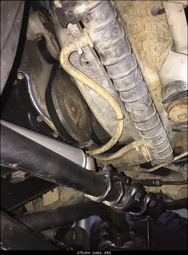

I have a 2000 wrangler sport 4.0 automatic transmission my line is leaking from the rubber hose from the radiator I think maybe more places my question is would u replace both lines since it’s 24 years old a be done with it
Wipe the area thoroughly and use a bright light to determine whether the rubber line, fitting or radiator bung is leaking. If you determine you need to replace one rubber line; I would suggest you replace both lines.
