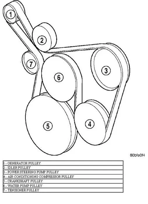

I have an 06 Tj. Today when I started the engine there was a loud whining noise, similar to dragging a metal legged chair Across a hard floor. Only happened until 25ish MPH then went away after the engine came to temp. Any ideas?
Hi, @Jafriskey and welcome to the forum!
It's generally considered preferable to start a new thread rather than posting in a new question on someone else's. That said, there are lots of places such a noise could be coming from but, if it began when you started the engine and before you placed the Jeep in gear, I'm betting on a bearing in an idler (there are two) or the alternator, power steering pump, A/C compressor, or water pump. EDIT: I should have said "serpentine belt idler" to be more specific. There is a simple idler that is bolted to the block (#2 in diagram) and does not move (other than rotating) and a tensioner idler (# 7) that is spring loaded and does move, in order to keep the belt tight...a bearing going out in either can cause a horrid racket, as can a failing bearing in the other parts I mentioned.
1) Has it done it more than once or is this a new thing that you have not, as yet, had repeat?
2) Did you feel any changes in vehicle behavior (power loss, steering issues, etc.)?
If it does it again (if it's a bearing, it will), open the hood and try to isolate at least the general area it's coming from. This will give us a lot better idea of possible sources.
