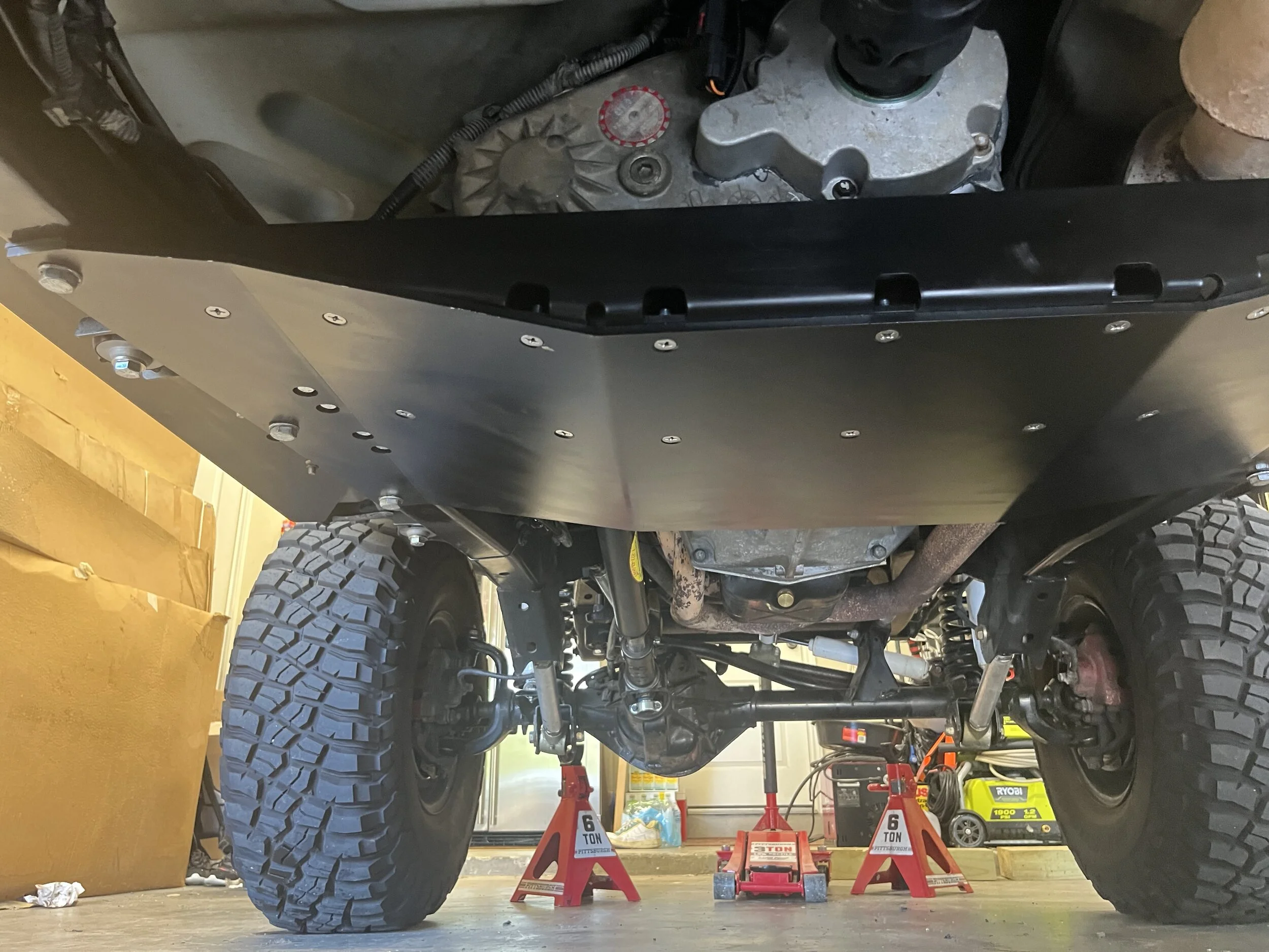

Trouble with MML bolts, Savvy BL and Under Armor Skid
new holes in fan shroud and test drive done. Zero vibes and 2 degree difference drive shaft to pinion. I wanted 1, might do a touch more, but uppers are pretty extended.

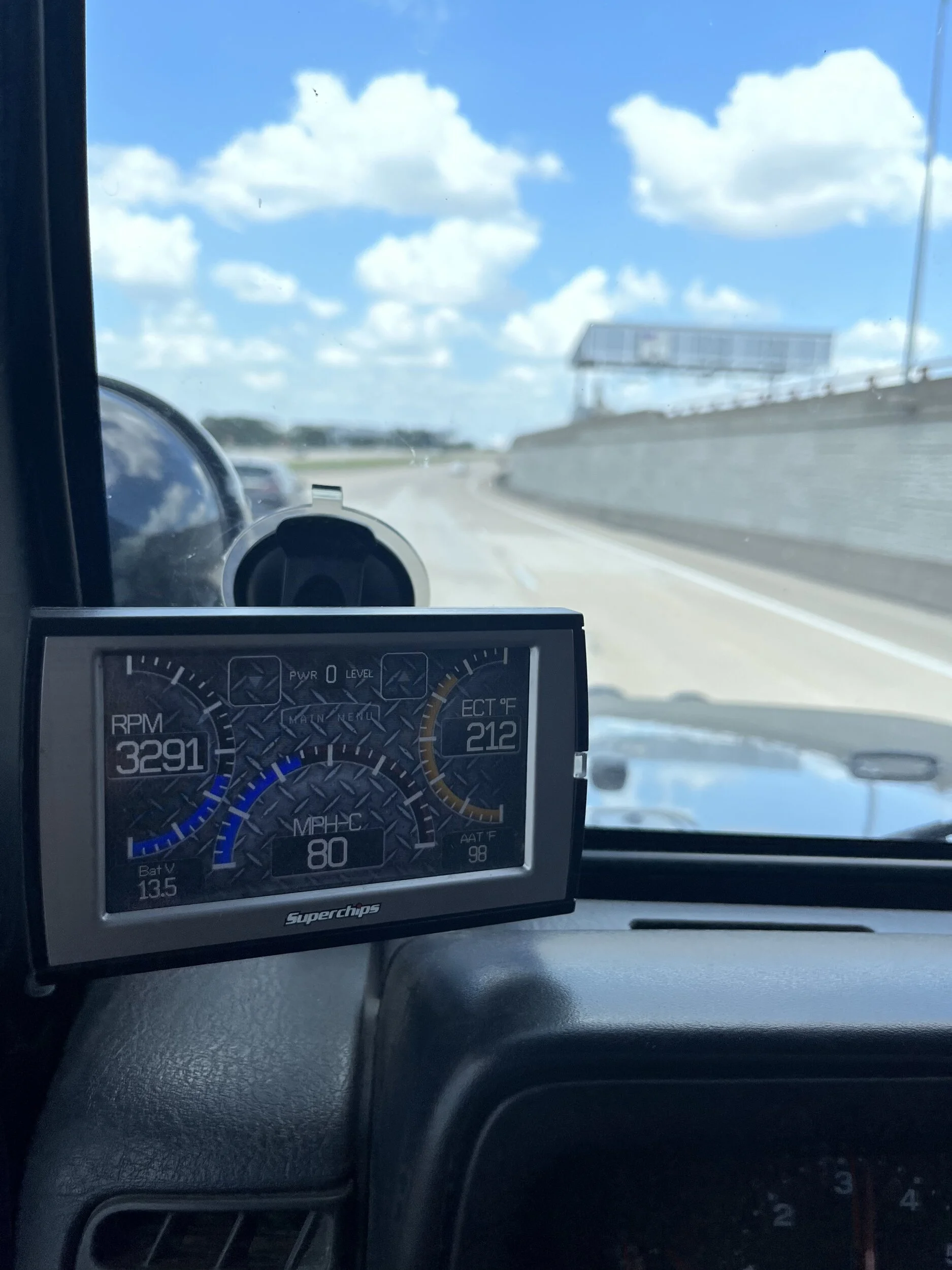

Texas Toll roads. Hit 83 downhill not trying.
Cruise 75 with traffic (speed limit) and 80 easy. Super happy so far.
Skid all on, was super straight forward, and used Blue loctite.

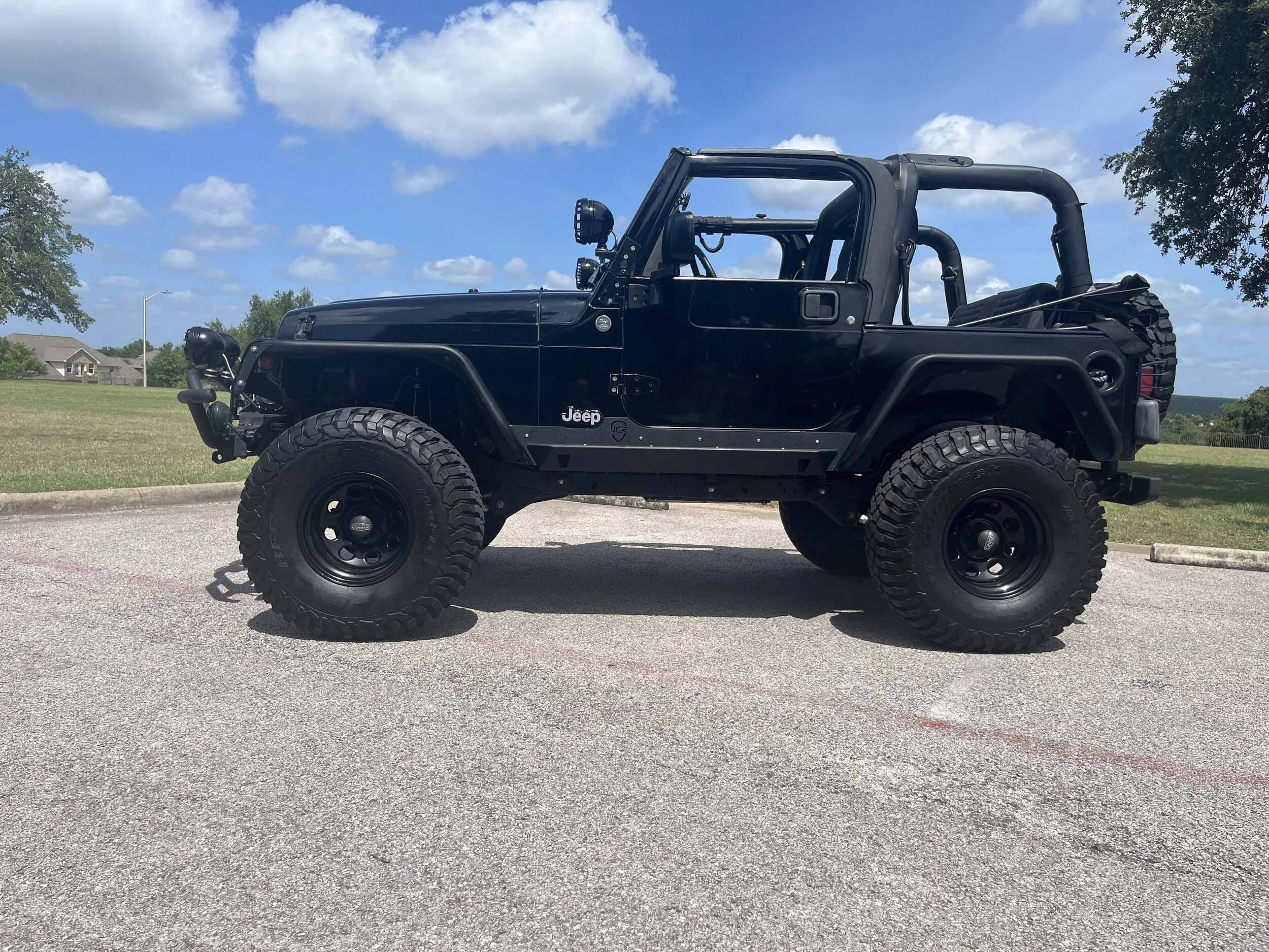

Front DS in, took a cruise and it drives like a stock TJ on the highway.
I’m super stunned this didn’t have some major hiccup.

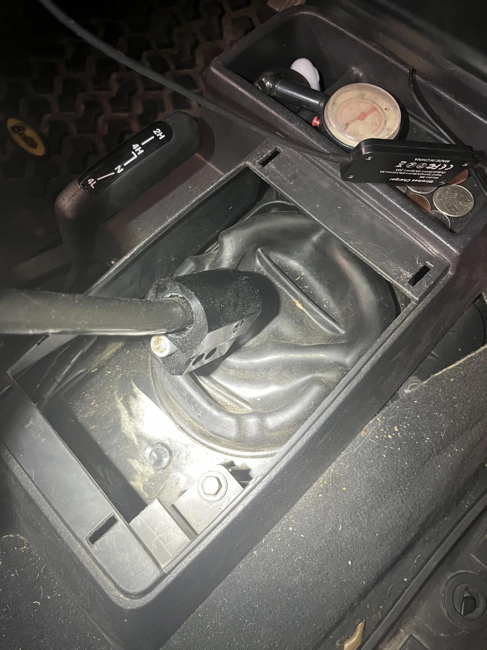

Much better, no more bump agaisnt the console, heck it was even hitting the back of that lower boot before.
I knew the shifter would fall back to center with the tuck. Figured the fan would rub the shroud too. Good job. You’re almost there. That rear pinion looks low unless you’ve already adjusted it. My guess is you’ll run around 22*.
Edit: oops, I missed the last few posts. Congrats! Doesn’t it look so sexy?!
