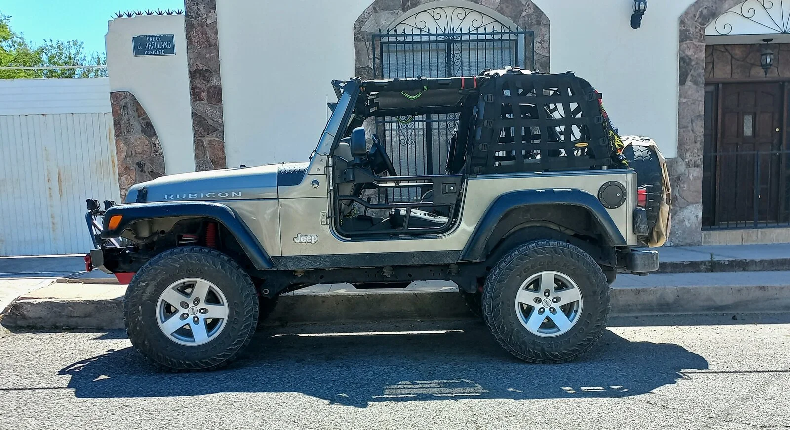

Tummy tuck before and after..... A gain of 2 7/16 inches.. I used the Rough Country ultra high clearance skid plate.. I know, I know... RC is bad and made of Chineseium... And I do KNOW that there are other skid plates that would have gave me more clearance... But it was on sale on 170 bucks so it was an offer that I couldn't resist... Its a 1/4 inch steel plate at the end.... Totally happy about it...

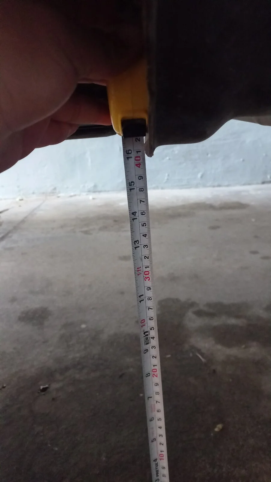

Distance from the Floor to the lower hanging part of the OEM shovel... 15 7/8s

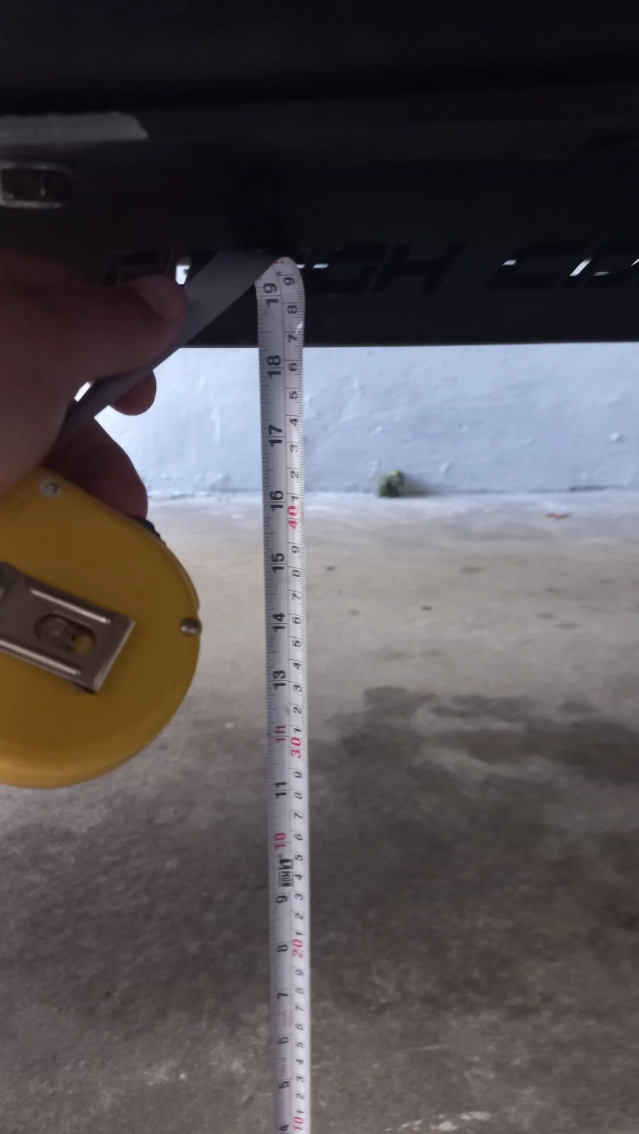

Distance from the Floor to the lower hanging part of the RC skid plate... 18 5/16

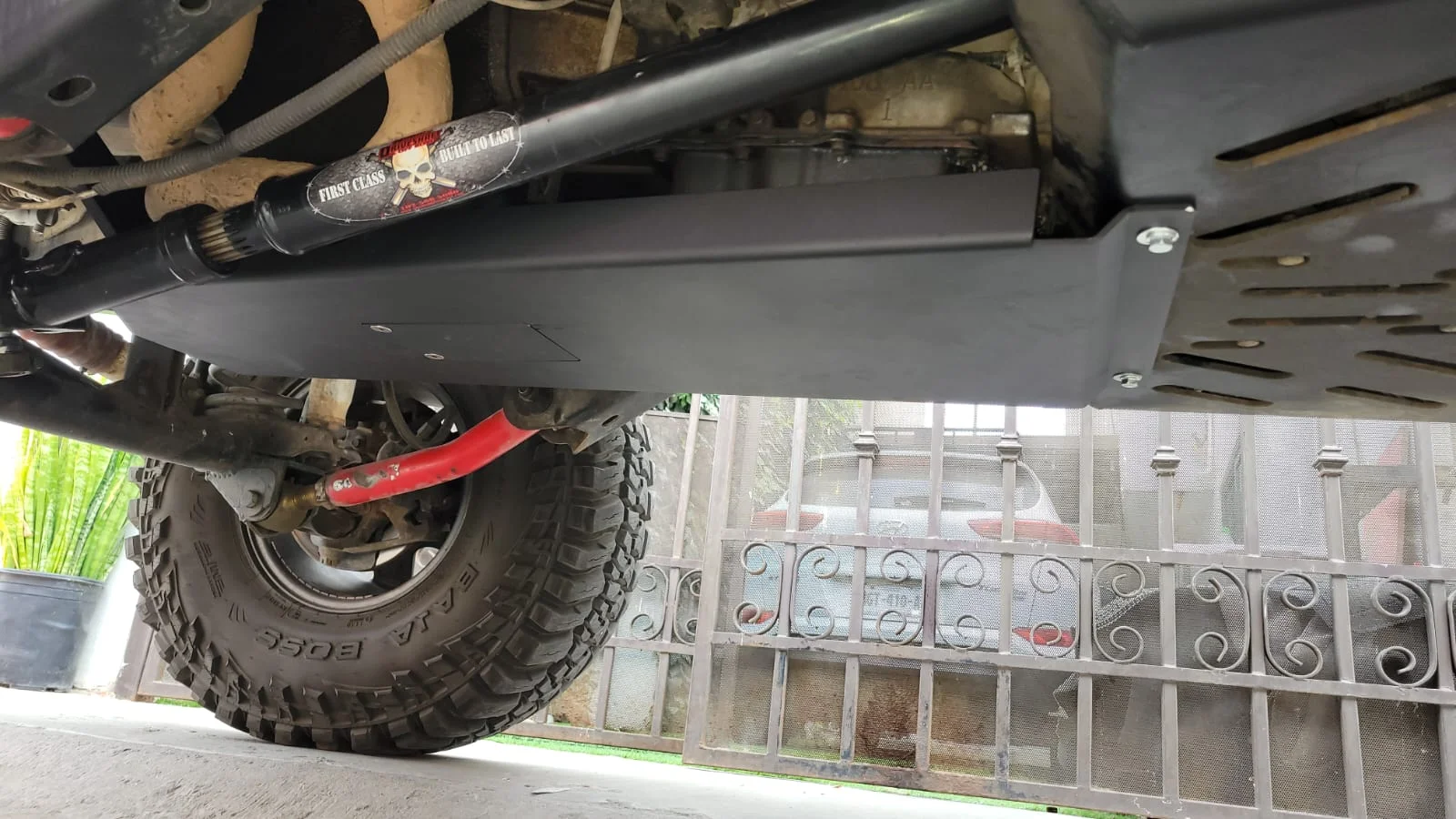

As promised..... I was looking to protect my auto tranny oil pan and the OEM for my 06 rubi is no longer a good fit once the tummy tuck was performed, since I dont wheel a lot in the rocks and 2 babies are comming in a few months.... I tried to save as much dollars as I could.... so I modified my OEM auto tranny skid to fit into the tummy tuck.... the shop charged me 30 bucks (here in Mexico those kind of jobs are pretty cheap) and is now protected and lifted... does it looks pretty as a UFC or teraflex skid plate? hell no! but its only for protecting the automatic transmission of my rig for any rocks.... so I can live with the ugliness as long as it protects my jeep.....
if anyone wonders why is a bent arm bolted in the driver's side instead of the flat section in the passenger's, is because once you lift the rig and flex it... the front driveshaft will grind with the OEM skid plate.... so it was part of the DIY design to avoid this grinding situation and keeping the tummy tuck as flat as possible...

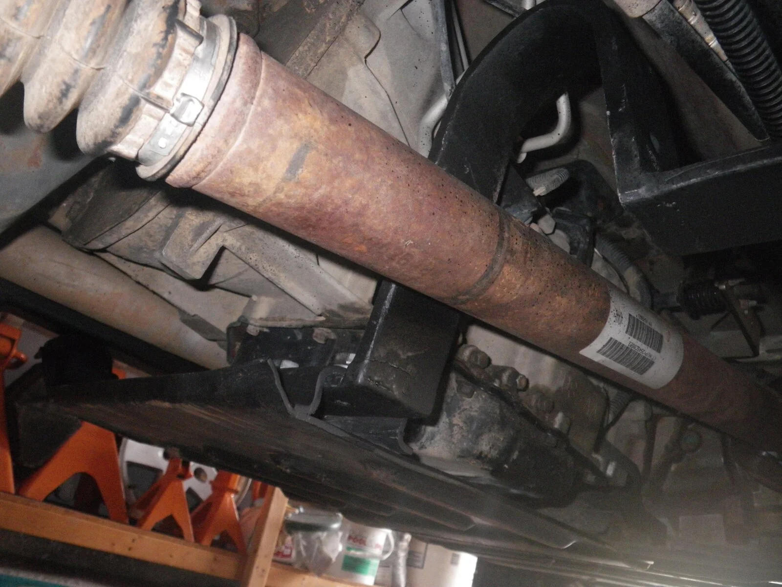

I ran mine modified for a long time before my tummy tuck.
Instead of under, I went over the top.

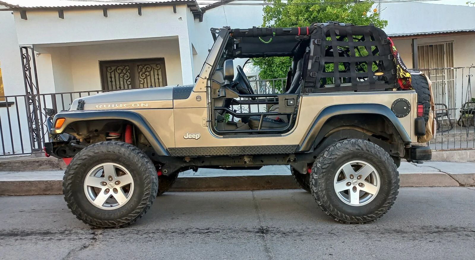

and last.... a picture of how the rig looks like once the TT was finished including the automatic transmission skid plate.....
