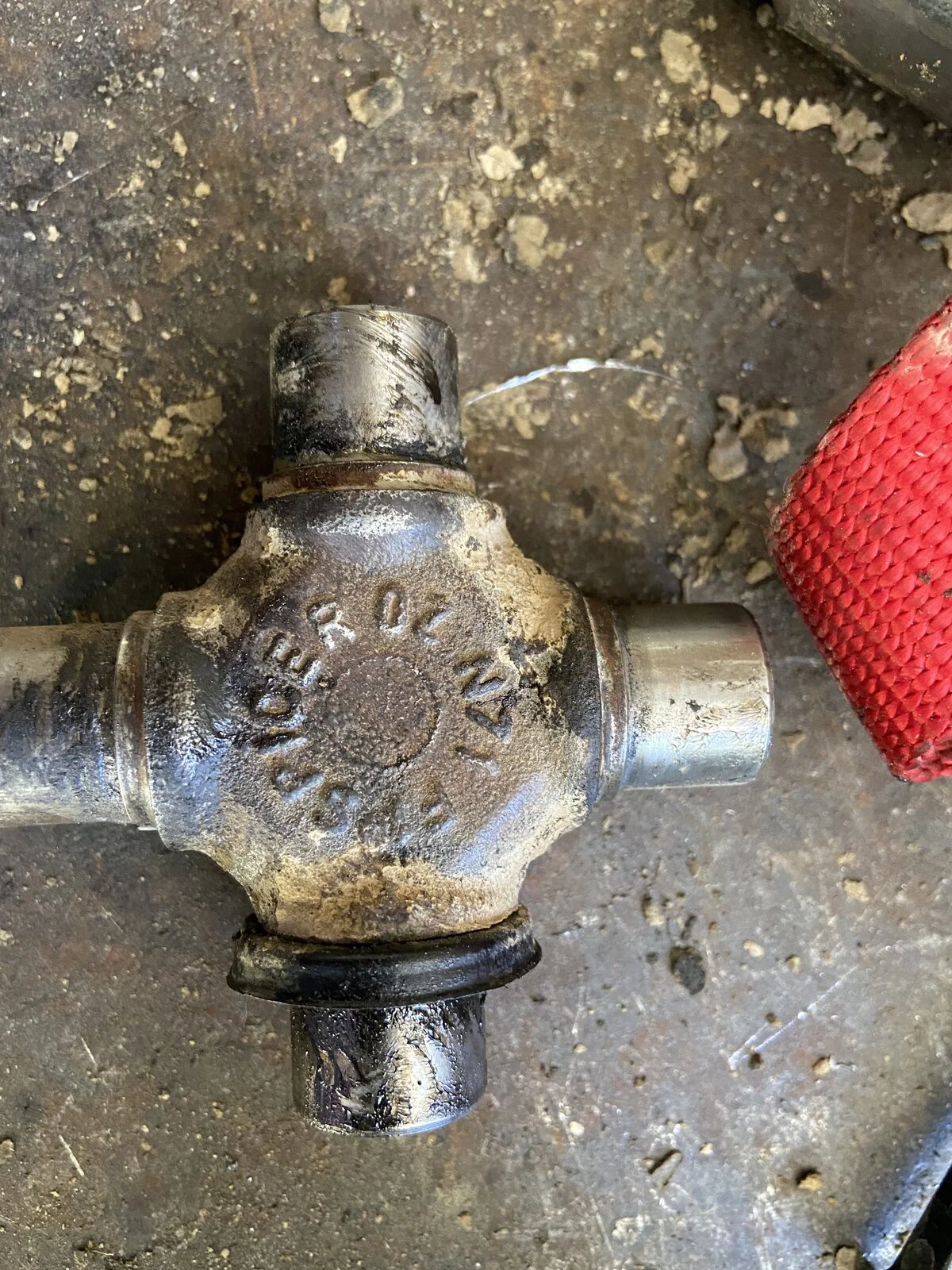

This is a pic of the ujoint that was on my 2005 TJ front axle.
I cant seem to be able to correctly identify the part number.
Can anybody help?
Thanks
DANA SPICER 5-760X Front Axle U-joint.
"Two front axle shaft u-joints:
The factory u-joint on standard (non Rubicon models) is a Spicer 5-297. A highly recommended upgrade is the Spicer 5-760x u-joint which was specially designed for the Rubicon at Jeep's request.
Driveshaft u-joints:
The stock driveshaft u-joints are Spicer 1310. There are three u-joints up front and two in the rear. A highly recommended upgrade is the Spicer 5-1310x which is sealed, as well as a stronger and more durable directly replacement upgrade for the standard Spicer 1310 size u-joint."
