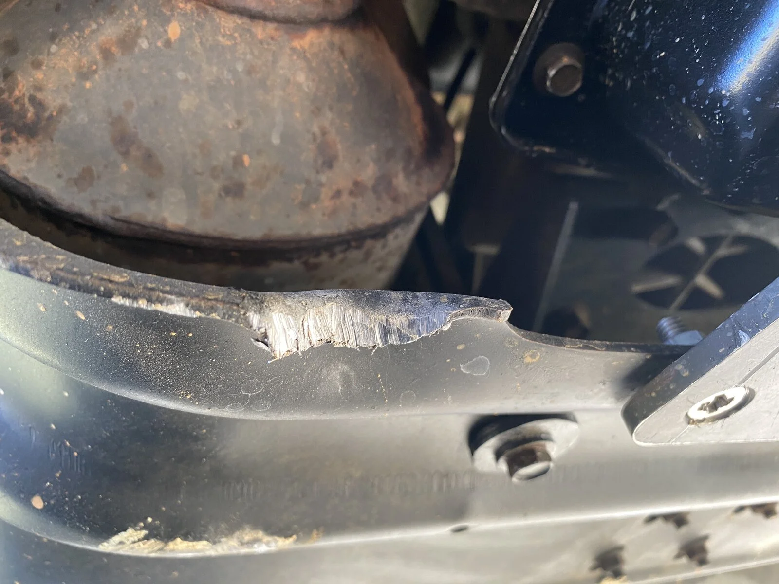

With a simple skid remember weight is strength, if you never bent stock don't worry. If you did beware. What I've learned over the years is most people don't hit their skids much or as hard as I do. The UCF skid ain't one of Blaine's designs that leverages aluminum, it's just the steel one in a different color.

I have put a bend in the OEM one. There was a rock sticking up like a shark fin that I didn’t see. It’s the only time I’ve hit it like that. I’ve slid the skid a lot, and I’m sure the flat Barnes would be better at that than the OEM rippled one.
