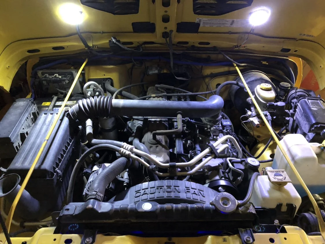

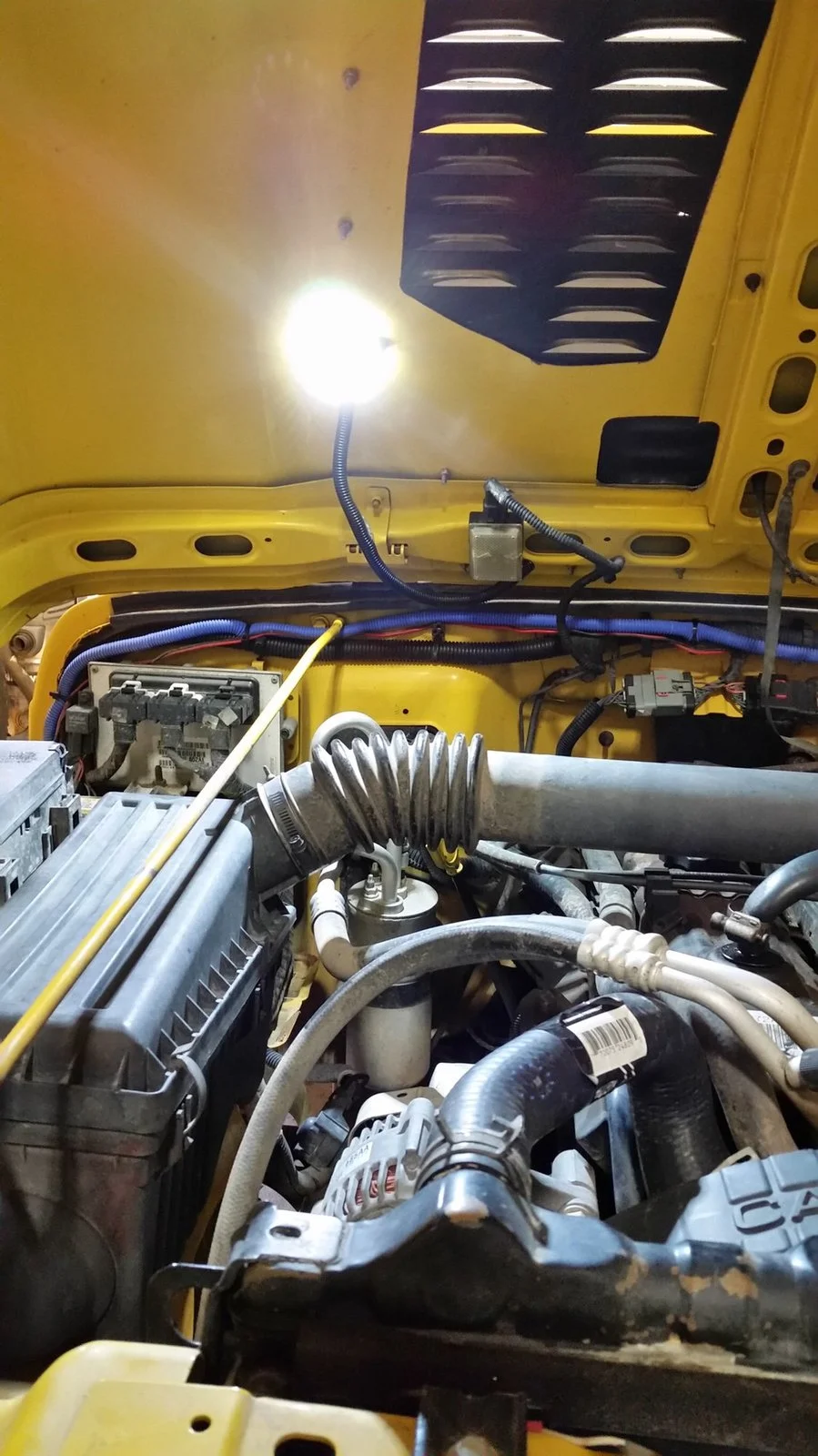

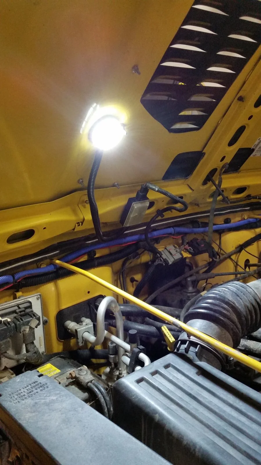

Just tap into the factory light housing where the bulb goes. That’s what I did when I added a KC Cyclone as a good light.
The lens is now painted black so it looks better.

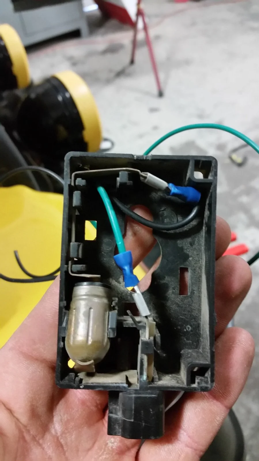

No need to punch a hole. I didn’t. There’s a small hole in the corner from the factory. I ran the wires through there. I wanted to use the factory light housing that way it retained the gravity switch.
Like I said. With the lens painted black it looks much cleaner.
