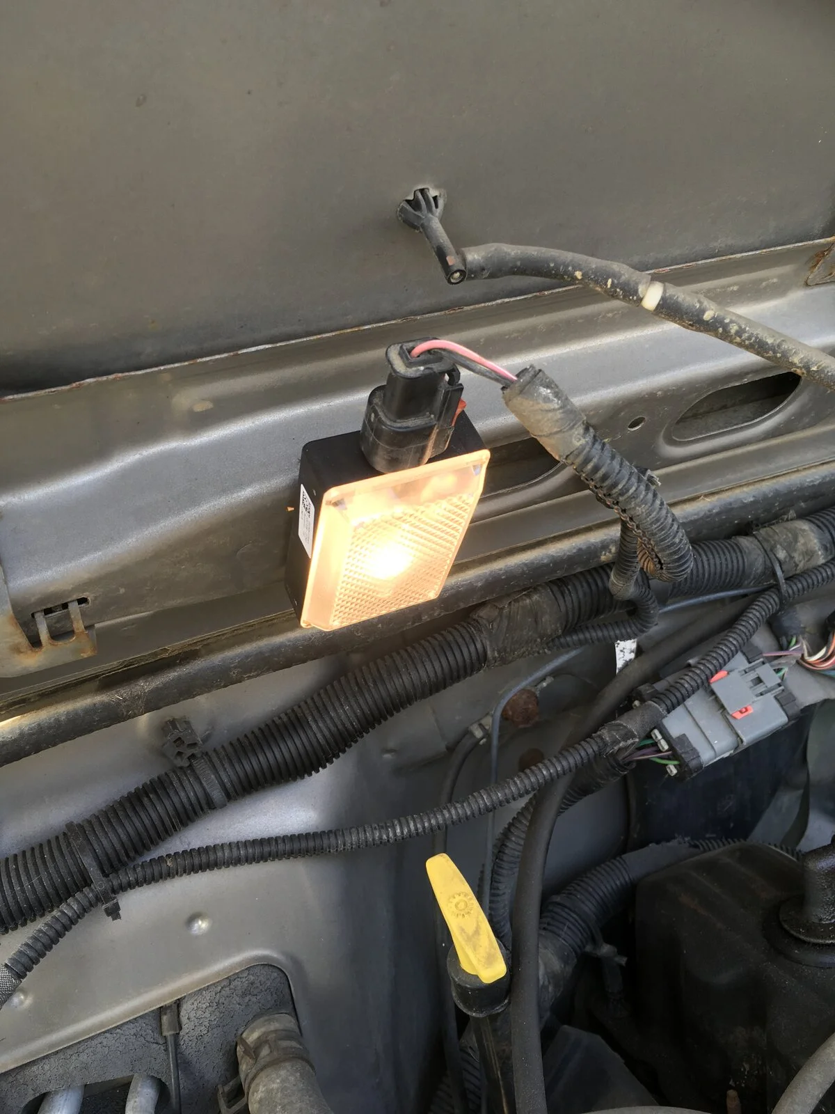

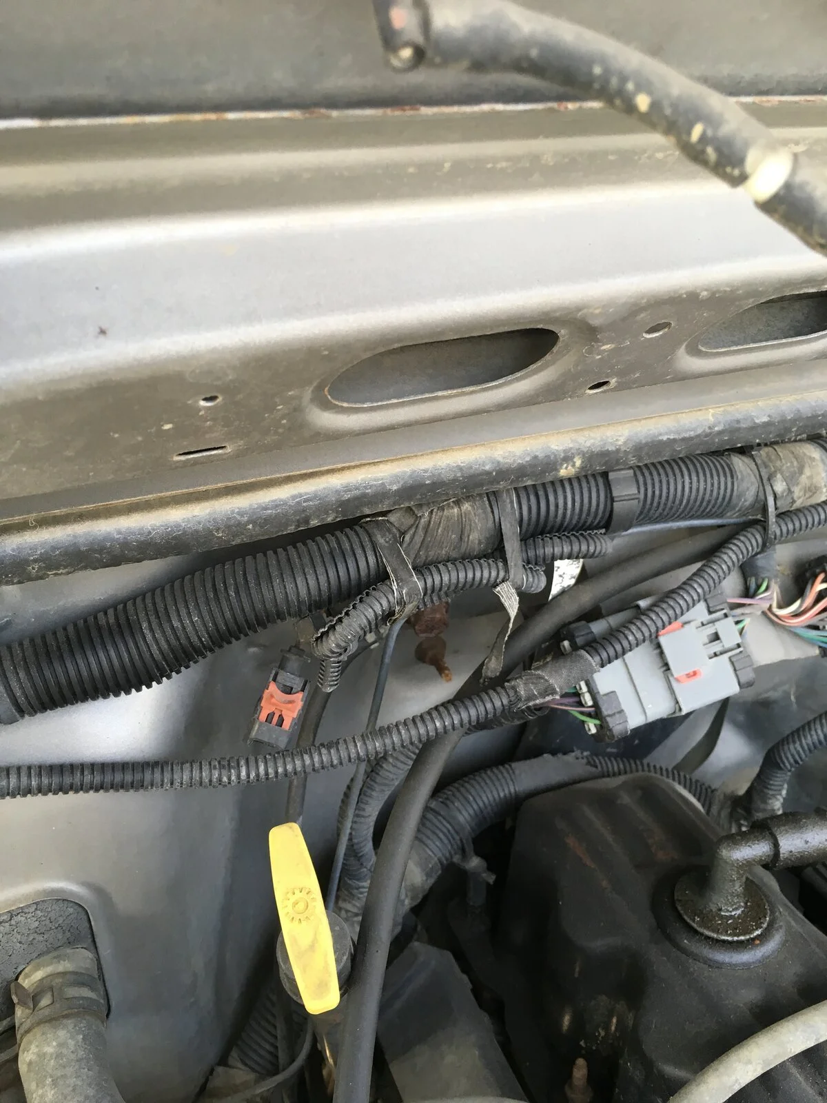

I ordered a Mopar underhood light for about $20 and it came in the mail today. My Jeep didn’t come with one but it does has the connector. One of the few unused connectors on a 2002. At that time, Jeep had many differen’t wiring harnesses depending on what options you ordered.
Install was EASY! One screw (#10 x 3/4”) and I plugged it in. Just a little tricky figuring out how it went on. The mounting tab bends back so the light sits on top of it. You almost have to install it backwards at first.
