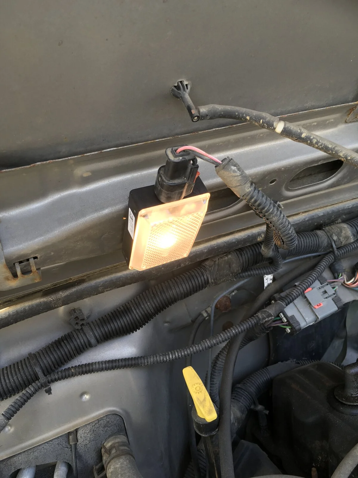

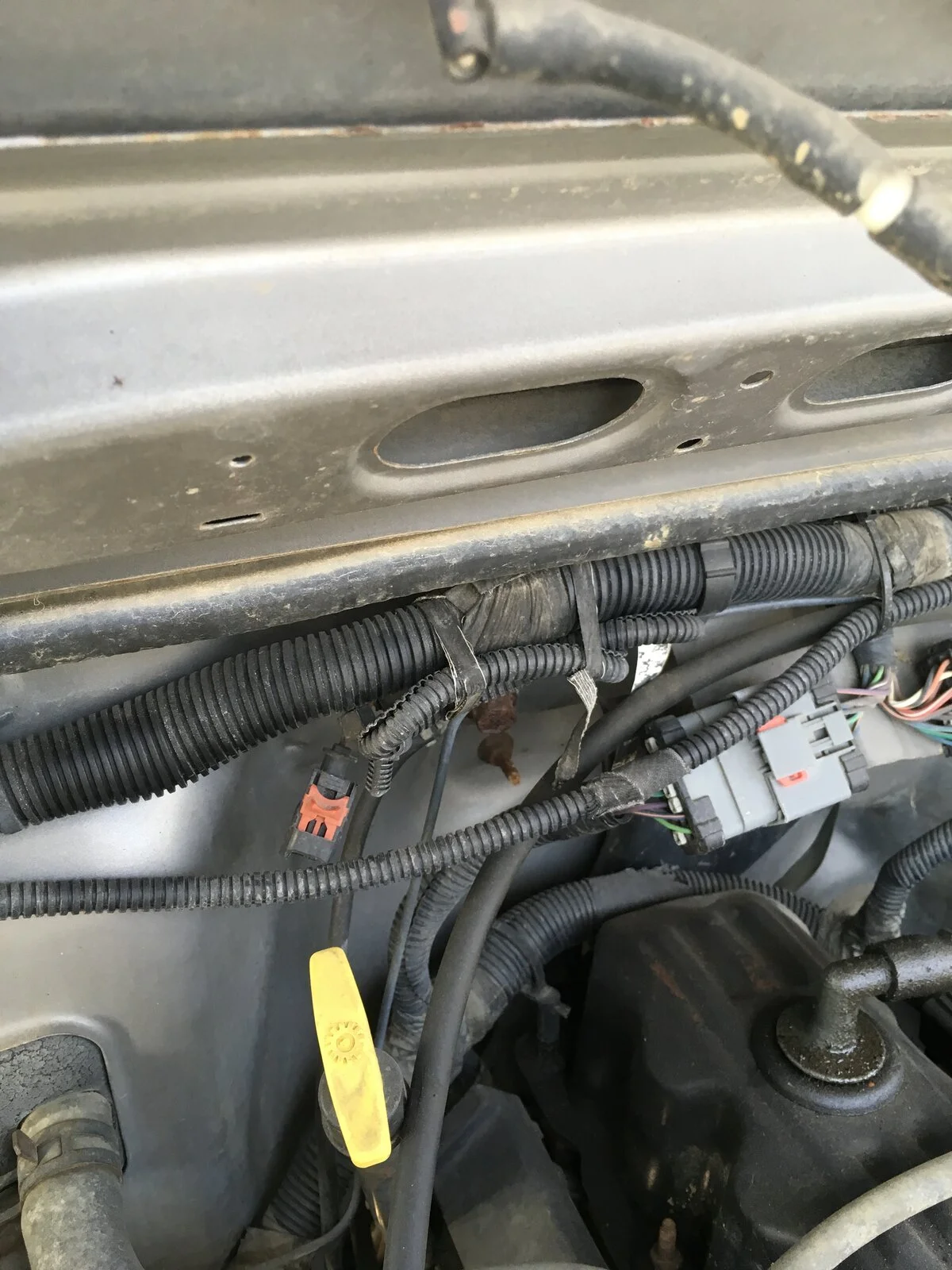

I ordered a Mopar underhood light for about $20 and it came in the mail today. My Jeep didn’t come with one but it does has the connector. One of the few unused connectors on a 2002. At that time, Jeep had many differen’t wiring harnesses depending on what options you ordered.
Install was EASY! One screw (#10 x 3/4”) and I plugged it in. Just a little tricky figuring out how it went on. The mounting tab bends back so the light sits on top of it. You almost have to install it backwards at first.

Since you brought this up, I've been trying to figure out where the sensor is that turns the light on off (other than the aforementioned accelerator trigger). The light goes off with the hood about 80% closed, but I can't see anything that makes it happen, unless it's the photoelectric effect.
I didn’t look very closely but it felt like there was some type of a hinged or swinging contact switch that I could feel moving around.
