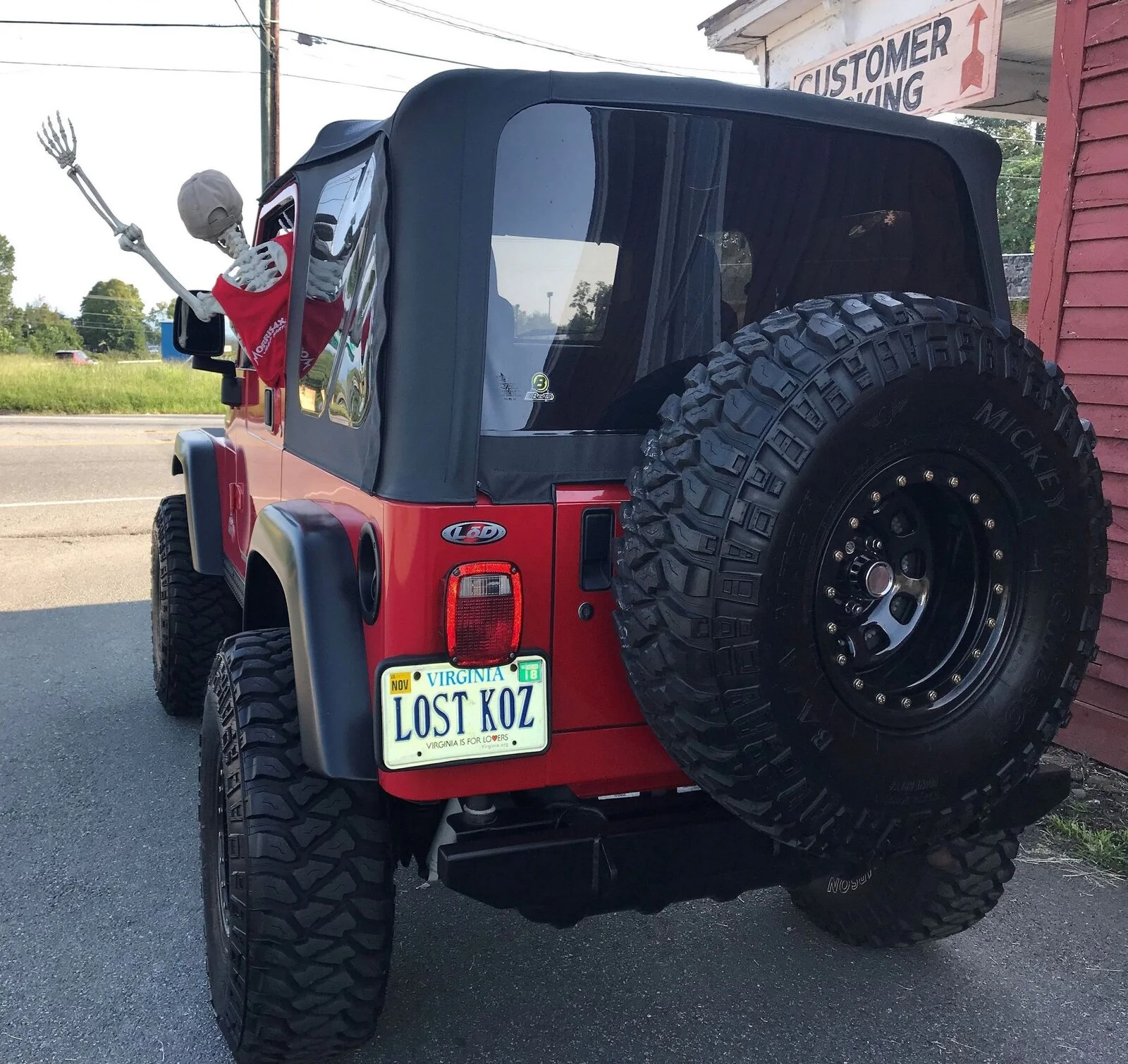

Start lifting weights.💪 My spare weighs over 100 lbs and I'm skeleton-like. ;) .
My 35s are about 93lbs assembled and I weigh 170 and haven't set foot in a gym in close to a decade, and this technique gets it on without much struggle.
