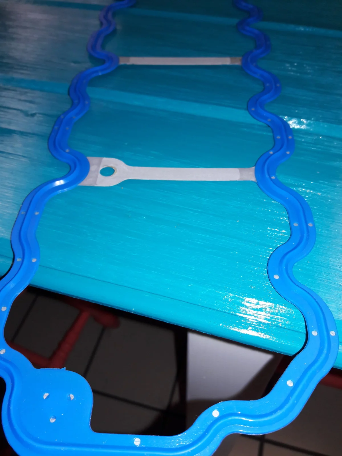

Going to tackle the valve cover gasket tomorrow. I bought this Fel-Pro gasket and noticed it has a raised lip on both sides. Do I use gasket material on this kind or no?

To the OP: I, as well, used no sealant at all, but made sure the mating surfaces were spotless.
yea I cleaned everything really good and its been 2 days. I have not seen any leaks any where to include the RMS so I'm thinking the gasket was my problem. As for that stupid piece of plastic that holds the wires at the back of the valve cover, yea thats not going back on ever lol
