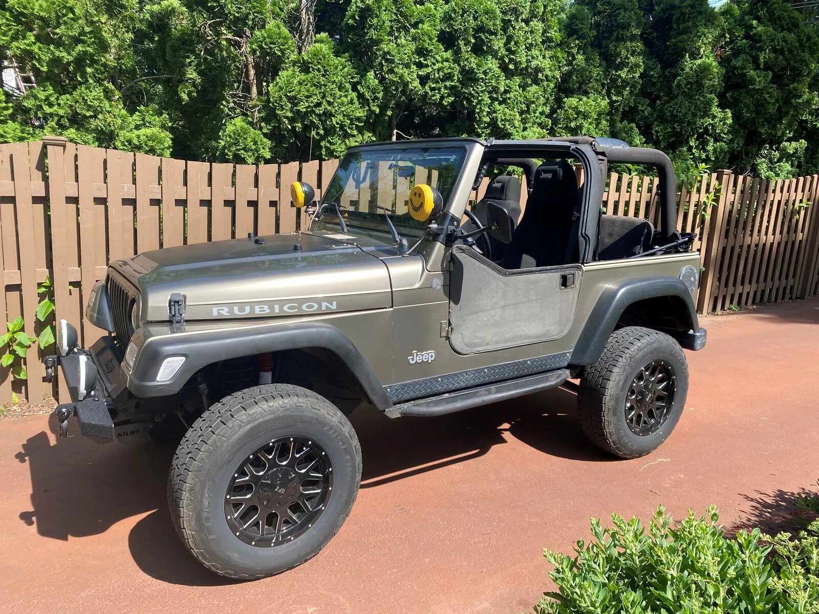

Again, thanks in advance for reading and any thoughts or advice you can offer! As a reward to those who made it this far, a pic for your efforts:
