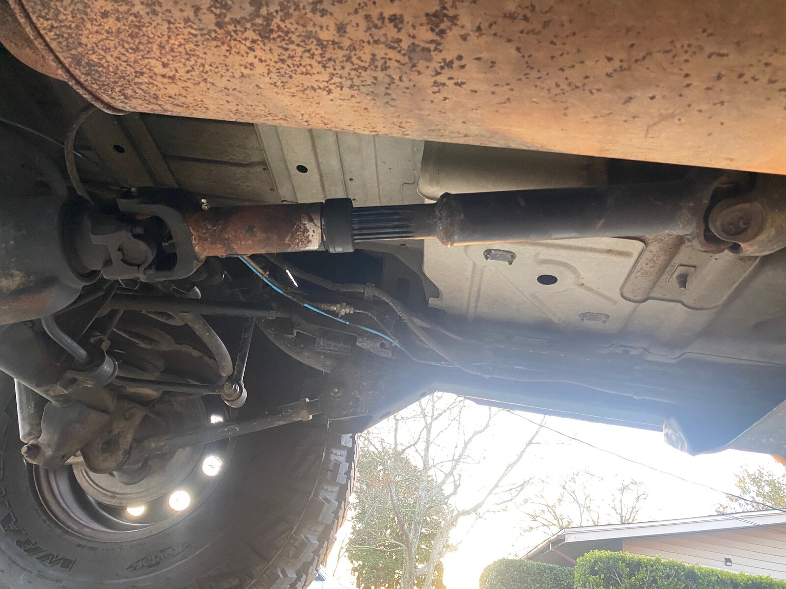

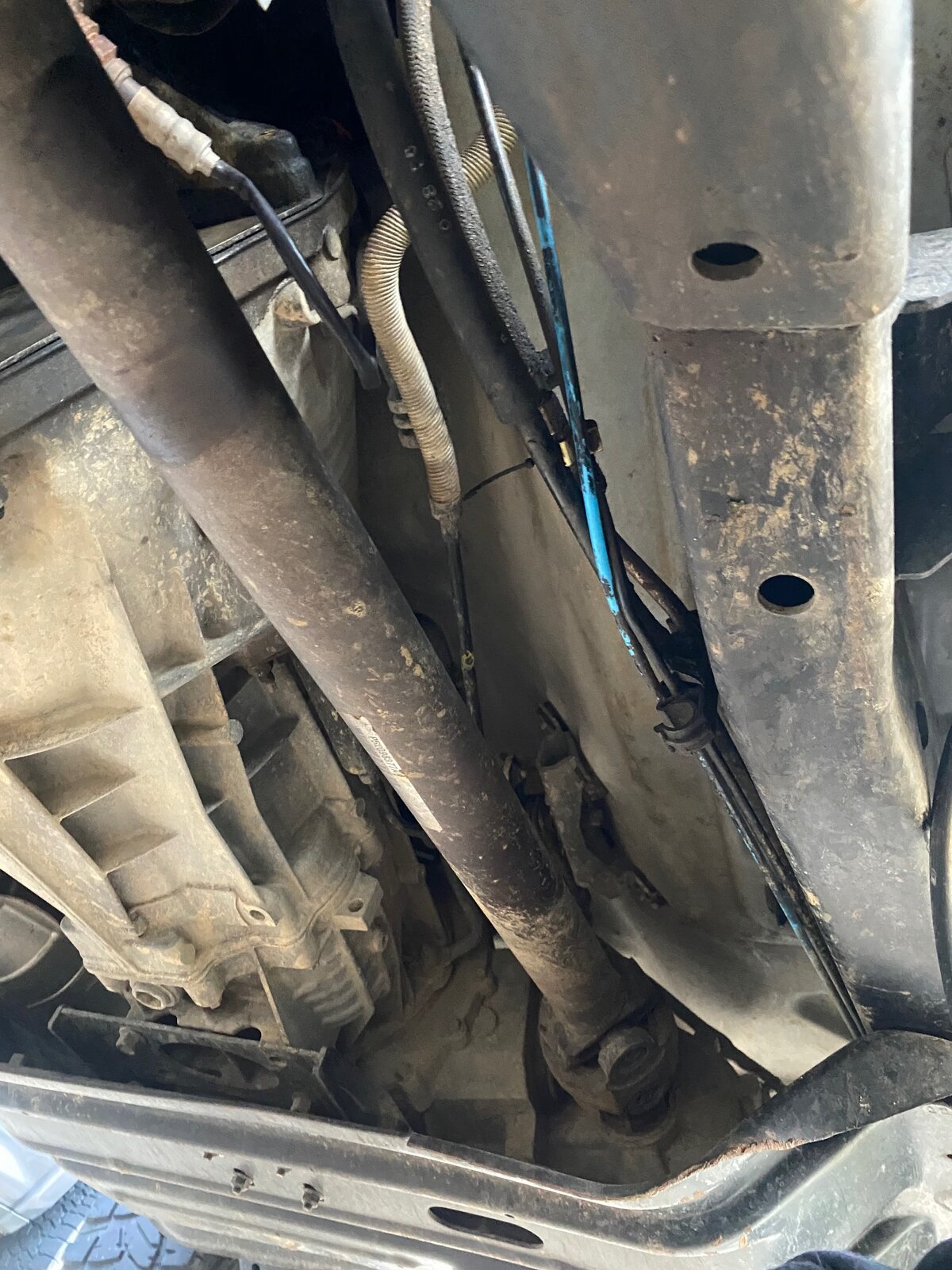

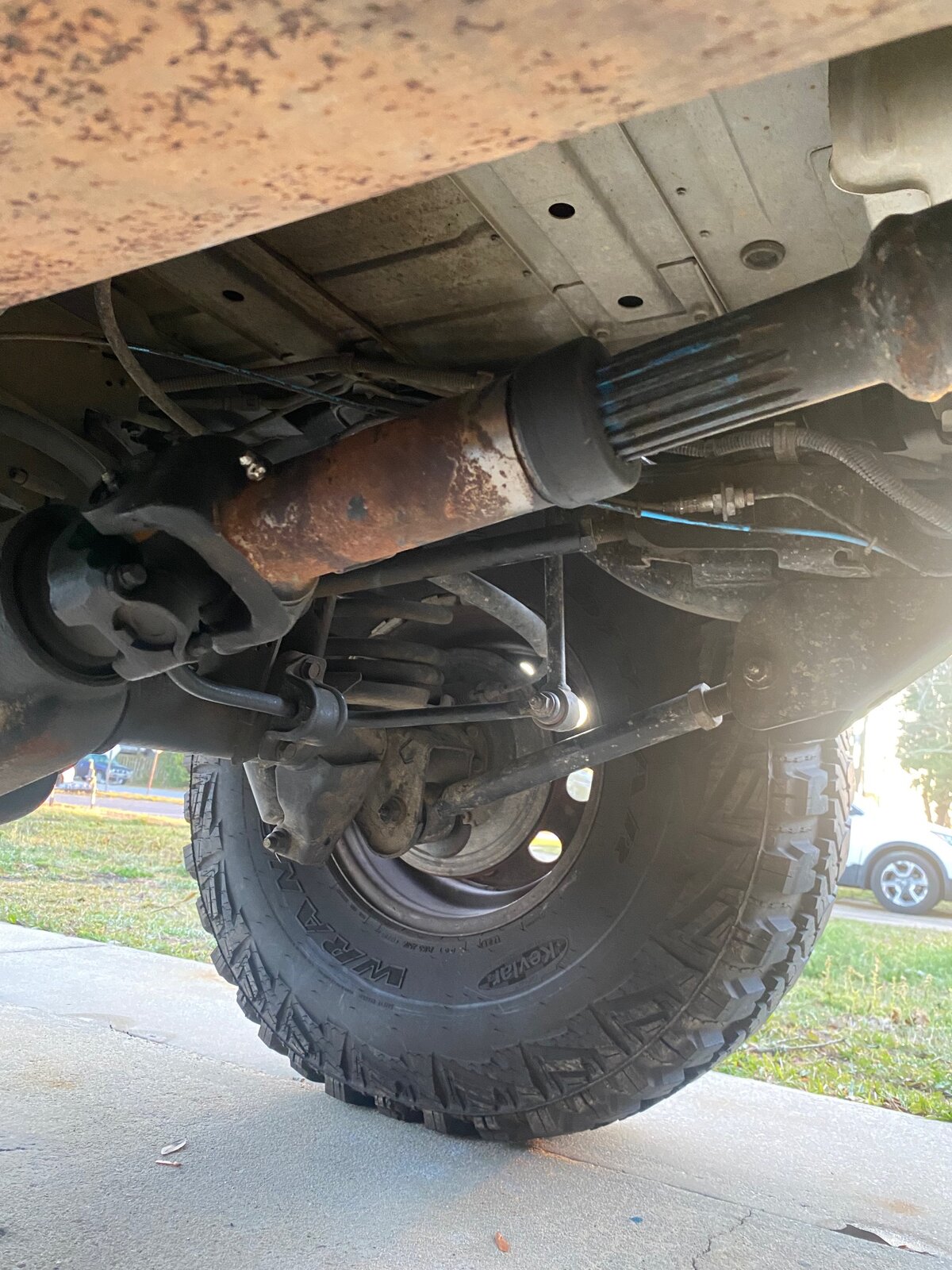

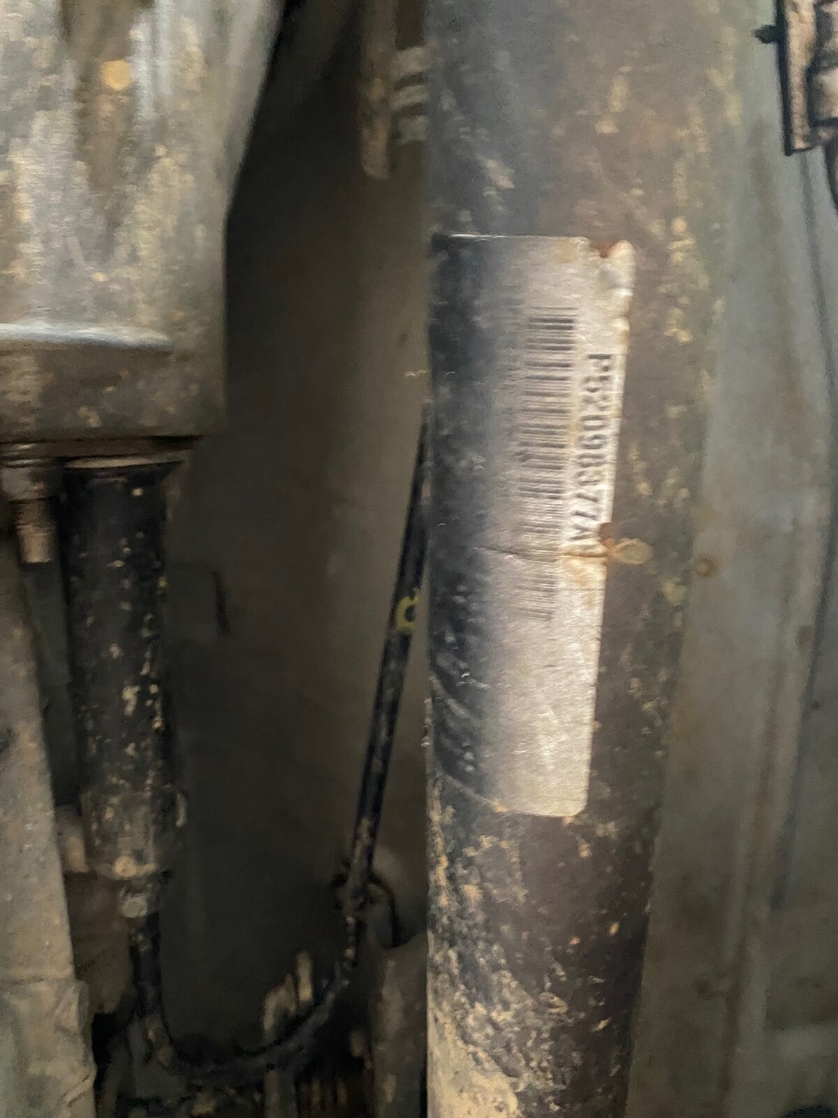

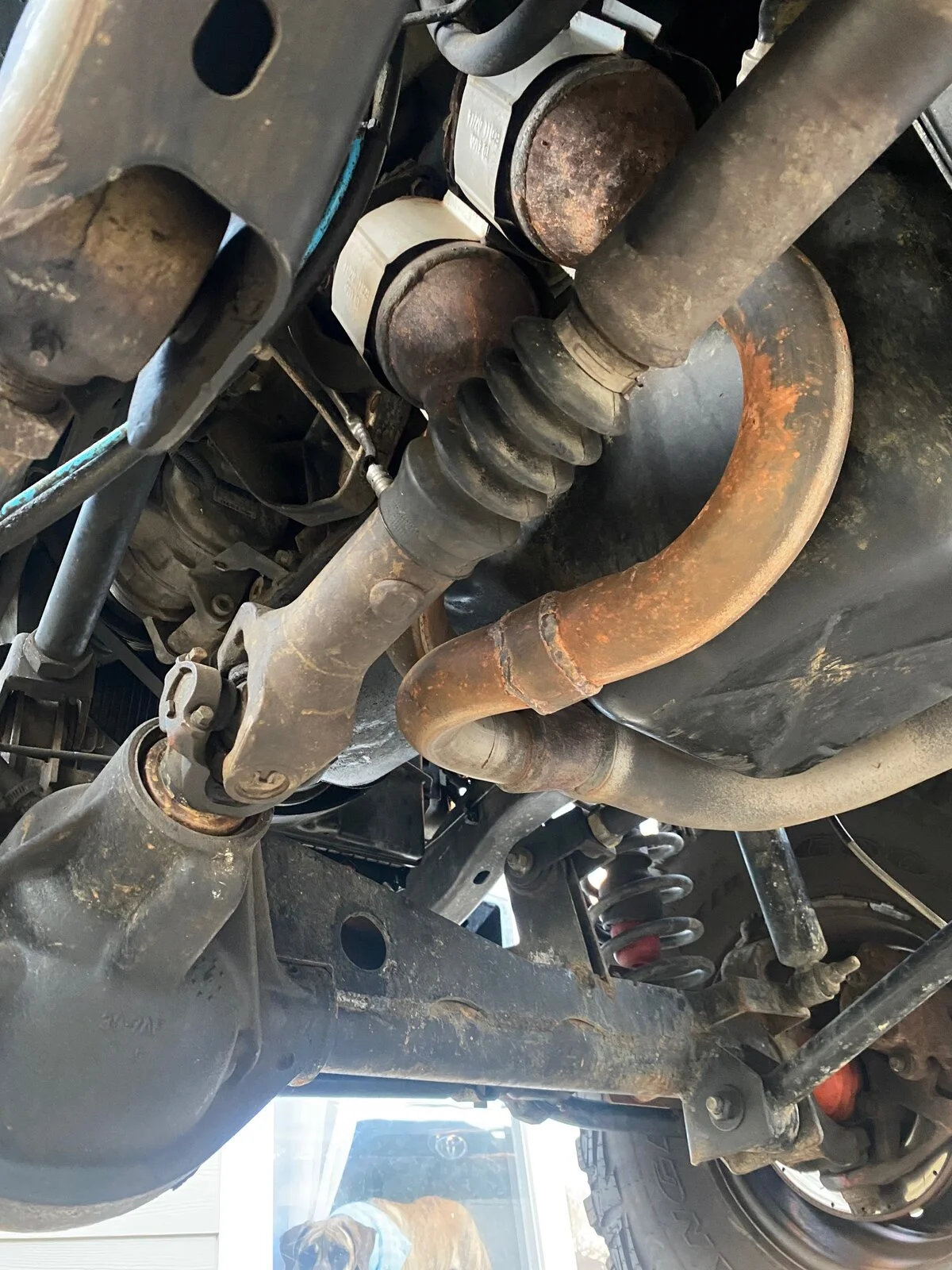

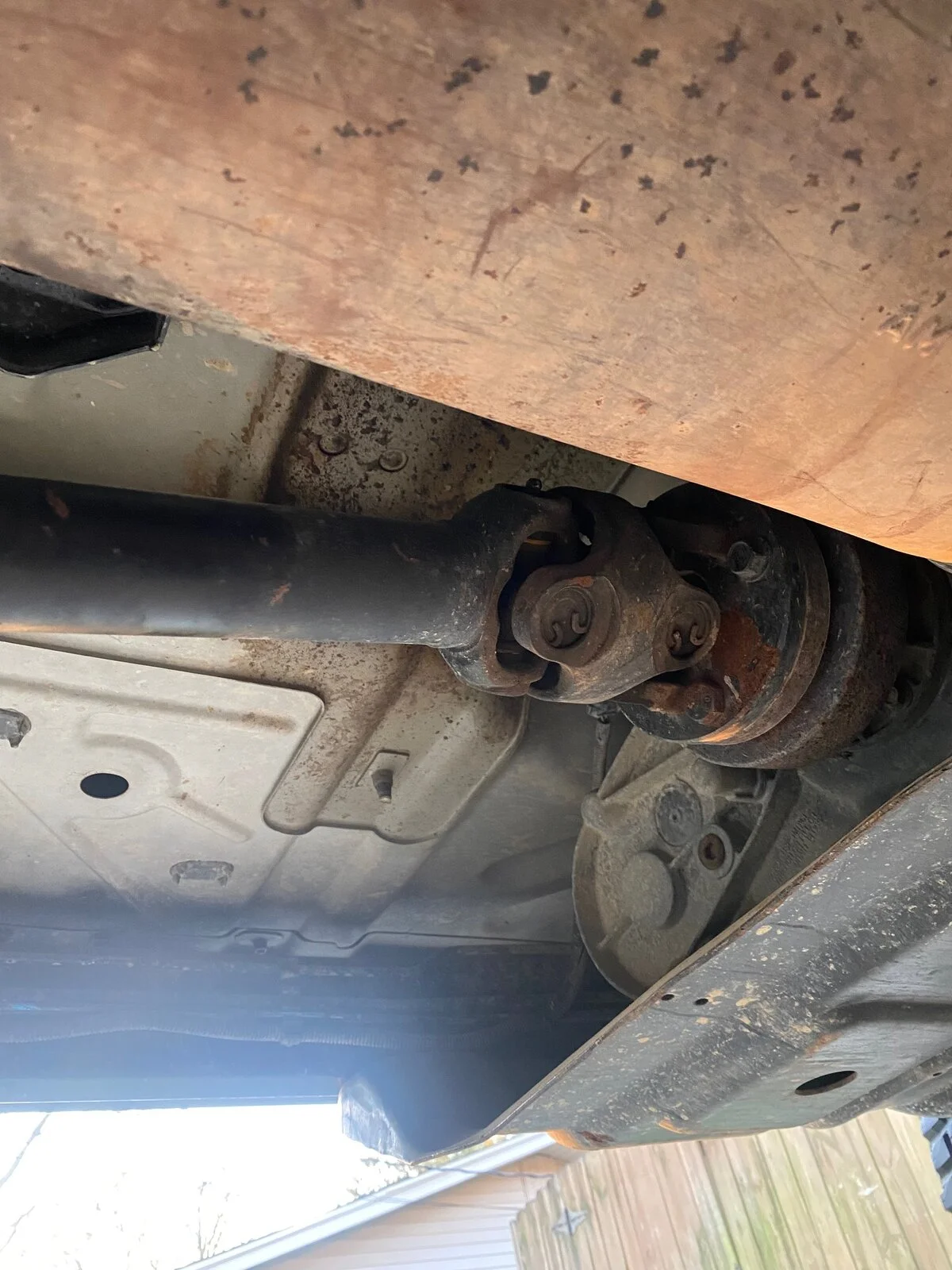

Bought an 06 LJ back in December and started having some vibration issues recently. Had the front driver side ball joints and tie rod replaced since they were shot, along with wheels balanced and alligned. Thinking its more of a drive train issue since the vibration is worse on acceleration and pulls to the left (almost like a torque steer, but at any level of throttle). Later today I'll pull each drive shaft individually and see if one or the other could be the culprit. But I was going to just replace the U Joints while they're out but I'm not 100% as to what manufacturer the shafts are to be able to get the correct size u joints. Based on the pictures, I'm guessing at least the rear is a tom wood due to the blue splines. Also, while trying to shake the drive shaft by hand, there is an audible clunk but it feels like it could be coming from the actual spline connection in the middle of the shaft and not the actual U joint. I haven't yet re grease the joint, but is that even a possiblity and would that help remedy the issue or would it need replaced?
Thanks all for any input.
Pictures are as follows:
1: Front DS
2: Front of front DS
3: Rear of front DS
4: Front of front DS
5: Rear of front DS
6: Label on front DS
