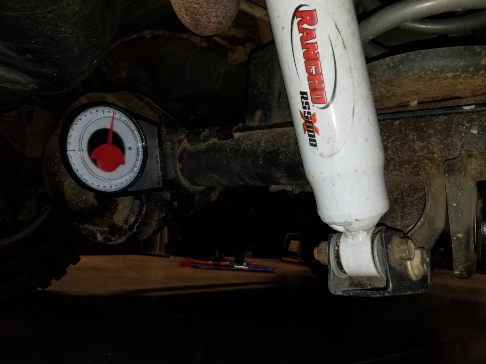

Hi-jacking thread, didn't see a point to add another vibration/pinion/etc. thread.
First: 4.5" lift, removed TC drop (1/2"), DC DS& SYE. Upper/Lower adjustable control arms.
Had to adjust all my rear control arms, the knucklehead (auto shop) I paid to set them had everyone at a different length.
LCA: 16.5"+/- maybe 1-3/16" difference, but both at equal lengths.
UCA: I forget, but I had to move them out about 1.5" Maybe 14.5ish. Both at equal length after adjusting pinion angle.
With UCA removed: I set jack under the diff/yoke and jacked up until my diff/driveshaft looked to be as in-line as possible.
Angle on DS: 16/17 degrees.
Angle on the bottom of Diff(Dumb spot): 20/21
—-I've seen Jerry post about this spot, hopefully, he knows what I'm talking about.

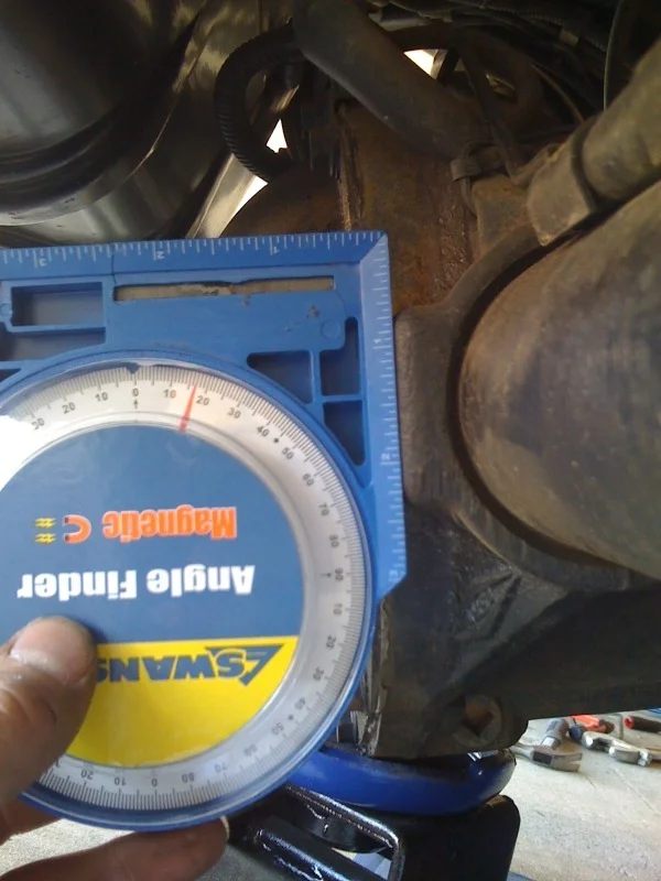

Angle using the flat spot on back side of Dana 35: 14
Adjusted rear track bar after driving in a few small circles/jumping on back etc.
Found a bad u-joint on the DC joint, so I know that's on the fix it list.
Still vibrating, comes in and out. Does not feel like tires, it is under acceleration/load only.
Main concern as of now: How do those angles look etc. I don't think I can narrow down all the issues until I replace the u-joint or driveshaft. I will probably replace with a complete DS as most of the parts the PO installed came from rough country, I'm assuming that's where the DS came from.
No rush, I did a few other little things and I'm about to drive home and get a good 25-mile highway report.

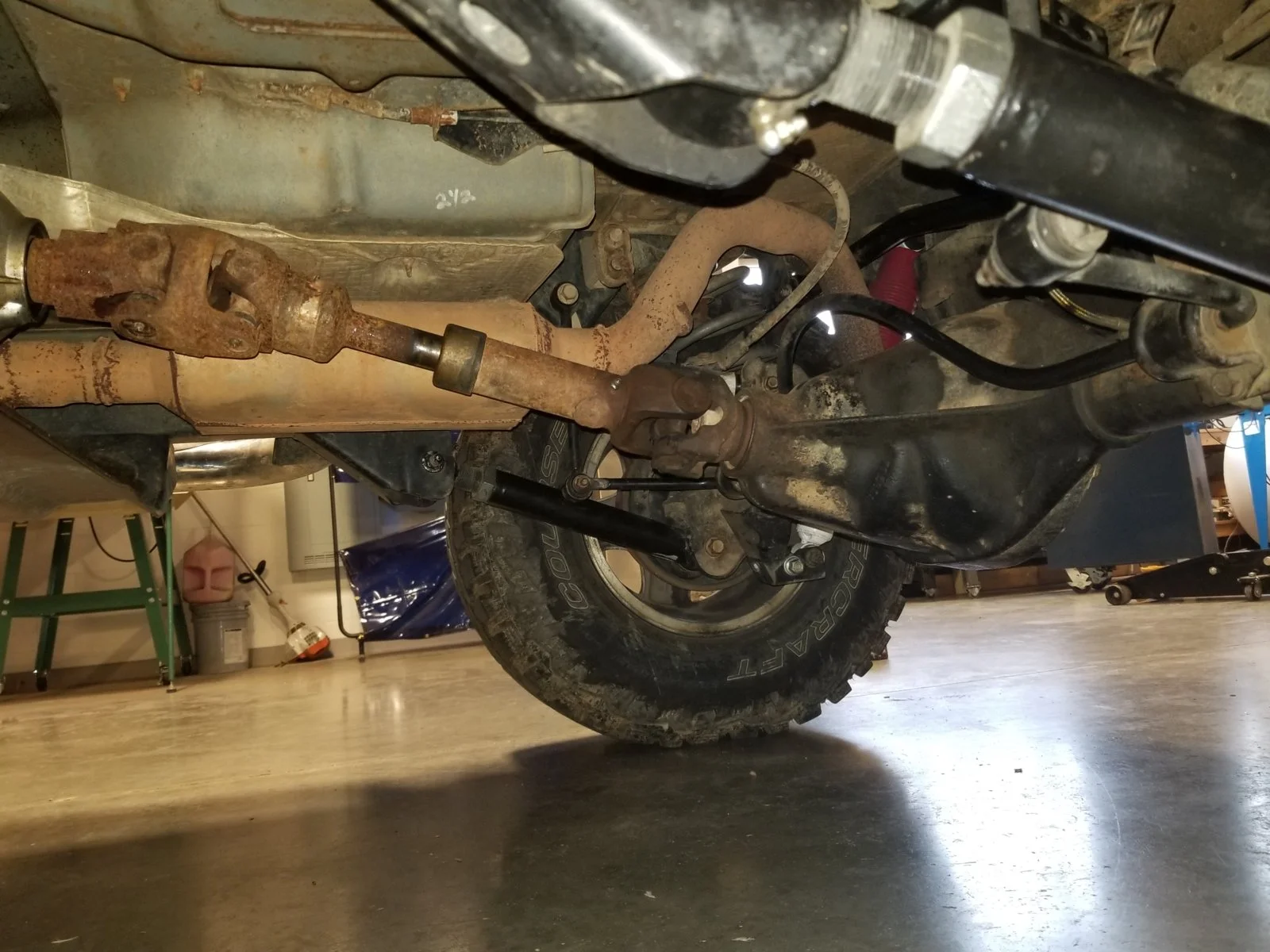

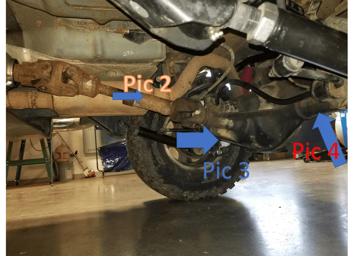

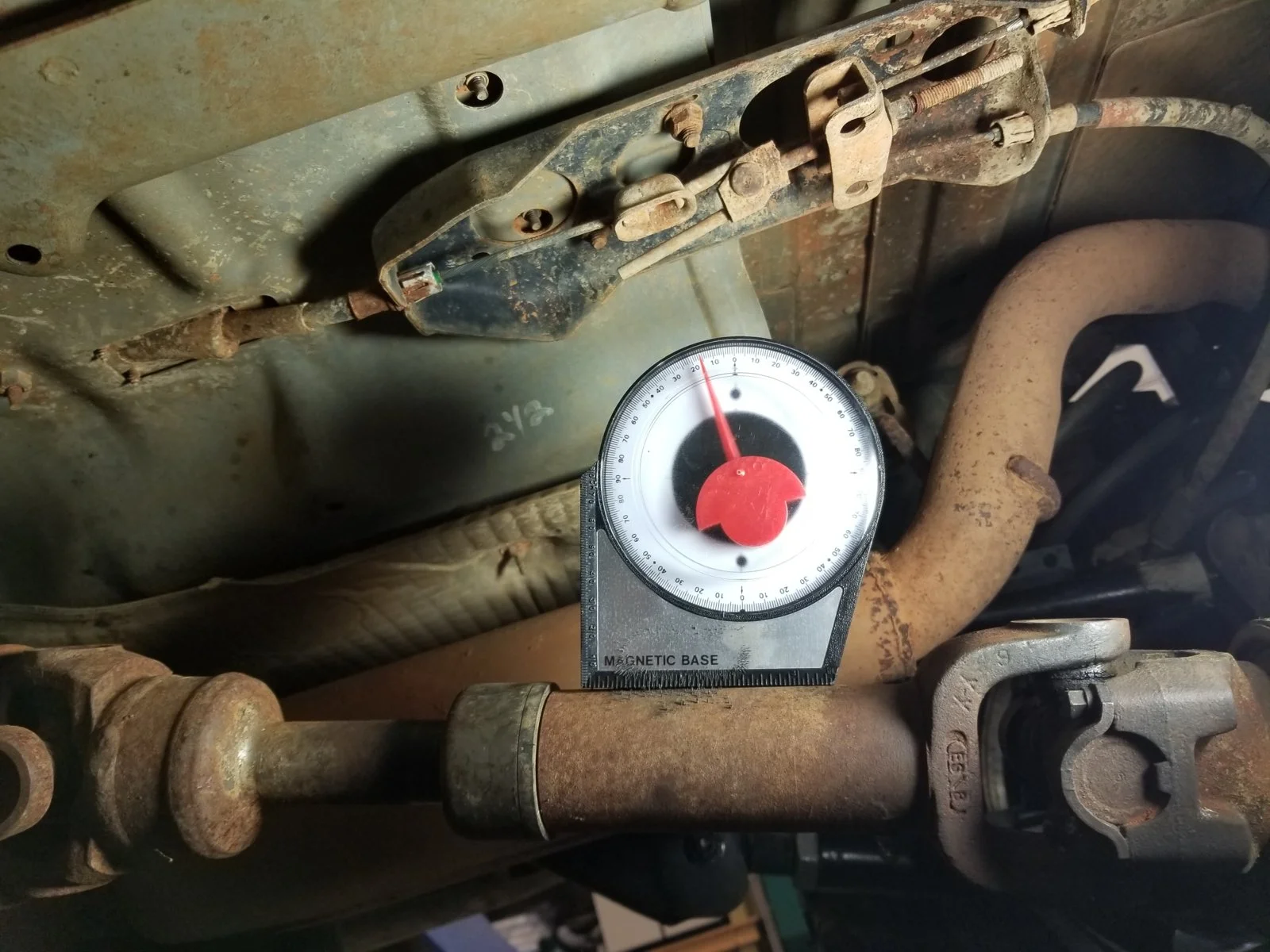

Pic 1: DS

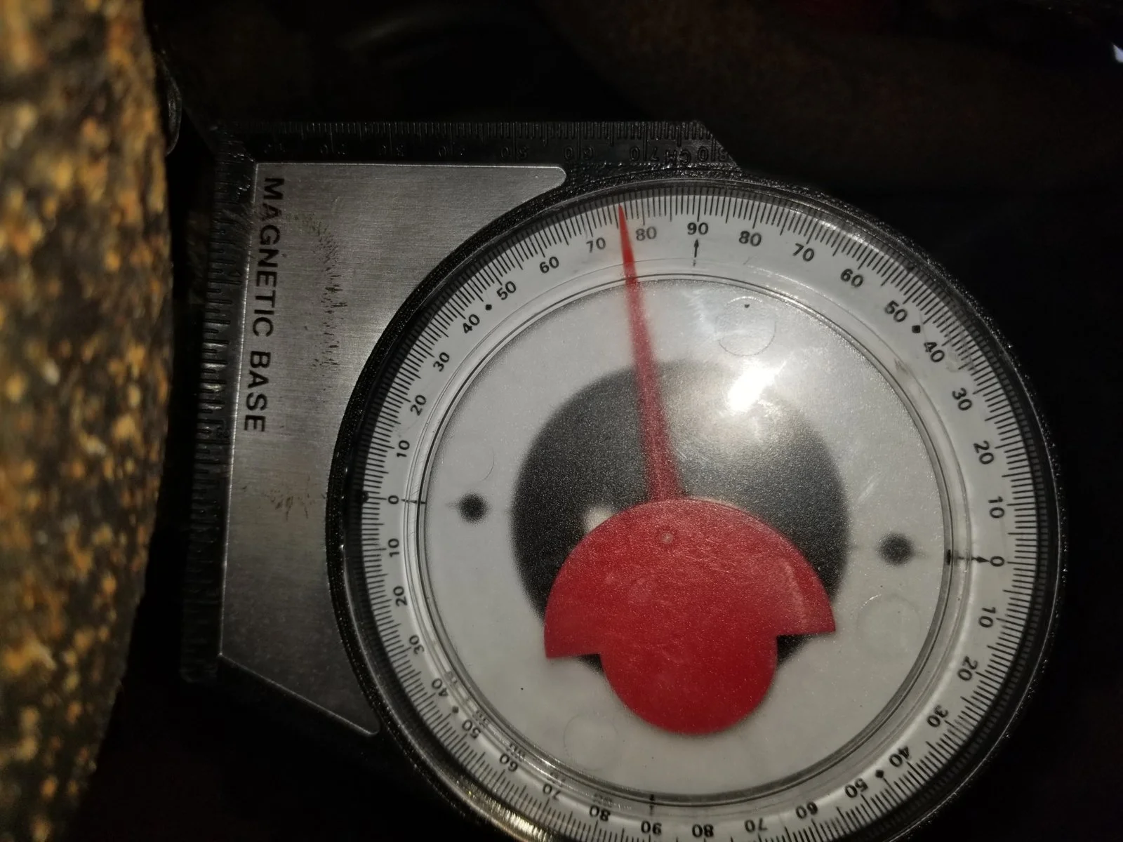

Pic 2: Angle on top of DS

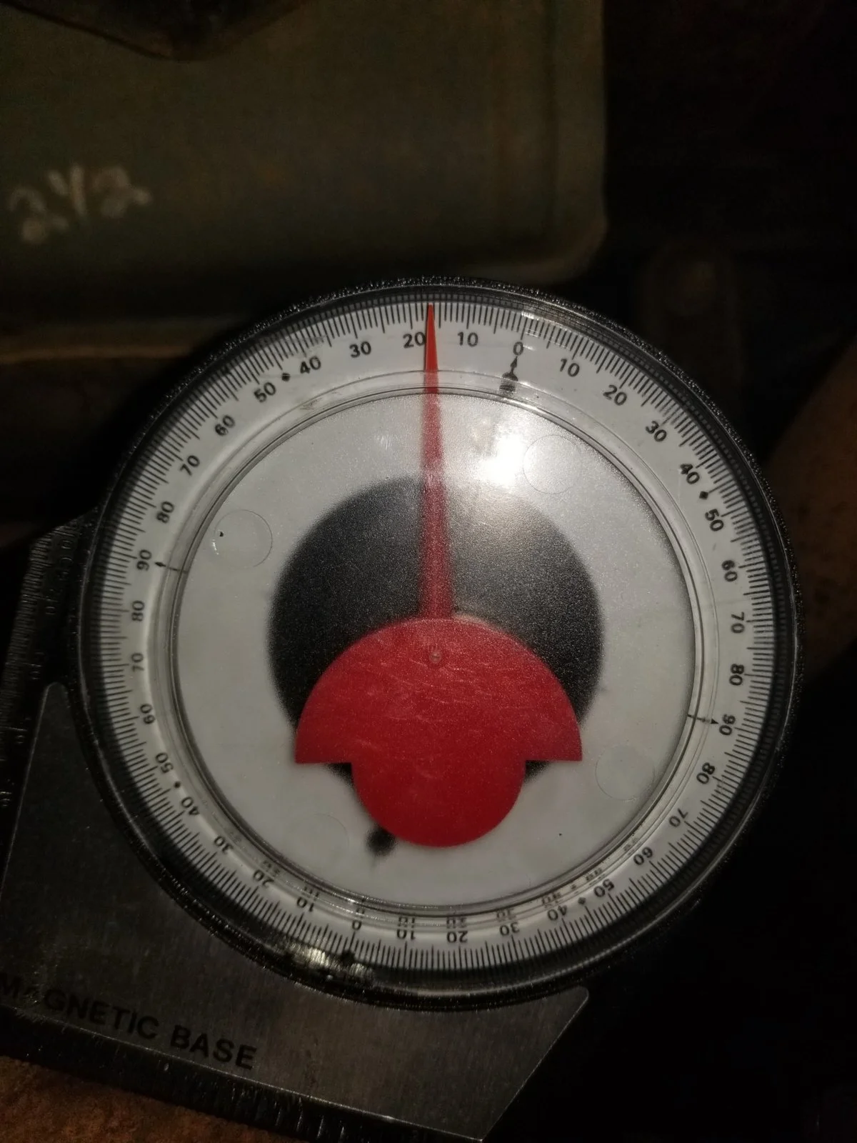

Pic 3: Bottom of the flat spot on Diff
Pic 4: Back of Dana 35

I can't tell what those angles are supposed to be of, they're too close to see what's being measured. What's the angle on the driveshaft itself?

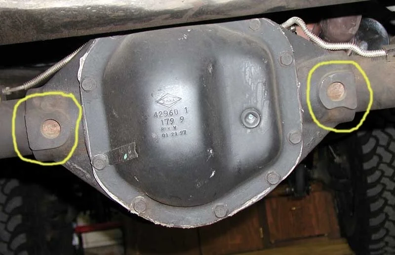

Here's how to get a direct pinion angle from the back of the axle via either of the two flat machined surfaces on either side of the diff cover. Those two flat surfaces circled in yellow are exactly 90 degrees away from the pinion angle. Rotating the angle finder as shown below will show the exact pinion angle.
The last picture I put up was where I measured, I'll get better ones, but I did use that spot you are showing.
Pic 1: DS

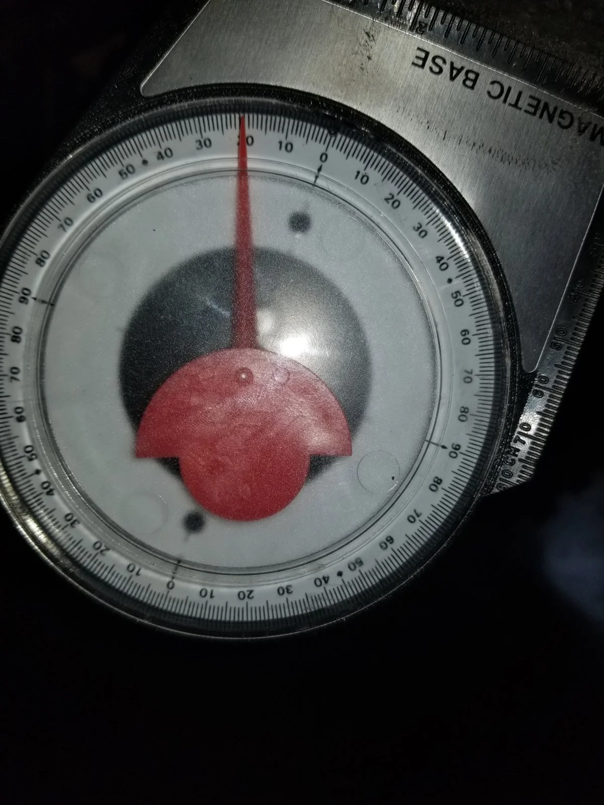

Pic 2: Angle on top of DS: 16/17 degrees
Pic 4: Back of Dana 35: 14 degrees. That's the spot you show.

Did a little tweaking today, still getting a bad vibration starting at 25mph.
Driveshaft: 17*
Pinion: 16*
Should I put the 1/2" TC drop back on? Would the bad U-joint really case this much vibration?
