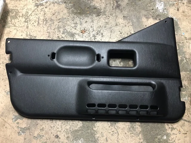

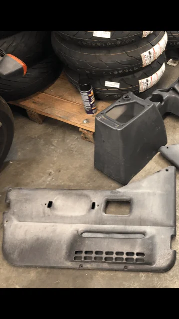

So the interior of my TJ was a dark grey at one time.... now it’s faded to white almost in some spots. Bought the ColorBond Adhesive Promoter and paint and it’s like new! Soooo impressed with this stuff and it was sooo easy to do! Cost me $60 for 3 cans of paint and my interior is going to look like new. Crazy.

I actually had to order another can of both, it didn't quite do the whole interior. What I did was clean the surface with TSP that you can get at Home Depot or Lowes, it's for cleaning walls before you paint them, in the paint isle. Then I sprayed the adhesion promoter on and let dry until it's not tacky, maybe 10-15 minutes. I applied a second coat of the adhesion promoter and let dry another 10-15 minutes or until it's not tacky anymore. Then I applied a light coat of the black paint. If you are used to spray painting stuff with normal spray paint this is a little different. When you apply a light coat it doesn't look like the paint is even going on at first.....just wait. After a few minutes it's like it adheres to the vinyl or plastic and all of a sudden it's pretty black. Strange how it works but it does. Do not put a heavy coat on, it can run just like regular spray paint. After about 15-20 minutes of dry time I applied a second coat. Some spots needed a third, the ones that were really white from fading but two coats almost did the whole thing. Really amazing stuff. Can't wait to install it and let my kids in so they can rough it up. Lol I will post my finding after awhile.
Damn! That looks brand new. I’m curious to see how it holds up. Be sure to update this thread as time passes.
Very, very impressed!
