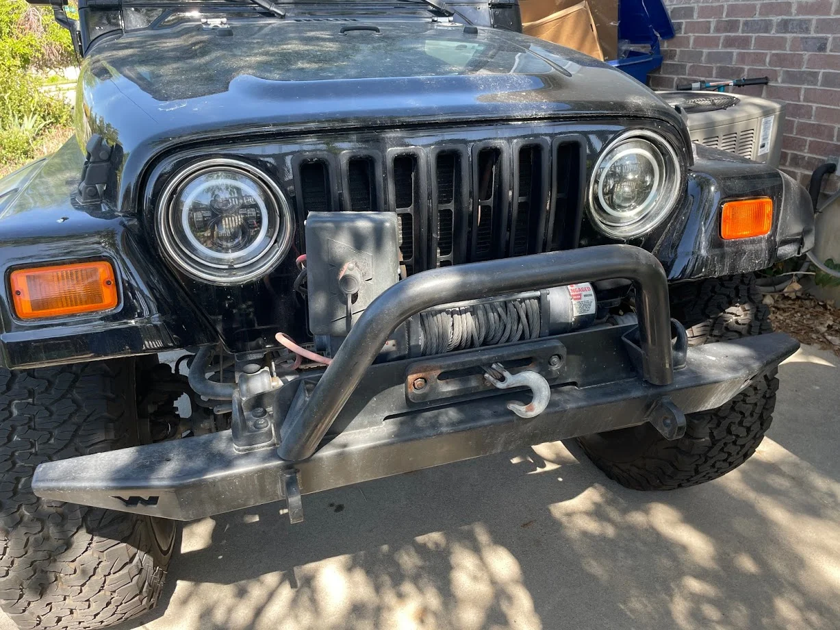

Purchased this 2000 Jeep TJ and it came with a WARN winch M6000 actual model number unknown. Seems to not have been used for a long time. Want to swtich the Steel Cable to Synthentic and get the WARN winch restorted/rebuilt to working order.
My question is it cost effective to do this or should I just purchase a new winch?

Really depends on what it looks like inside if it is worth the cost of repair. Just have to tear it apart and find out. Depending on the serial number on that M6 you might be able change the motor and make into an xd9000.

I will look into the xd9000 possible upgrade. I am going to be working with a local shop in the next few weeks to get into it and see what can be done. Based on the few searches and forums that I read it seems like WARN winch is worth restoring/rebuilding. Just curious if anyone had any experience with the process. Possible cost savings.
I just got done with one. The motor might be an expensive swap. But less than a new winch. M8000 might be a better fit.

There are three components that make up the majority of the cost for a rebuild. The motor $200-300, the control assembly up to $310 and the brake $140. From there it is typically gaskets, bushings and grease.

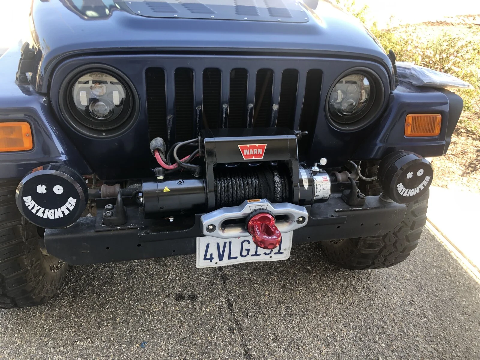

I tore apart an x8000i I got for $250 that looked gross with seized cable but cleaned it up and bought a new motor for $150 on amazon.
Costed nearly the same as a new winch in the end but was a fun project and has lasted me the last 3 years.
I also did the same thing to a 8274 but it needed the brake discs and some other parts. They are pretty simple in design, usually just a planetary gear set that attaches to the motor and spool with some sort of brake mechanism.
If you have the time and are curious go for it, just make sure you lookup parts first as some have less support and cost more if you need to replace parts, but often they are fine. I like the ones you pack with grease and this looks like one of them. Usually means less chance of drying out and seizing.
The solenoid box looks like it has seen better days though.
