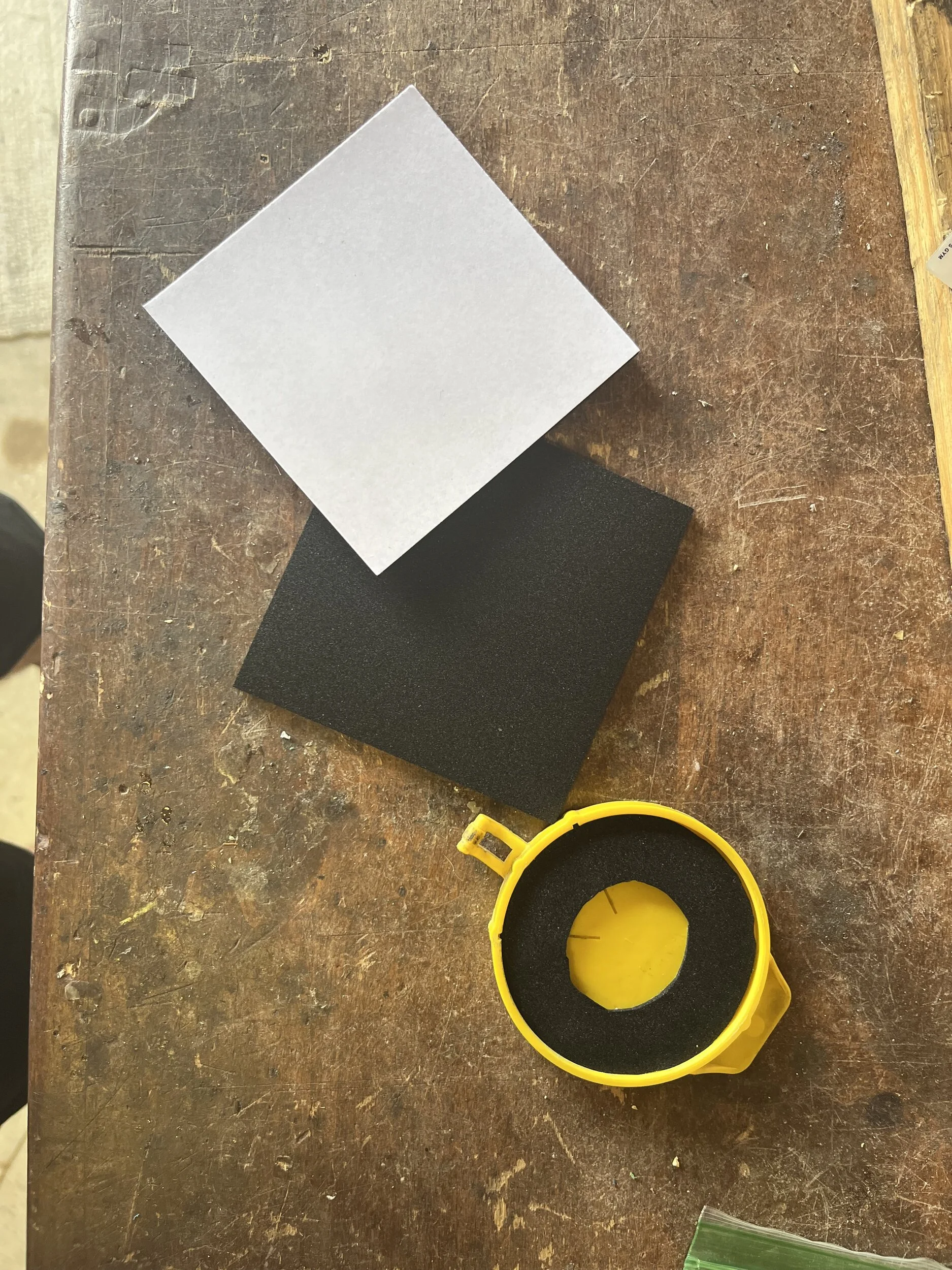

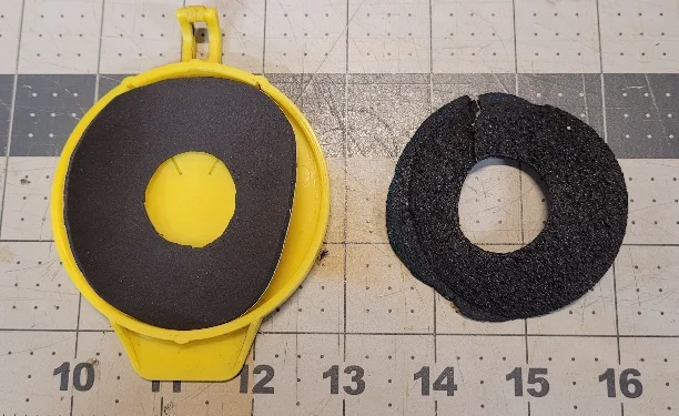

I took some time today to take a closer look at the original reservoir cap and its grotty seal. The seal was spongy and held fluid, so I figured why not just replace it with the sticky-backed neoprene I have on hand.
Once I got the seal out of the cap, I cleaned all the old adhesive and gunk off the cap and noticed something I never saw while it was on the bottle. There are two recessed channels molded in the underside of the cap, leading from the outer edge of the cap to the cap's center.
Those channels would keep a vacuum from forming in the reservoir when pumping fluid out into the washers. Then I realized the original seal's form actually had a function. It's open center allows those channels to do their thing.
So out with the old and in with the replacement. This was the test fit. Once installed the cap clicked shut like normal. I'll just see how it goes.

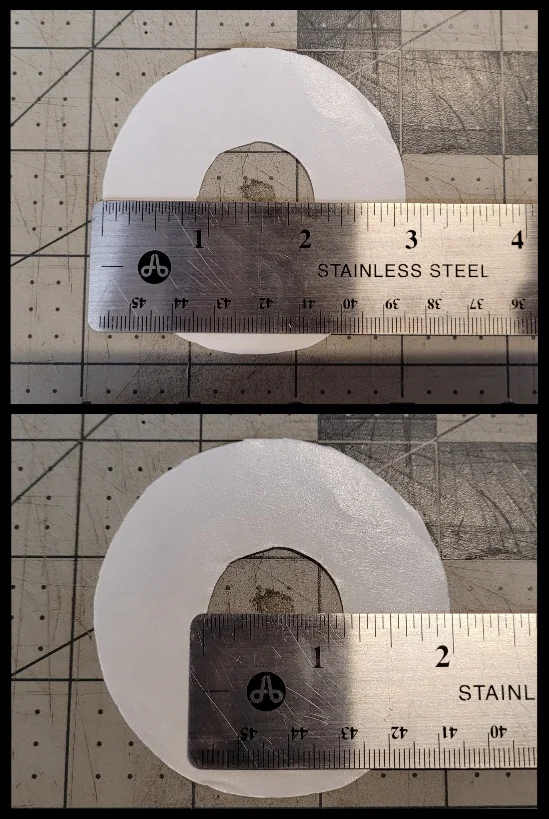

Measurements below if you want to try making your own. I just used an old school compass for this.
