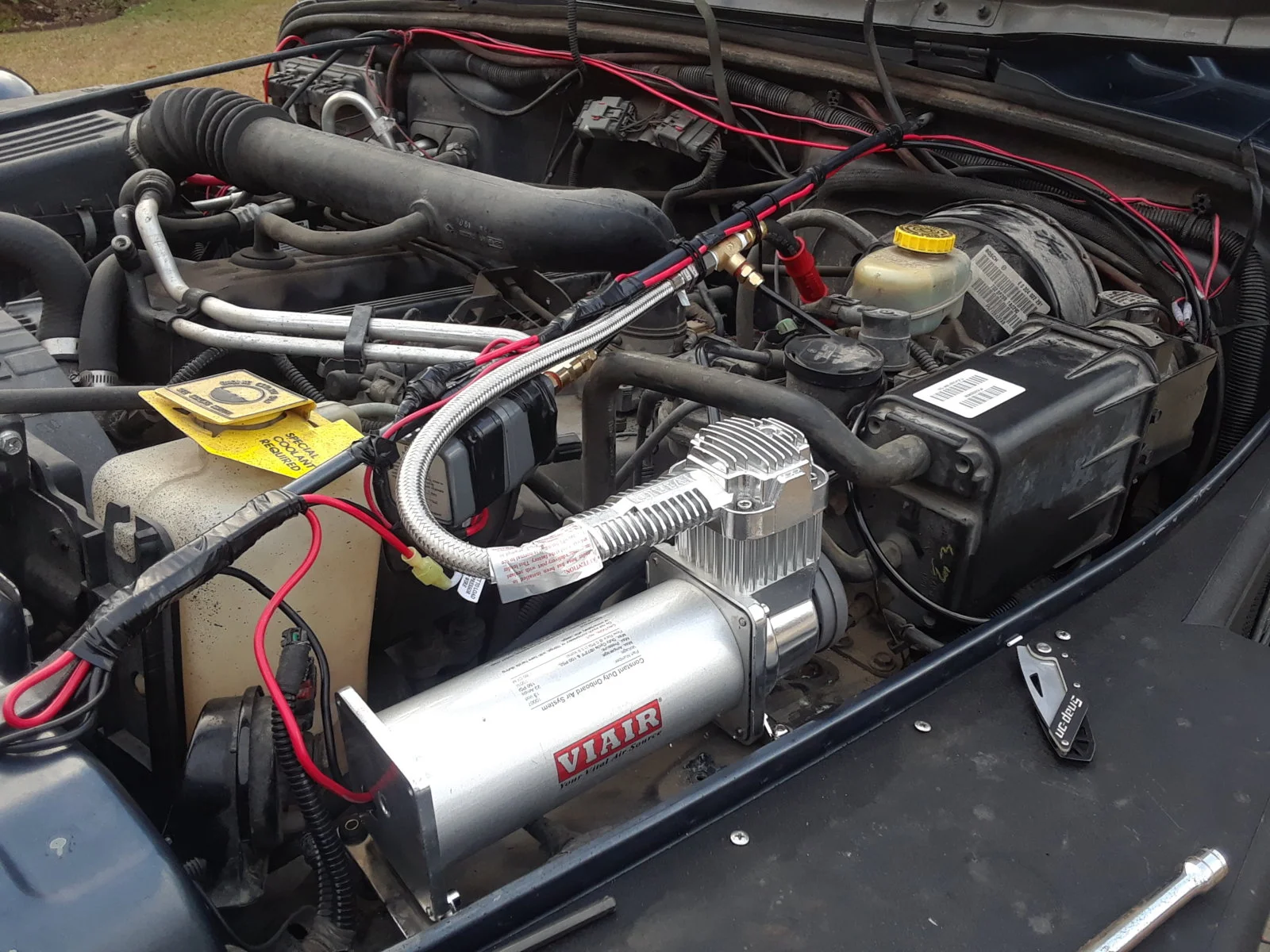

Has anyone relocated their fluid reservoir for the windshield washer fluid? If so where did you put it? I Installed an air pump in that location and I reckon I need a way to clean my windshield without having to pull over or whatever. Or just tap into my radiator and use that. Hot fluid would probably clean better anyway.
All the wires and pressure switch are mounted now, that was just to get it going to make sure everything worked.

I had to get rid of my washer bottle to install the external power steering fluid reservoir. The only thing I could think of that would fit would be one of the older vinyl washer bottle bags like used to come on older cars. I stopped by my local classic Mustang parts store and sure enough they had exactly what I needed. Amazingly the TJ's electrical plug for the washer pump the Mustang store sold me was a direct fit for the Ford washer pump, no wiring mod needed. No doubt you can find what you want on Amazon or Summit Racing.
This is like what i used, I just zip-tied it to the radiator support rod where it worked perfectly.
