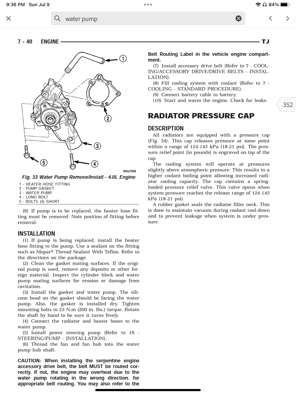

I ordered a Mopar pump, and there were 2 numbers from different companies. I am wondering if they sent me the right pump, looking at the impeller on back, the flow doesn't sit right in our thinking for the direction the fan goes, we might be backwards in thinking too. I know Jeep is a reverse flow and this Mopar one doesn't have an R stamped on it. Not sure if anyone by chance has a 2005 4.0 water pump around to shoot a picture of the direction of impeller.
Yes!! Thank you. That is the one they ended up sending. I imagine you have a 4.0?
Did you use the gasket that came with it?
Yes it's a 4.0. Also used the gasket, it should have silicone bead on it which faces the water pump. When you torque it, do it in a star pattern. I put the bolts in a piece of cardboard to make sure they went back in the same hole. Also wire brush cleaned them. Make sure you spend the time to get the old gasket off, you want the surface completely free of it.
